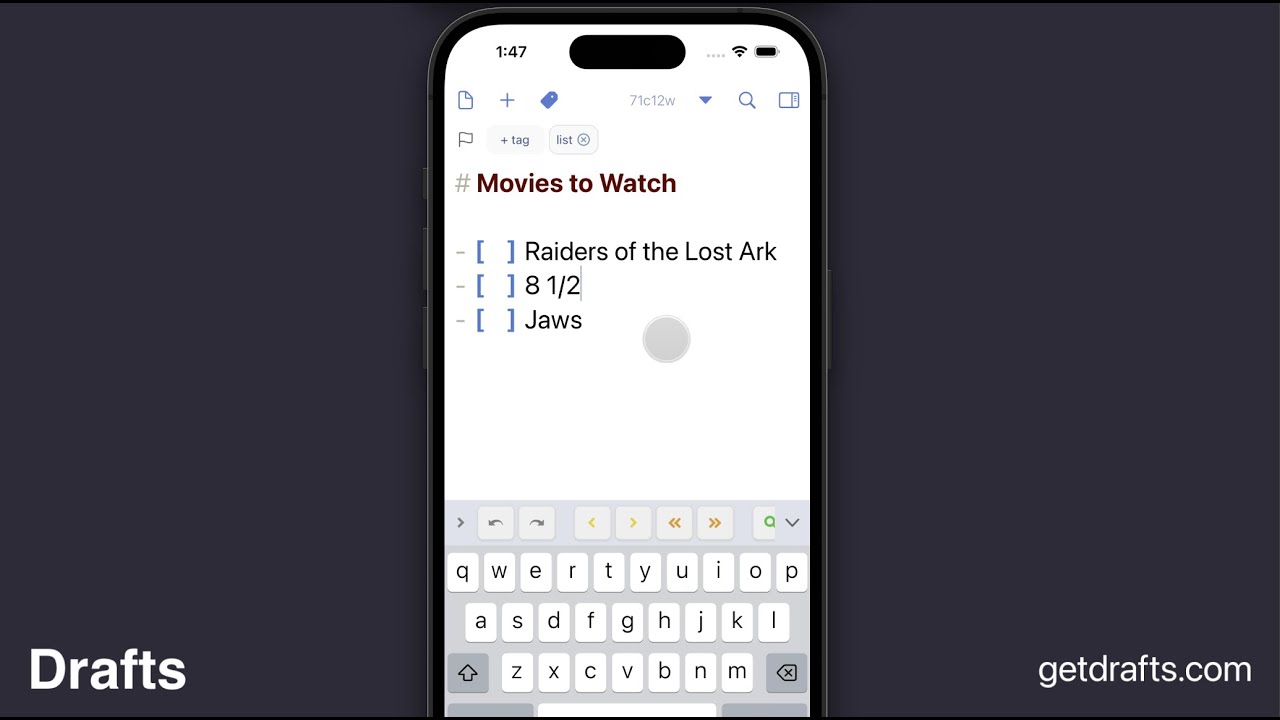

  • Create a new draft, and type something brief in just the first line of the draft. Let say “Jaws” or the name of some other movie.
  • Run the “Add to List” action.
  • Since this is the first time you have run the action, you will get a prompt asking you to enter the name of a list. Enter “Movies”
  • Hit the “Create New List” button in the prompt.
You should then receive a confirmation banner say “1 item added to list” and you should be looking at a new, empty draft in the editor.
Now do those steps again with a different movie name. The process should be mostly the same, other than the prompt will now also offer the “Movies” list as an existing list to select.
You may be wondering what happened; let’s review what the action did:
  • Looks for any existing drafts with the tag “list”, those are offered as options in the prompt
  • Ask you which list to add to, or if you want to create a new one.
  • If creating a new list, create a new draft with the title you provide, with the tag “list” assigned, in the archive (so your lists won’t clutter up the inbox)…otherwise, select the existing draft based on your selection.
  • Take the lines in your current draft, convert them to list items (adding - [ ] at the beginning). In our example, we only added a single item, but if you put multiple items, each on its own line, they will all be added.
  • Append them to the list draft.
  • Archive the current draft (this is done by the “After Success” settings on the action - you could change this option to trash the draft, if preferred).
