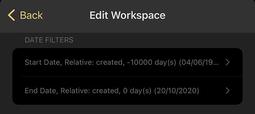

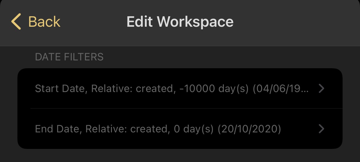

I started by creating a Workspace with some date filters on it to only include things created up to and including today.

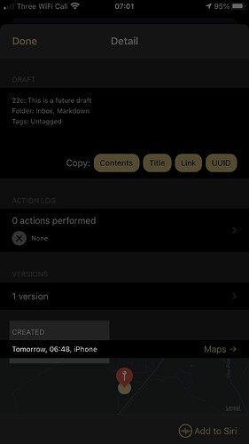

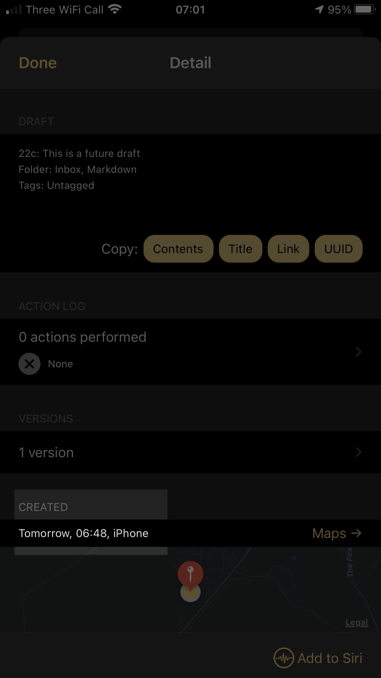

Next I created a quick test action to allow me to set a specific creation date.
Note this is not good practice and you should always have good reason for messing with Drafts’ dates. They used to be read only for good reason.

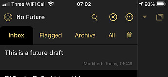

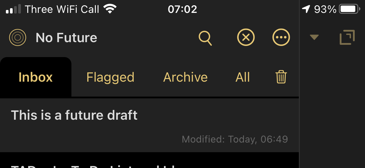

Then I modified a draft to be created tomorrow.
Unfortunately, my date filter didn’t work.
I don’t use date filters in my workspaces currently, so I may have simply set it up incorrectly. Or, it could be an edge case that isn’t covered in the current logic because it isn’t real world possible to have stuff written in the future.
@agiletortoise any pointers?
I don’t love this idea, setting future dates is flirting with trouble, but what you describe is working here in my quick test. Are you sure you re-applied the workspace after you had all the date ranges setup?

I thought I did, but I guess that must have been the issue. Just went back and it was working as envisaged.
