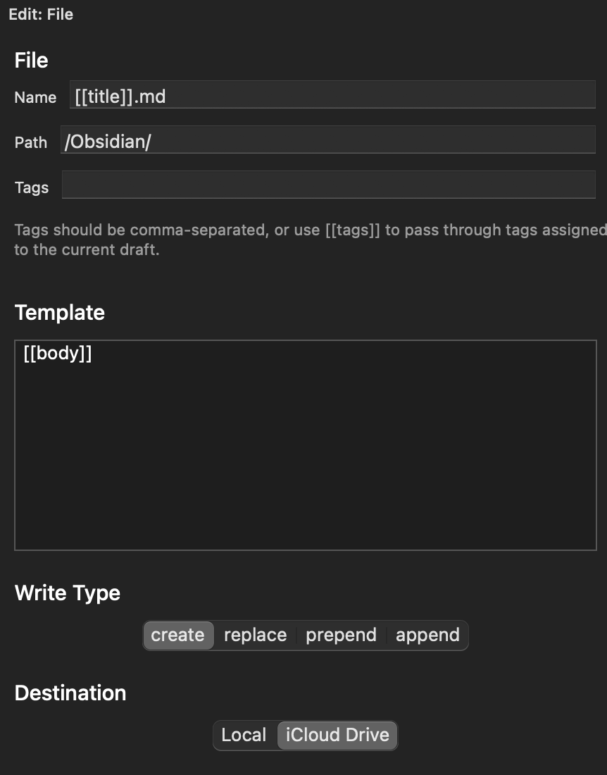

Drafts can only write directly to it’s own container in iCloud Drive (the “Drafts” folder).
You can use an Export action step to be prompted where to save the file, and select your existing Obsidian folder, or you could move your Obsidian folder inside the “Drafts” folder, then be able to configure File actions steps to write into the vault without any further prompting.
With limited testing, it appears you have to write with .md
extensions for Obsidian to recognize the files. An example File step configuration might look something like:
@Fulcanelli does this solve your problem
Perfect! All I needed.
THX very much

Change the template setting from [[body]]
to [[line|3..]]
. This will skip lines 1 and 2, and output line 3 onwards as the file content.
Wow! Thank you so much @sylumer. It worked exactly as I wanted it to. Thanks again!!!
