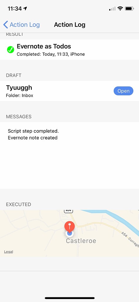

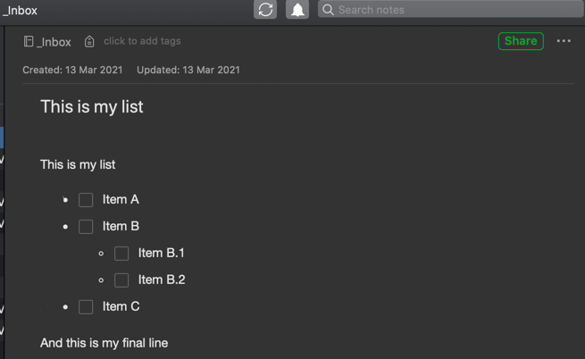

I started with your example content in a draft.
I then used the action referenced in the second of the posts I originally referenced above that is intended to convert MD check boxes to ENML todo entries.
When I did that I got this in Evernote.
This looks exactly how I’d expect and included the indentations.
Could you try it again with your example and check your results are the same as mine?
