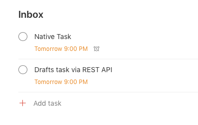

I, like you, noticed that any natural language entry from Drafts, say, “paint door wed 9pm” would go into Todoist with the day/time, but not with an alarm/notification set, signified by the little alarm clock.
As I say, it took me many attempts to get Todoist support to acknowledge the issue. The last update I had (30 Dec) was that the relevant person was off and it would likely be resolved in “January.” I sent an email earlier this week to chase up, but have not heard back (par for the course for Todoist support). So hopefully it will get sorted soon.
At the moment, I just send the task names through to Todoist from Drafts until this is fixed.
This is how the same natural language entry differs via native Todoist and Drafts REST API. Notice the alarm clock is missing on the Drafts entry.
