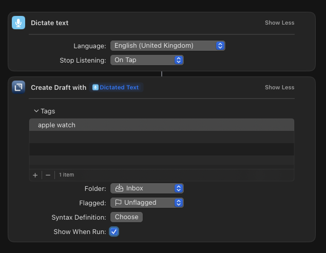

This is great! Thank you. For me, when I run it using the action button on the Ultra 2, after each recording, I am prompted with ‘Allow “Dictate 2 Drafts” to copy to the clipboard?’, then ‘Allow “Dictate 2 Drafts” to share 1 Speech Recognition with “Drafts”?’ Even when I tap “Always Allow” on the second question, I still get both prompts every time. I reset the privacy settings for the shortcut on the iPhone, but that didn’t change anything. Is there a fix for this?
While I’m asking questions, can a step be added to the shortcut that takes it back to the Home Screen after completing the shortcut? I am left on the Shortcuts screen after completion.
Thanks!!!
Did you try doing this?
I’m afraid I haven’t figured a way to get it to return Home. Sorry.
Thank you. I checked the dictation language, and it is already English (US). If I figure it out, I’ll post again.
I had this problem as well. kept me from using it. I think I just solved it. I ran the shortcut ONCE on my iphone and did the Always Allow there for the 2 prompts that showed every time (clipboard and paste dictation text). Now it works on watch without prompting. It seems like the decisions made from watch side aren’t “sticky” but they are on the iphone.

Thanks for this. I found this thread after getting stuck trying to create my own version.
It seems adding the Copy to clipboard action between Dictate text and Create Draft with parts makes it all work :raised_hands:
@agiletortoise I was expecting that simply using the Dictate text and Create Draft with actions would have worked. Do you know why it doesn’t?
I think it’s a Shortcuts bug with values getting passed around when triggered from the Watch. I think you can also workaround it by using a variable step in-between such that the result of the dictate gets set in a variable, then the variable value used to create the draft.
