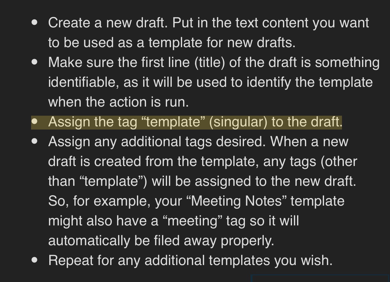

That comes back to my note at the end of my post above as to how that action produces the list. It is looking for a particular tag on a draft, so all you need to do is update the tag list for the draft to include it. You could do that manually with a few taps, or by creating an action to add the tag and update the draft.
I’m confused, when you say tag, are you referring to the tag, “template”, that we have to add to the drafts/notes we want to use as templates?
I’m not sure how that would help with getting content from my current draft/note and populating it into the template?
Drafts can have tags. Not template tags, but actual tags. That is what the list in the action uses to determine what drafts to put in the template list.
I guess I wasn’t very clear. I know about the draft tag, “template”, that you highlighted. That’s what I’ve already done.
I don’t need help to add additional drafts/notes to the list of selectable templates.
What I needed help with was getting the content of the current, open draft (at the time I click on the Action) and having that populate the template that I choose.
Currently, the “Creating New Drafts with Template” action doesn’t allow for that.

I might have got the wrong end of the stick here, but if I put Textexpander snippets “<<>>” with angled brackets in the template, when running the action “New draft with template,” I select the template from those available in the prompt and then the new draft that opens has any Textexpander snippets within expanded.

I updated to the action to also set the syntax based on the template. Was just a one-liner to add:
d.languageGrammar = template.languageGrammar;
