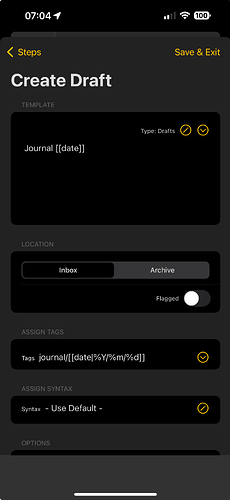

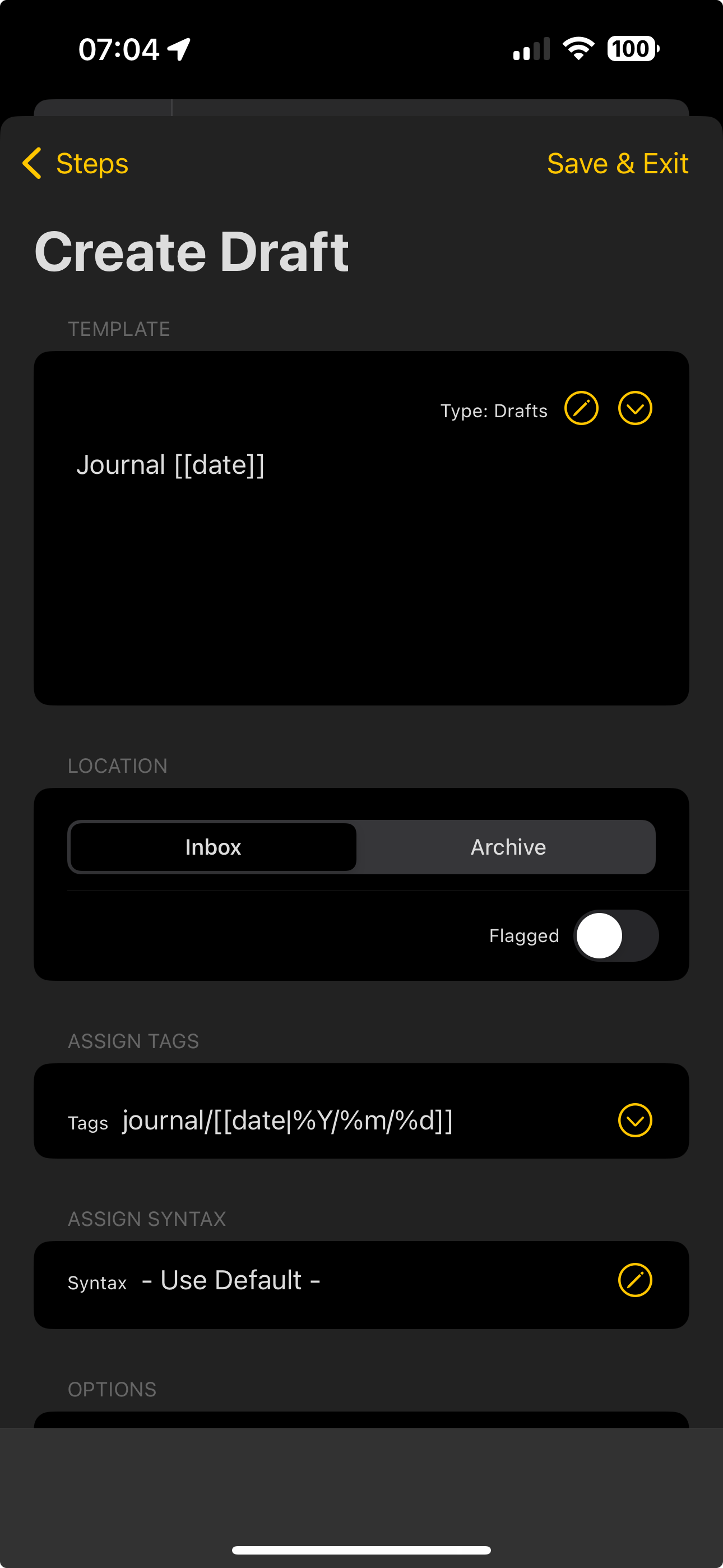

Thank you. Is this something I would add to the template somehow? Or are you suggesting I create a new scripted action that both creates a new draft (from a template) and adds the tags?
I was assuming your existing template is added via an action that had a single Insert Text step. Take that existing action and add a second step, a Script step. Then put the two lines of script into that step and save your action.
The first step inserts your text and the second adds the tag.
On the other hand, if your template action is based on a Create Draft step instead, then you have a tag field available and can just use that same tag format from the code above in that field.
In the case of the specific “New Draft with Template” action that this thread is discussing, @sylumer’s code could be inserted as follows in the existing script:
