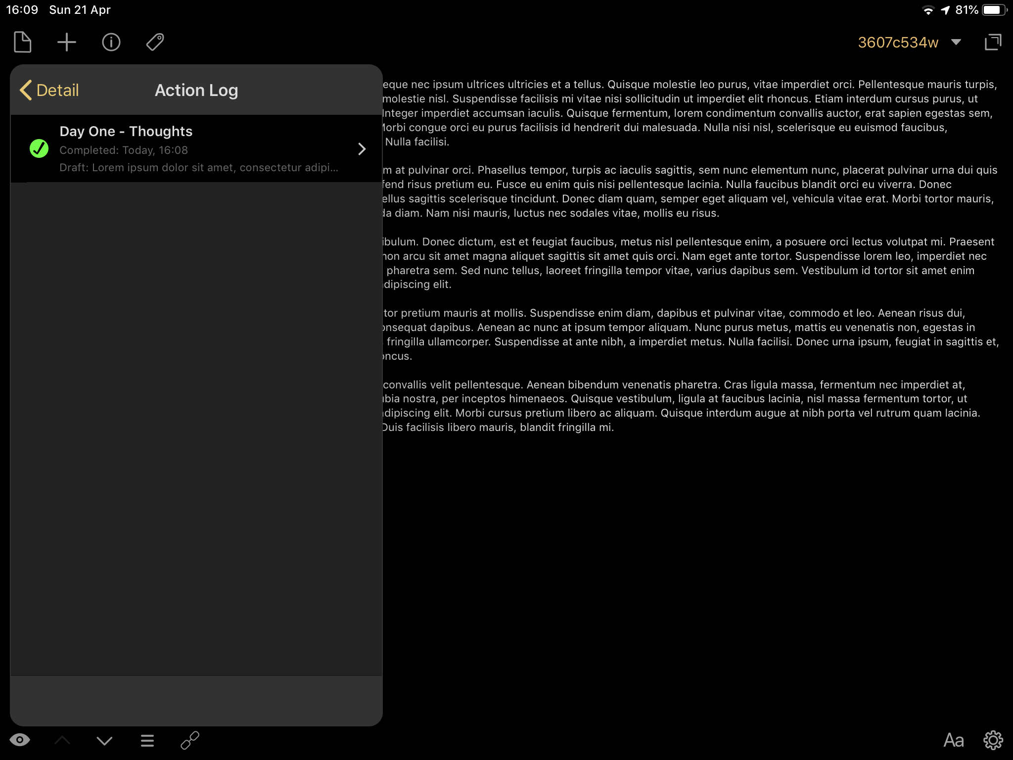

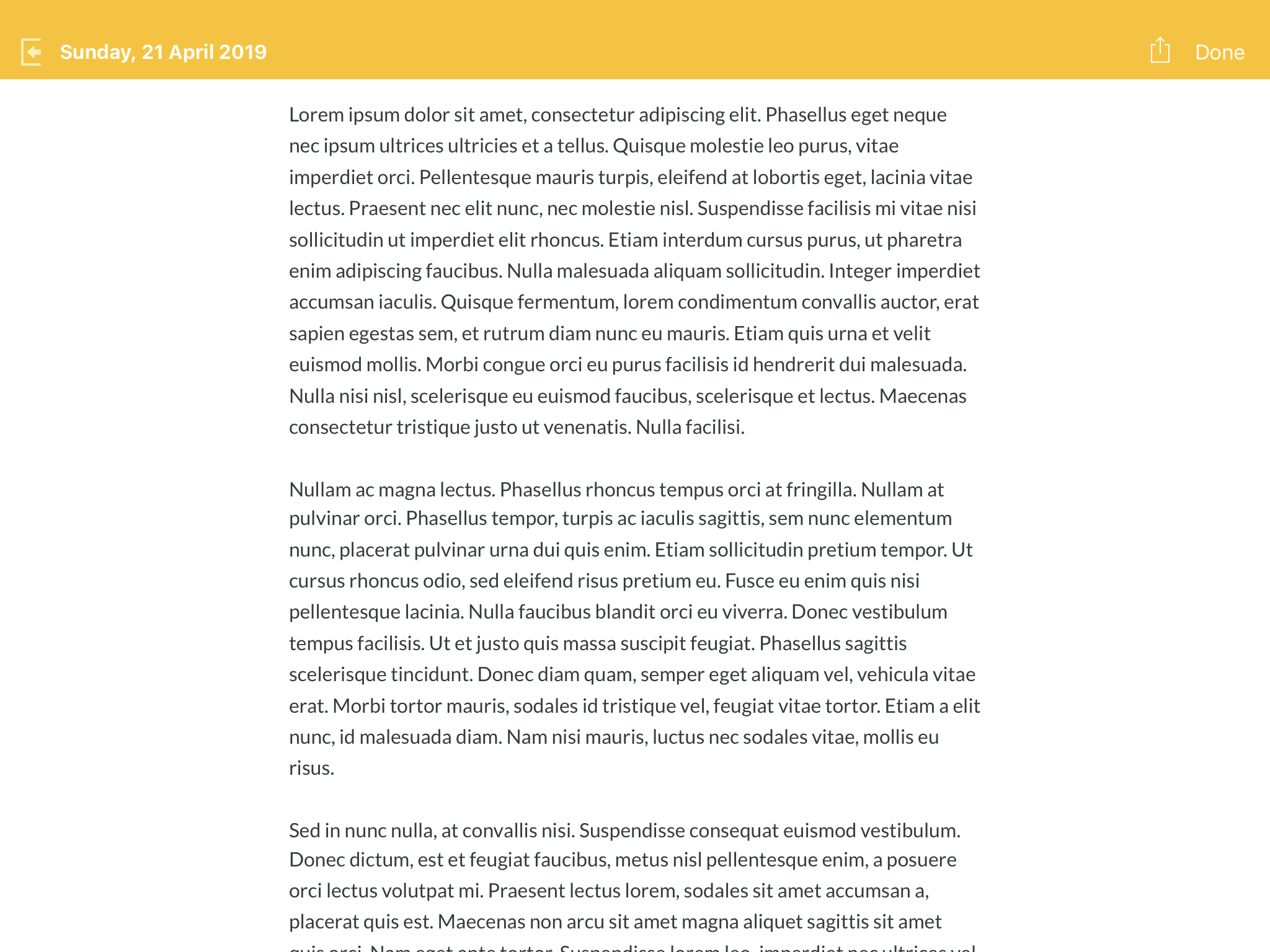

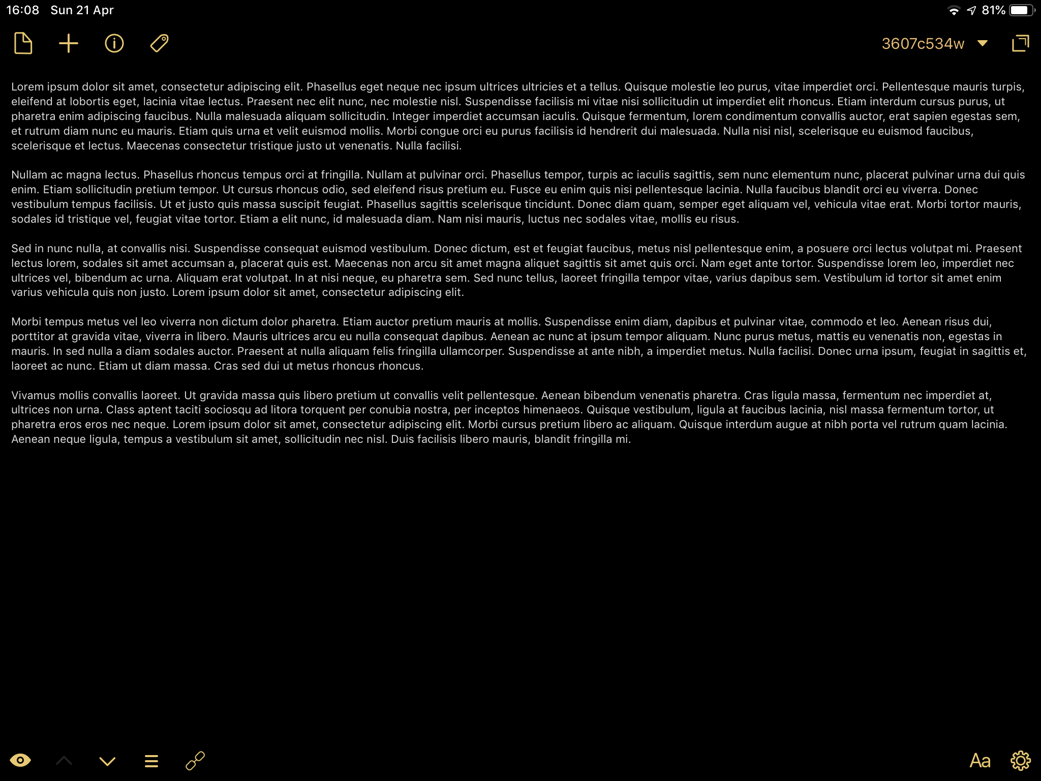

Worked for me with a quick test.
Started with a draft containing multiple paragraphs of text.
I created this action and ran it against the Draft.
Day One opened, and populated the new entry in the journal.
Result in Drafts showed a success.
Maybe retry with my action above and see if that works? If not, can you share some sample Draft content that fails? Can then take a look at what might be going on in the content.
