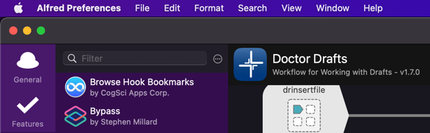

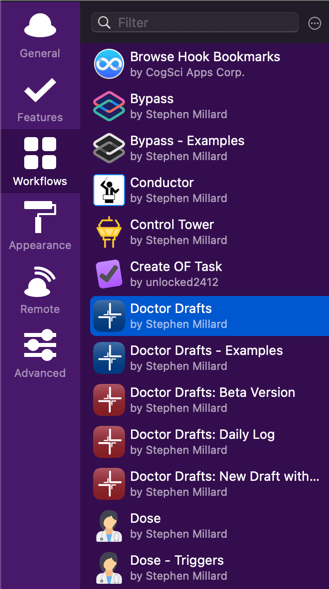

1. Confirm the version of Doctor Drafts
Until I add this into the next thing, I think the easiest way to get this is by looking at the title of the workflow when you select it in Alfred’s preferences.
The latest release at the time of writing is version 1.7.0

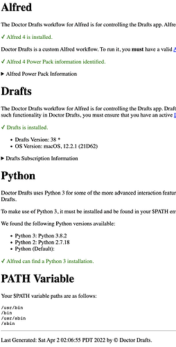

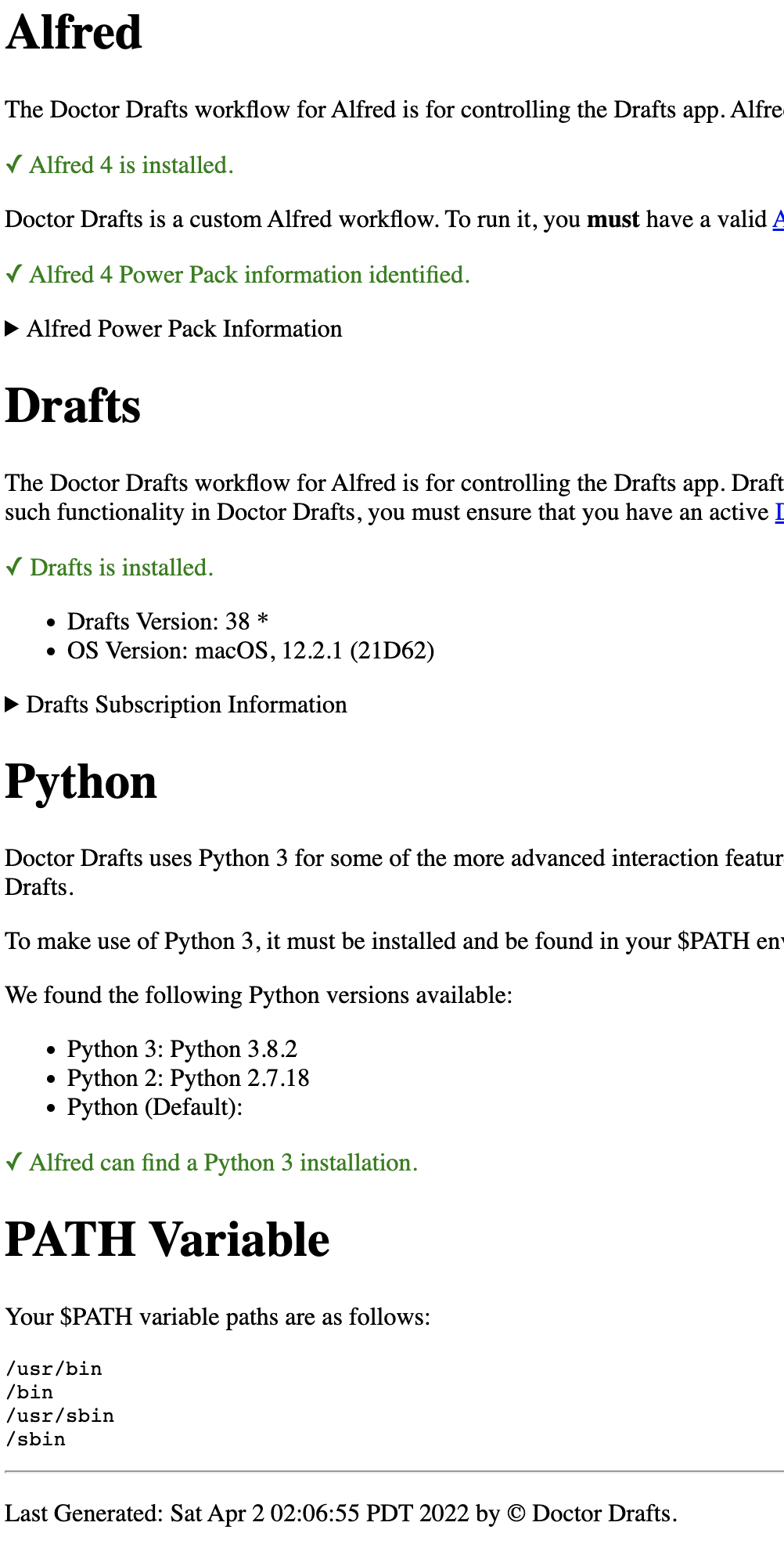

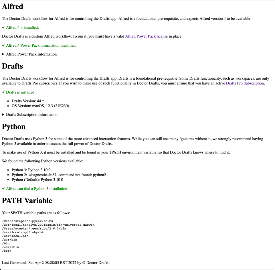

2. Run drdiag
Run the drdiag Doctor Drafts flow via Alfred. This runs some diagnostics to determine you have everything set up correctly. Put the results (screenshot or copy & paste the text) into your reply - but DO NOT expand/include the Alfred PowerPack or Drafts Pro) subscription information. Those specific details are not relevant here and should not be publicly shared.
For example, here’s how my drdiag results look:

My initial guess is that it isn’t appending to random drafts as you noted in your first reply, but only what draft you have open last as you mention for your example case in the video and I think suggest in your original post. Based on that assumption, it leads me to suspect you may have skipped some of the Doctor Drafts set up instructions, or that something failed when you were following them.
The drlog flow has a block noted as “Match {query} in title and pass out UUID”. It runs a launcher shell script to run a Python script, which executes in the background and identifies what draft is the daily log using the command ./runpythonscript.sh match_title.py $argv.
Ref: You can view details, including the flow layout, for this on the Doctor Drafts web site - Flow: drlog.
I think the script may fail to run, pass back something, but not a UUID for today’s log draft, and the resulting append then defaults to the current/last viewed draft.
But, this is just a first guess based on very limited information and not being able to reproduce the issue. Hopefully, the answers to the questions above will help get a bit closer, and may even confirm my theory.
As a final point of note, in your video it appears you have added your custom dlog flow to the Doctor Drafts workflow. I would recommend against doing this, and instead putting it in a separate workflow. That way you won’t lose anything when you update (and I will continue to put out updates), you won’t accidentally override anything in the original workflow, etc.
I structure my own additional flows like this, and even the examples I use on the website. I do this for exactly these reasons.

I am on the most current version of Doctor Drafts. I had gotten a little overwhelmed by the whole Python instruction set and don’t think I completed it correctly on my first try. But then I got the rest of the way through it and after that I deleted Doctor Drafts and reinstalled it.
I do see that I don’t have as many $PATH variables as you do…

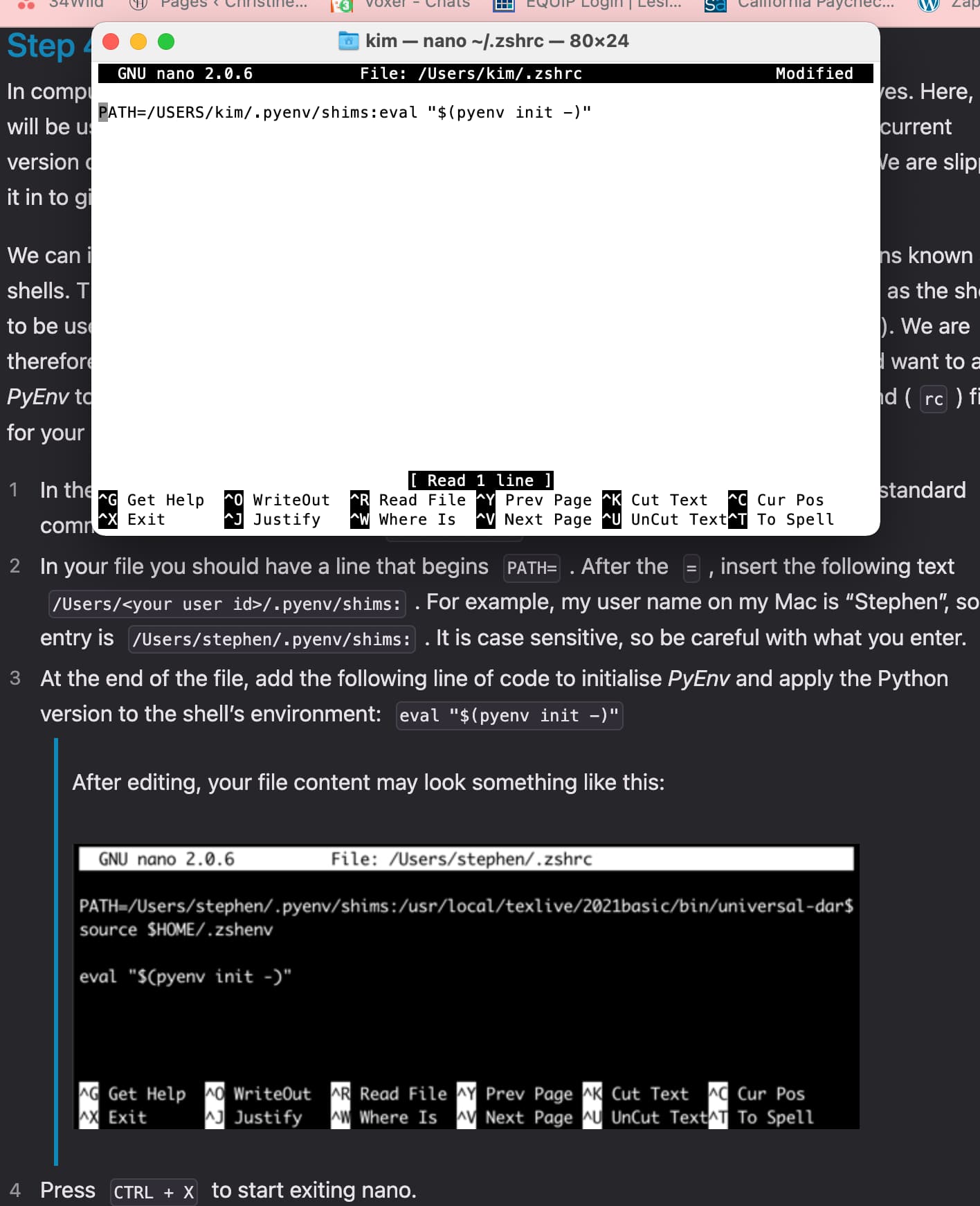

Okay… I noticed that I had no default set and not as many paths as you. The step I got the most stuck on was Step 4.
I will have to google how to reset this and try again (unless you happen to be so kind as to explain but I’m not expecting free labor!).
Looking at that screenshot, your eval command text is trying to be added to the PATH variable. That should be a separate line as in the screenshot from the instructions so that it can be executed as a command. Don’t worry about the other paths. They get added as you do and add more stuff at the command line.
I agree that the shim path should be appearing in your PATH output; hopefuly correcting your .zshrc file will resolve that.
Subsequently, when you get to step 7 in the instructions, that will set your default Python version.

Thanks so much for your time - I went back and tried again starting with step 4 and nothing changed. :frowning: I made a video showing all of the steps and they look successful: CleanShot 2022-04-03 at 20.47.51 · CleanShot Cloud
I’ve watched the video, and there are a few points to note.
  1. You have still left the eval command on the same line as the PAtH. As shown in the instructions, and as I noted above, you should have these on separate lines as they are separate instructions. As it stands I suspect the computer tries to rcarry out that line and effectively fails as it won’t be able to understand the intent of those two instructions concatenate together like that.
  2. For info, zsh and bash are different shells. The default on Mac became zsh several releases ago, which is why I tend to put everything into zsh when I publish. But, there are many possible shells to use. For example my default shell is fish. I would have expected yours to be zsh, but apparently you have stayed on bash or switched to bash. That’s why exec $SHELL could give you a bash shell execution. I’ll have a think about the best place to tweak the instructions for that (I’m thinking maybe ensure the user is switched to zsh explicitly, earlier, just to accommodate this command).
    Not executing this additional should not affect drlog or Dr Drafts in general. It is just there to bring that path and evaluation or the shim into your current session… But if you don’t attempt to use it in that session, then there should be no issue.
  3. As noted above, don’t get hung up on me having more entries in my path. Some people will have many more. Some people will have fewer. It all depends on what you have on your Mac. If this is the first time.you are editing the file, and nothing else has initialised or updated it, well, you’ll be starting with just one path.
Please review the above and check what difference that makes.

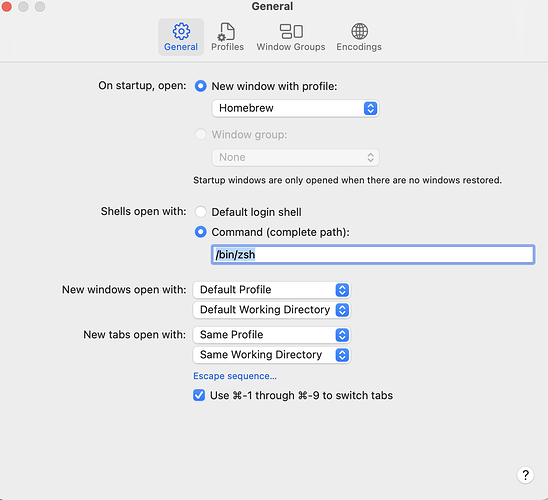

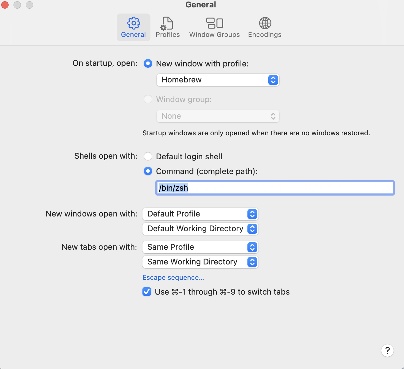

Interesting… in settings it says I’m on zsh.
Sorry, I missed the note above about the path entries. Got it now!
How did you get on? Is your issue now resolved?
Thank you for checking in, I got stuck trying to troubleshoot why the command isn’t working for me - as you can see in my screenshot my default is zsh but somehow when I’m following the steps I get switched to bash. I will update here again when I’m able to make any progress on it.
