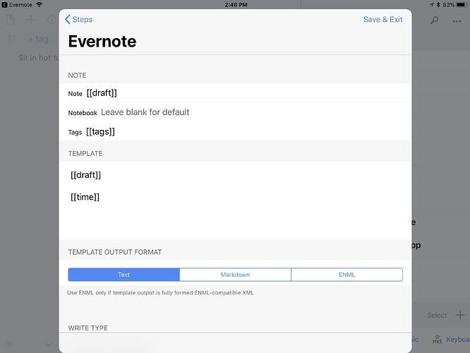

I created a new action to send to Evernote. (see below)
With [[draft]] as the Note, after exporting to Evernote all of the spaces in the title are removed.
Is there syntax to have the complete first line of the [[draft]] be the Note title?

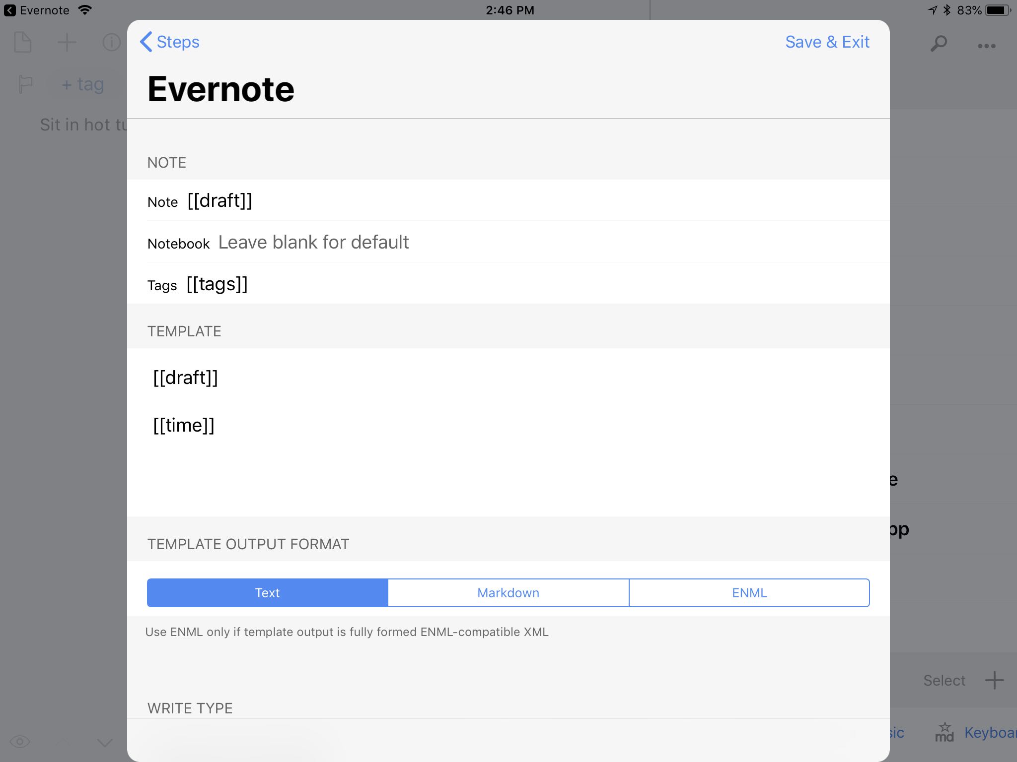

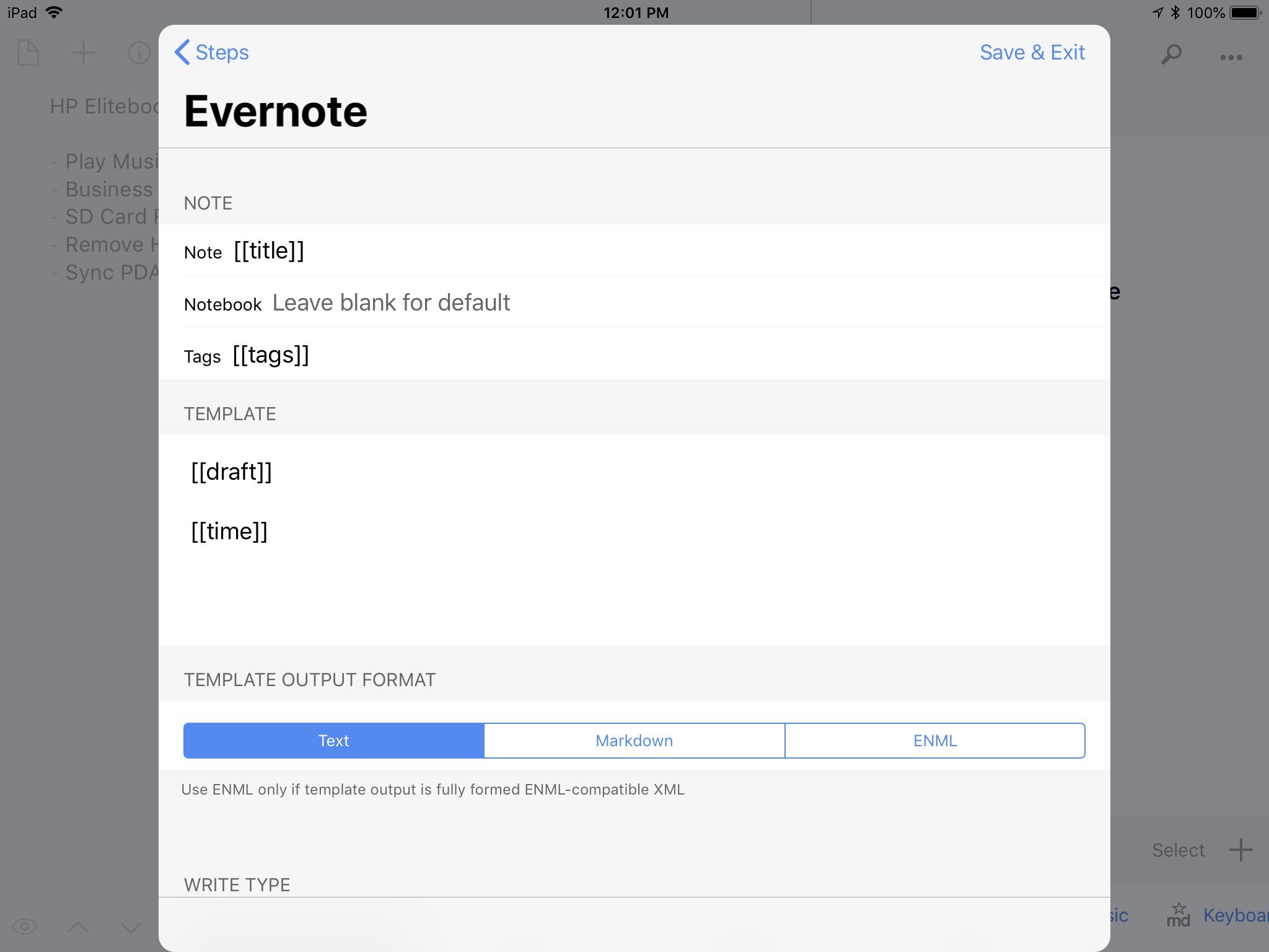

Just try [[title]] in the Field for Note title
I know I wish it were that easy! Whatever the text is in the body, all the spaces are removed.
