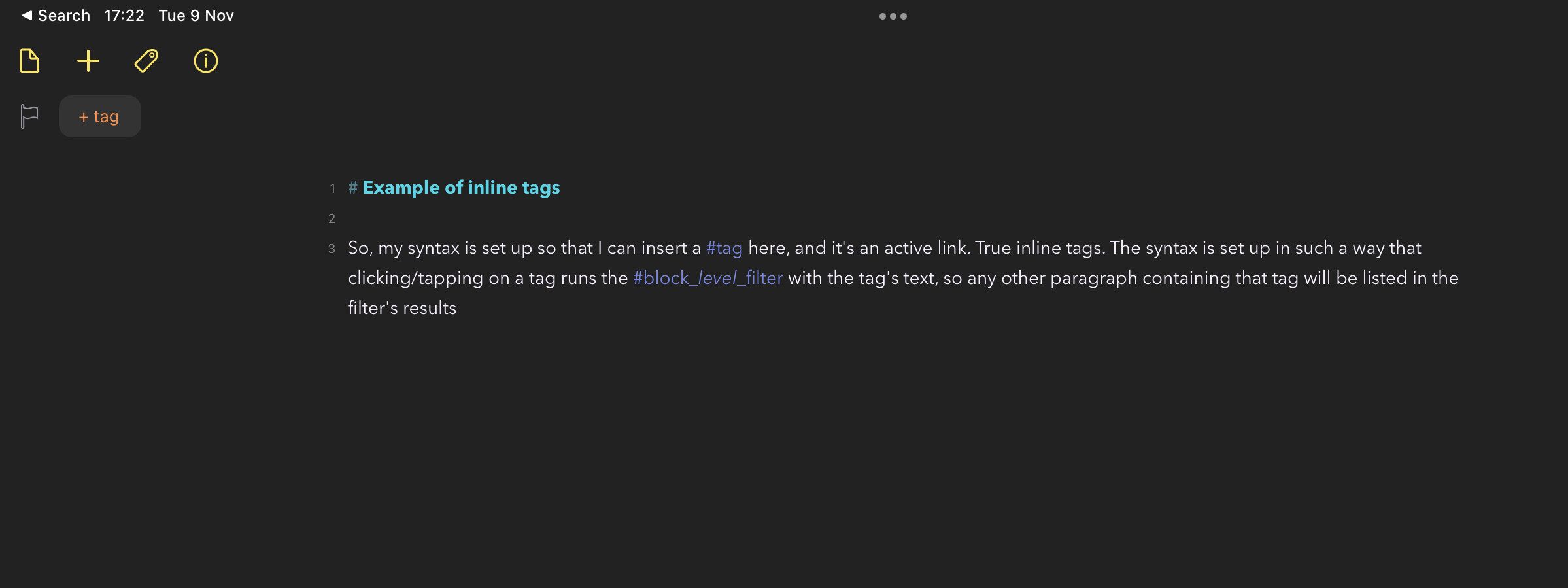

I use both wiki-links to create connections between drafts and inline tags as references I can filter. I default to inline tags when I want to have the ability to link together a series of “blocks” without the necessity of a titled draft to pull them all together, which was what I thought you were trying to achieve…

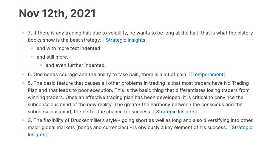

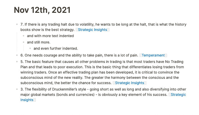

As a devoted user of Drafts I admit to not using it for everything. In this case I think that you are trying to force fit something into Drafts that can be done much more easily elsewhere. One option is Roam, which is designed to handle problems like this. But, Roam is relatively expensive, so Logseq - which is free - may be a better choice. I’m going to try and attach three screenshots from Logseq.
The first shows a Daily Note Page that has entries I took from your postings - each referencing one of your areas of interest. In the first entry I added several layers of indentation, just to show how that works.

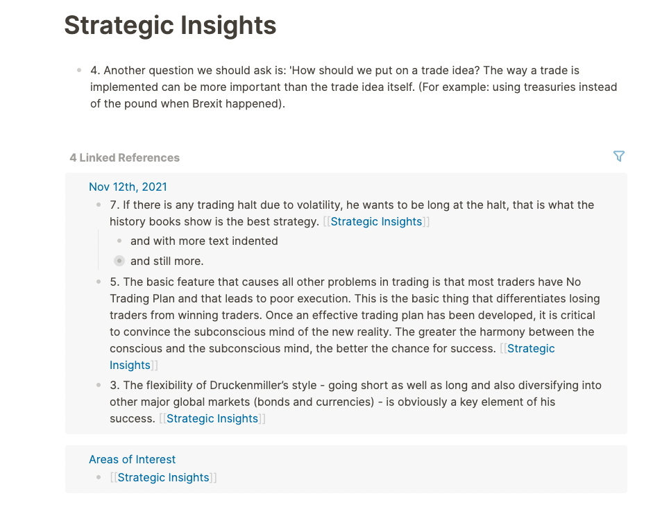

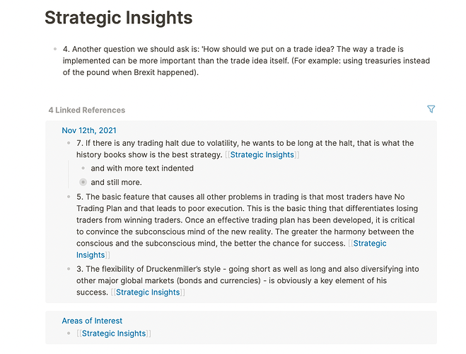

The second shows the page “Strategic Insights”. The top entry was made directly onto that page. The others are “linked references” from the Daily Note Page. The first of those entries demonstrates that a page reference applied to a top level applies as well to indented information below it. Block and child blocks in Logseq and Roam lingo.
Using Logseq, entries can be made on any page and – if referenced to a different page (as I did with the Daily Note Page) – they will all be collected on the referenced page as linked references.

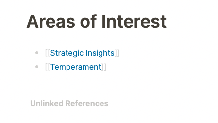

The third screenshot shows a so-called Map of Content, or structured note in Zettelkasten-speak. It is a page on which links to pages devoted to individual areas of interest are placed. Its purpose is to simplify navigation.
