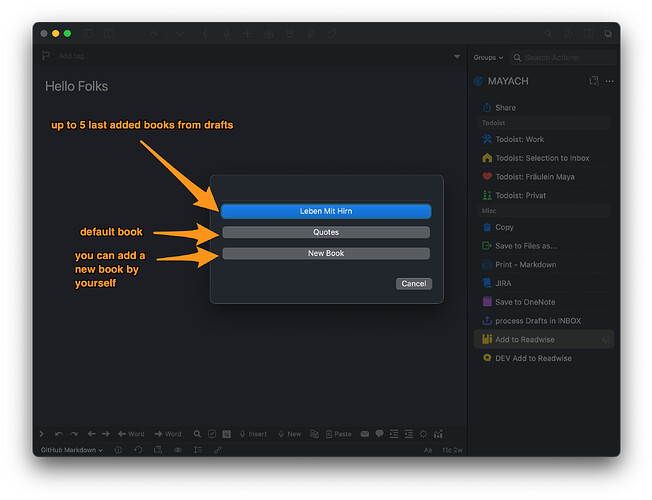

Hello folks,
I just finished an update for the Drafts 2 Readwise Action. From now on you can add your Drafts to Readwise while selecting from a comfortable menu with the last added items from Drafts or create a new book in Readwise.
Update is pushed to the action directory. Feedback is warmly welcome.
@jaymf & @woody please have a look too!
Kind regards
