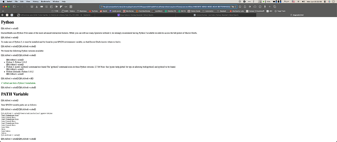

Wanted to flag that the Doctor Drafts documentation suggests two different ways of installing Python3. And one of them at least doesn’t seem to be working for me. The install page on the web site links to a 2021 page recommending the official python.org installer, and specifically recommends against using homebrew. The diagnostic page that comes up when you run drdiag within Alfred links to an older post that describes using homebrew (and pyenv) and specifically recommends against using the python.org installer. I admit I am well out of my depth here, but these suggestions seem to be in contradiction with one another.
For my part, I used the python.org installer as recommended on the Doctor Draft web site install page, and while I can access Python3 from the terminal and run a print command to test it, Doctor Drafts commands still aren’t working for me, and drdiag tells me it can’t find Python3. Still troubleshooting that.
Thanks for flagging the inconsistency, I’ll take a look at aligning them.

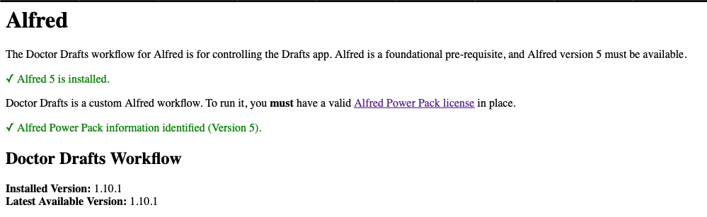

v1.9.0 of Doctor Drafts is now available at doctordrafts.thoughtasylum.com.
The new update includes explicit support for URL handlers (Alfred v5) on many of the external call triggers meaning you can call a big chunk of functionality from URLs. In addition, there is a fix for appending flows where a used UUID was not always being reset (and it should have been).

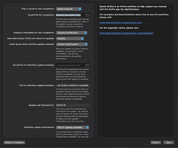

The main change is that the environment variables have been transitioned to user configuration options, so you’ll be able to more readily review and change these in Alfred 5. There are also some more behind the scenes changes.
The update was mainly driven by the upcoming Alfred workflow gallery, and prepping the workflow to (hopefully) be included.

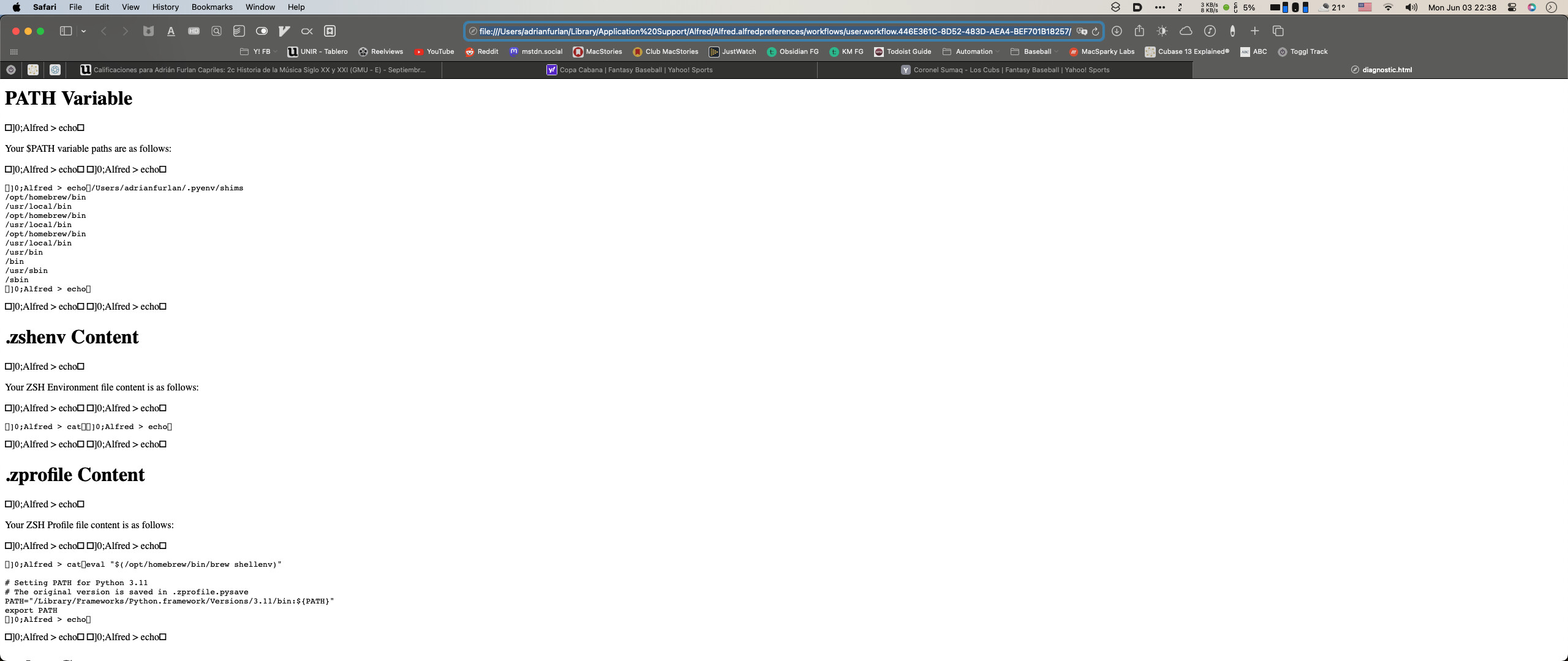

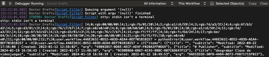

Hello, I’m trying to get Dr Drafts working in Alfred.
I can create drafts without issue.
But when I try to search (say via drtitle) I get no results.
This is what the debugging mode in Alfred shows.
I’m running Sonoma 14.5 and have python3 installed
Hope you can help me get it working.

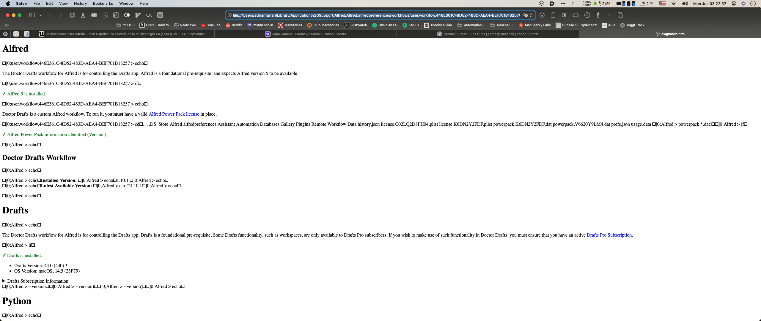

Did you follow the installation instructions for installing Python 3, and what do the system diagnostics show (as covered in those instructions)?
I followed the installation instructions and everything seems to be working.
That’s a little ambiguous. Are you saying that now you have followed the instructions that everything is working and so you no longer have the issue; or are you saying you followed the instructions and the diagnostics indicate everything is working but you still have the issue?

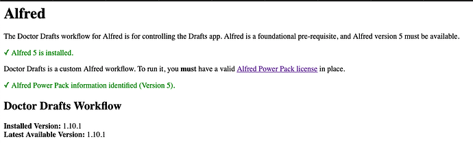

There is something odd looking in your output there. That page should look more like this:

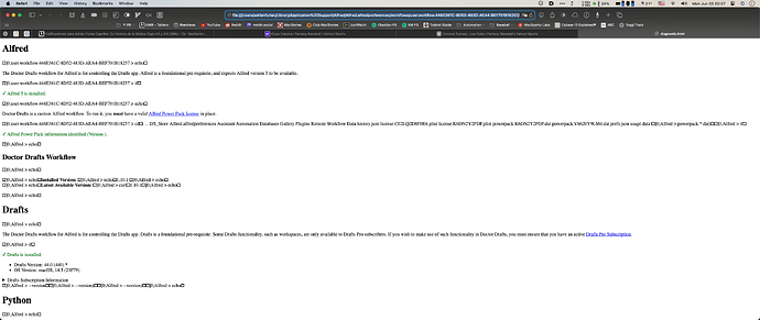

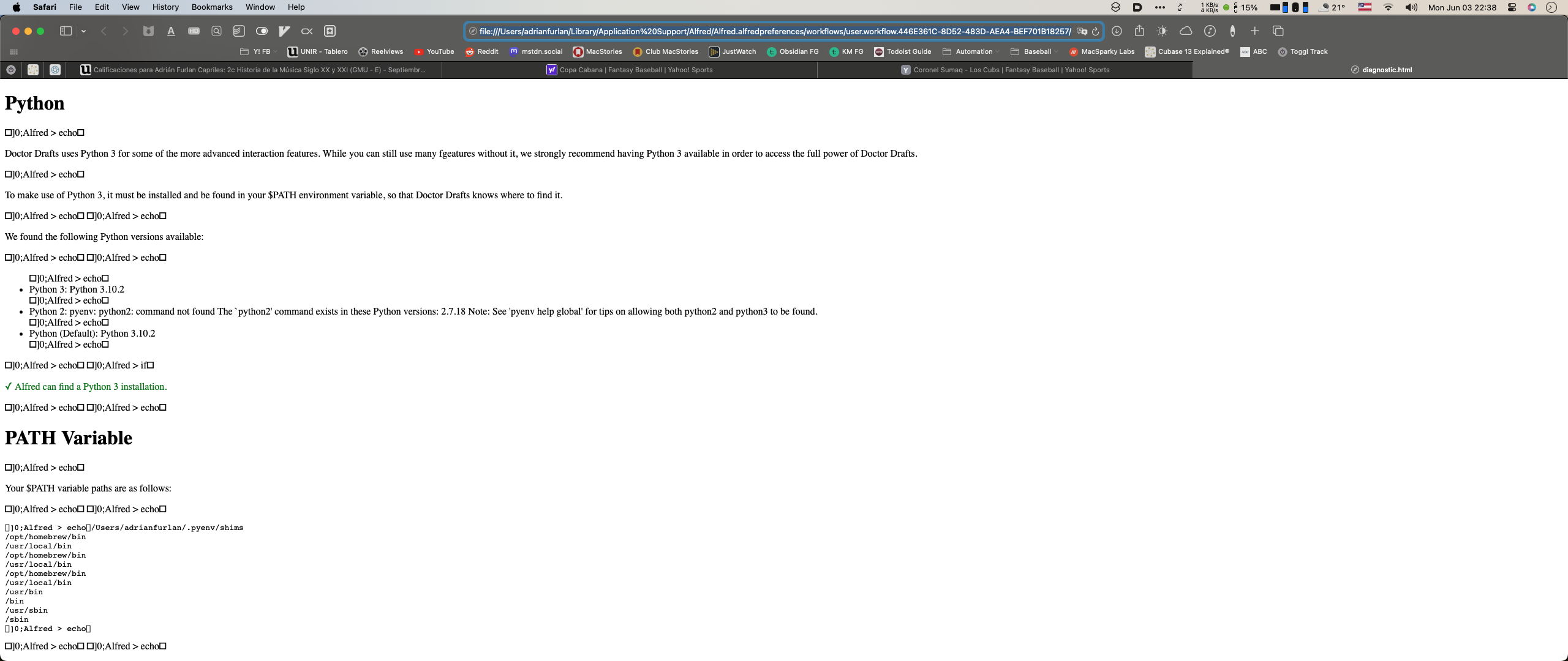

You seem to be getting all sorts of output appearing on the web page that the shell script generate that you shouldn’t. Now, I am a little behind on my OS updates (I’m on 14.4.1), so maybe that’s something to do with it, but I would be surprised.
I do have some changes to apply to this workflow that could might help. I need to change a lot of scripts in it to use --no-rcs and then test it. I’ve done this for most of my other Alfred workflows, but Doctor Drafts is the biggest and most complex so I need a good couple of days to run it through. In the case of the other workflows, some of them also use Python and this has seemed to take out some edge cases causes by user configuration files such as .zshrc. If your problem is indeed ongoing that could be a cause, but it isn’t guaranteed to be. It would be worth checking through your config for anything that could interfere.
I followed the instructions and the diagnostics indicate everything is working but I’m still having the issue.
Tomorrow I will check try using a barebones zshrc to see if that works.
I changed my .zshrc and it works perfectly now, thank you

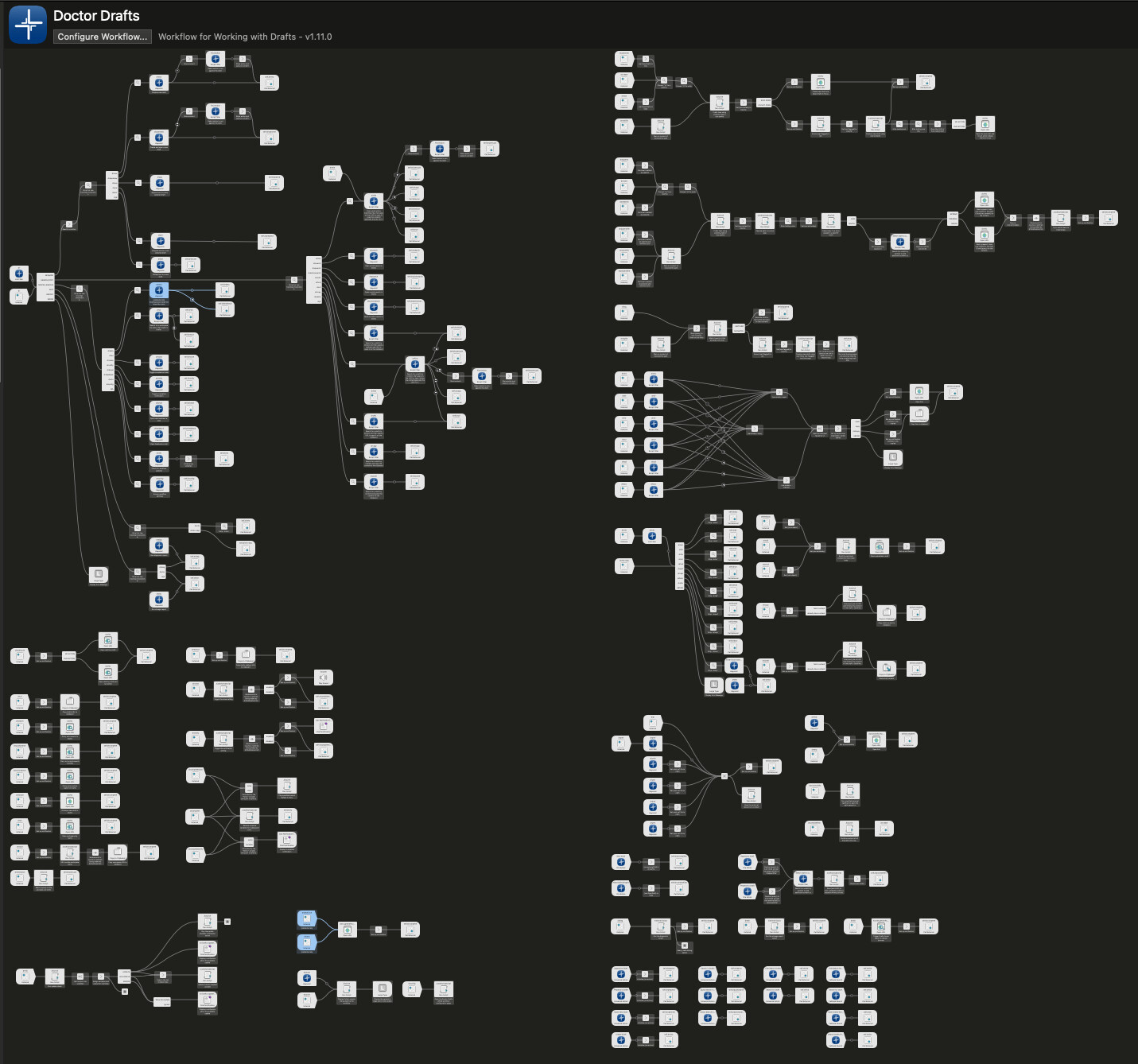

During my end of year break I have finally managed to sit down and get some changes and testing done on Doctor Drafts, so there’s a new version out for everyone to enjoy as we all head into 2025.
  • The -no-rcs option is now applied throughout and everything still seems to be working; do let me know if you find otherwise
  • The links to all the online information sites (accessed via drdoc, drscr, etc.) have been updated after being woefully out of date in many cases.
  • All of the keyword triggers are now customisable via the workflow settings. You can even blank them out if you find the range of options overwhelming; just be sure to keep the primary option (dr - though you can change that too) available, and you can then still get to everything via that rather than directly.
  • A missing keyword for one of the forum search types has been added. Everything was configured and documented, but somehow the keyword trigger never got added.

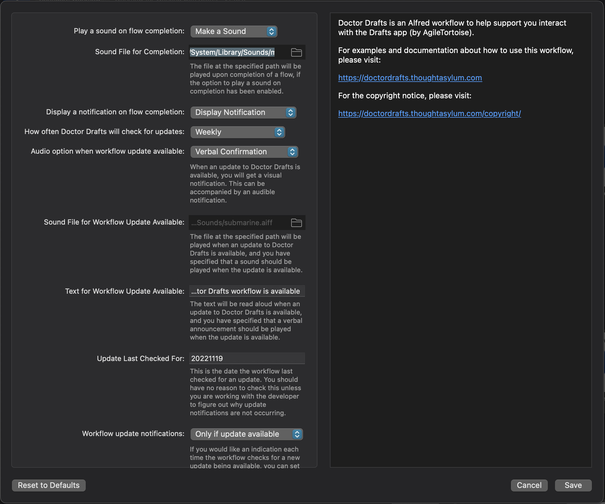

  • There’s a new keyword trigger and flow to open the configuration settings for the workflow.
  • A fair few documentation tweaks on the website (mainly corrections).
I’ve also updated a lot of the behind the scenes configuration that builds the website so it is using more up to date versions of things, and hopefully I don’t have to keep fixing the search a few times each year after this round of revisions.
To get the latest version (v1.11.0) of Doctor Drafts, visit doctordrafts.thoughtasylum.com.
