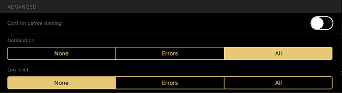

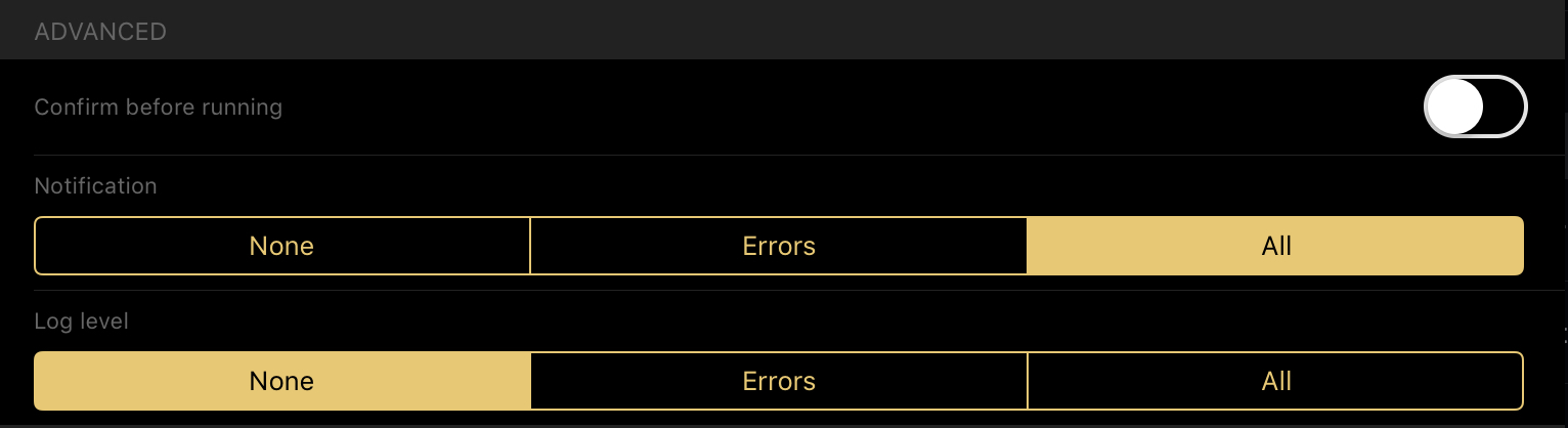

They are still there. They are set on a per action basis as described here:
https://getdrafts.com/actions/advancedsettings
You can set an action to never show, show for errors only, or always show.
Thank you for replying. I found those settings and they make no difference. I wonder if I have a bug?

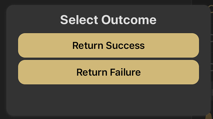

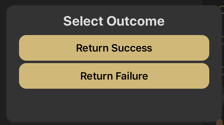

They should absolutely make a difference. Can you try installing and running this test action I created?
It starts by asking you to choose an outcome.
It is set to show “All” notifications. Therefore you should see a message no matter what happens.

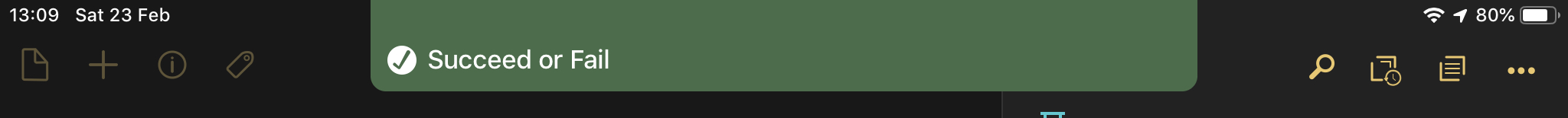

If you select to succeed, you should see this:

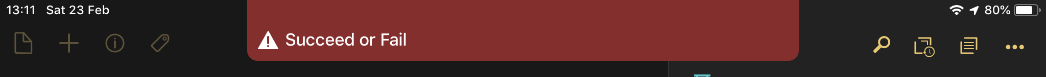

If you select to fail, you should see this:
