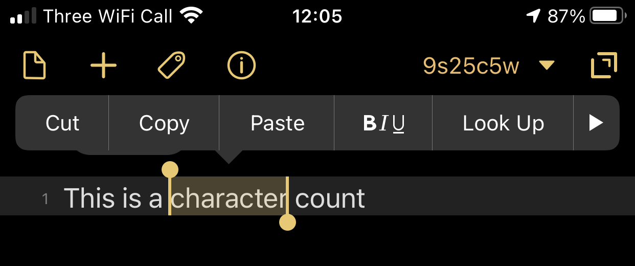

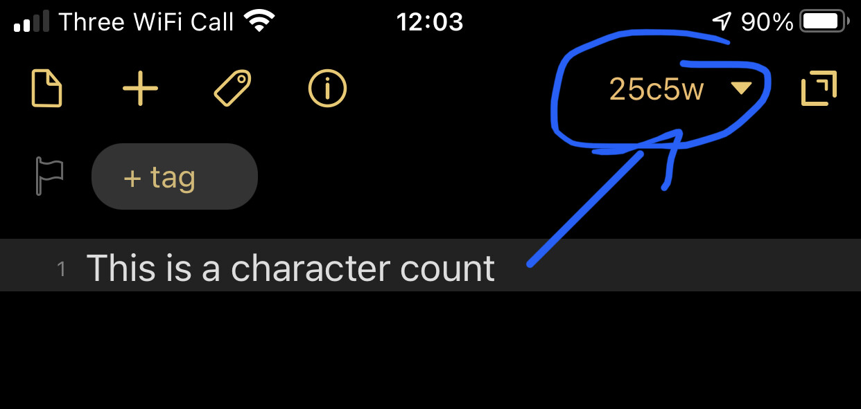

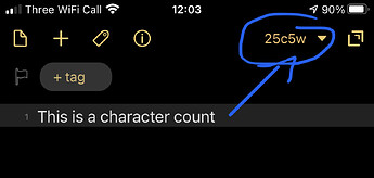

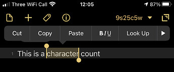

FYI, display of the selection count in the interface is something that has been added to current beta of Drafts and will be in R15 when it comes out this Fall.
