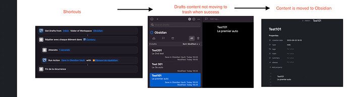

I’m trying to automate the export of my Draft note to obsidian with Shortcut.
I have succeed to create an action that Move my file to obsidian (thanks to this community).
I am using this action : Save in Obsidian Vault | Drafts Directory
Expect I have change 2 parameters:
  • Change to “append” to update the file if it already exists
  • Add “Move to trash” when the action is done so my inbox is always empty
It works when I trigger manually the action.
Now I’m trying to create a shortcut that send ALL my Draft’s note to Obsidian, automatically (the final idea is to trigger this shortcut once a day, when I stop my alarm in the morning for exemple).
I have done some testing so far, and succeed to send multiple Draft’s note to Obsidian with a Shortcut, the only issue is that the action does not trigger the “move to trash” feature when it’s a success.
Is there a way to make it work with the “Trash” feature at the end?
