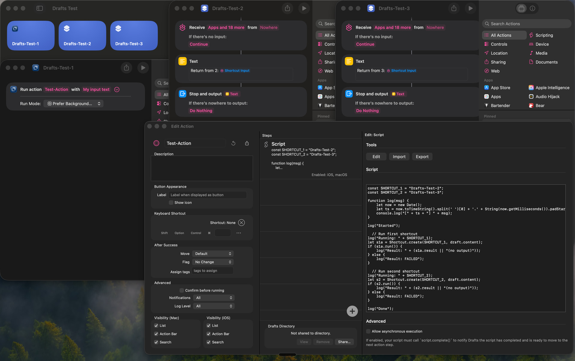

I want to invoke a Drafts action from an Apple Shortcut (because I want it to happen as a result of pressing the action button on my phone), and I’d like that action to invoke other Shortcuts.
I have a bit of trouble trying to do this, the action doesn’t quite seem to work, and I get a timeout message after a while:
(deleted image because I’m not allowed to have more than one, but it’s a screenshot of an error message saying “The action ‘Run Action With Text‘ was interrupted because it didn’t finish executing in time“)
I get the following logs when this happens:
[13:22:06.742] Started
[13:22:06.742] Running: Drafts-Test-2
[13:24:06.749] Result: FAILED
[13:24:06.750] Running: Drafts-Test-3
[13:24:07.668] Result: Return from 3: My input text
[13:24:07.668] Done
Script step completed.
The setup I’m using to reproduce this:
The results might vary if the shortcut is run on Mac instead of iPhone, or Run mode is foreground instead of background, but my use case prefers running in background on my phone.
Any ideas what’s happening here? :smiley:
It would be easiest if you share the actual action and shortcuts so I could reproduce. You can upload the Drafts action to the directory as “Unlisted” and use that link.
I think this probably would need to run in the foreground to work because calling Shortcuts is done via URL scheme, and iOS does not allow background apps to open URLs in many cases as a security policy, and opening an app’s URL will always open it and bring it to the front…but I could test that theory if I have the examples to run. I think there’s also some weird behaviors trying to run multiple shortcuts simultaneously, which could be related.

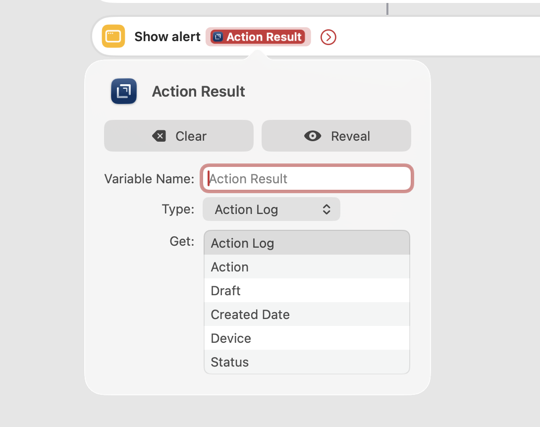

However I’m stumbling on a bit of a maybe silly problem - I’m not finding a lot of information in the Drafts online docs about the Action Result object that’s returned by the “Run action with text” shortcut. And in particular, I seem to struggle to get Shortcuts to treat it as text or convert it into a dictionary - am I doing something wrong?
(In particular I’m trying to get the “Draft” property of the Action Result since that seems to be the main way I can get output from the Draft Action to the Shortcut that called it)

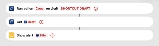

It is a custom object type, and has a “Draft” property that is the updated version of the draft after running the action.

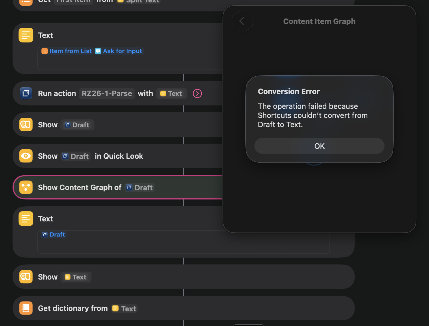

Thank you - it is exactly this Draft property I’m trying to access, but when I try to do so I seem to run into problems - e.g. by seeing the error above “Shortcuts couldn’t convert from Draft to Text”. It seems to happen on both my Mac and iPhone, but is it just me?

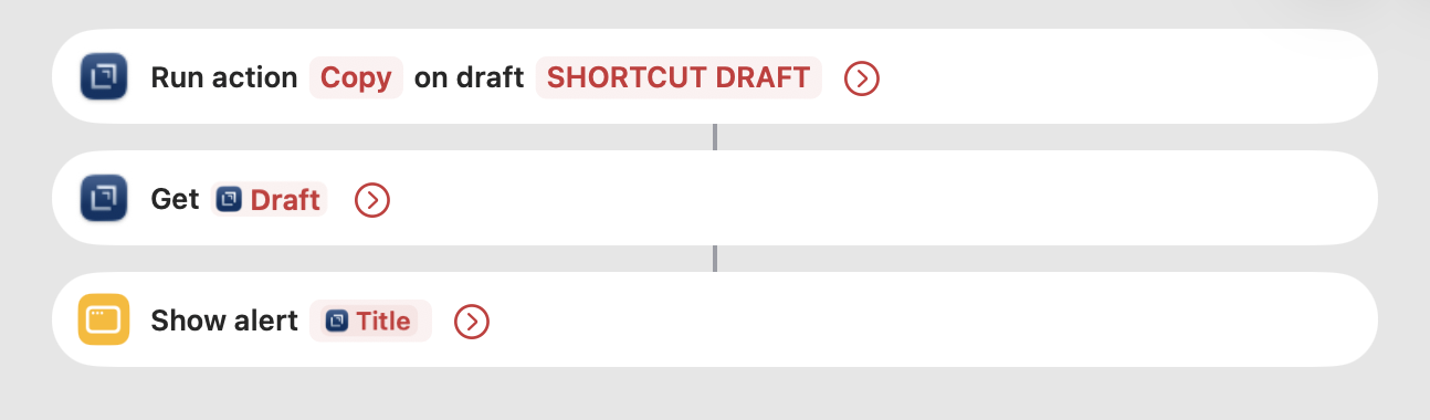

Shortcuts is a bit weird on nested objects. This seems to work for me…if I do a “Get Draft” which retrieves the “Draft” property of the Action Result, then work with that Draft to retrieve it’s properties.
Thanks so much - this seems to be working out for me!

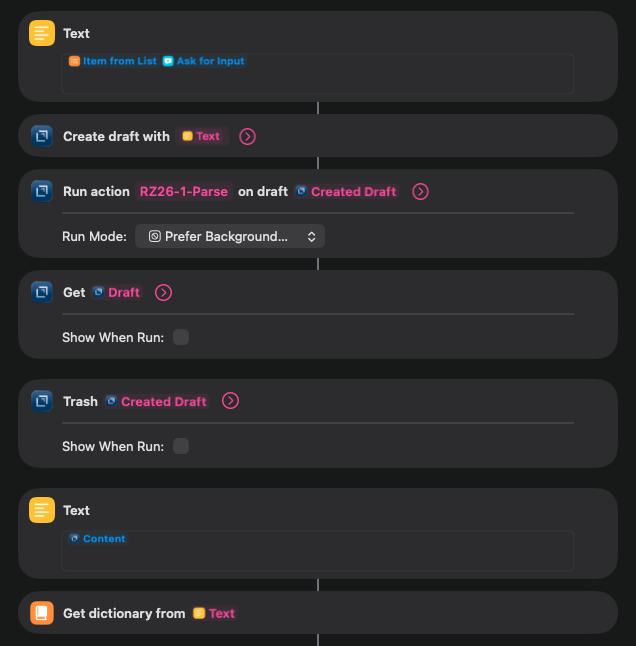

I’m now doing the following - if I use the “Run action with text” shortcut action that I did before then if I try to follow it up with the “Get [ActionResult.Draft]“ shortcut action it comes up with a prompt “Which draft?” and a list of drafts, so I’ve instead gone with creating a real draft, running the action, and deleting it after.
