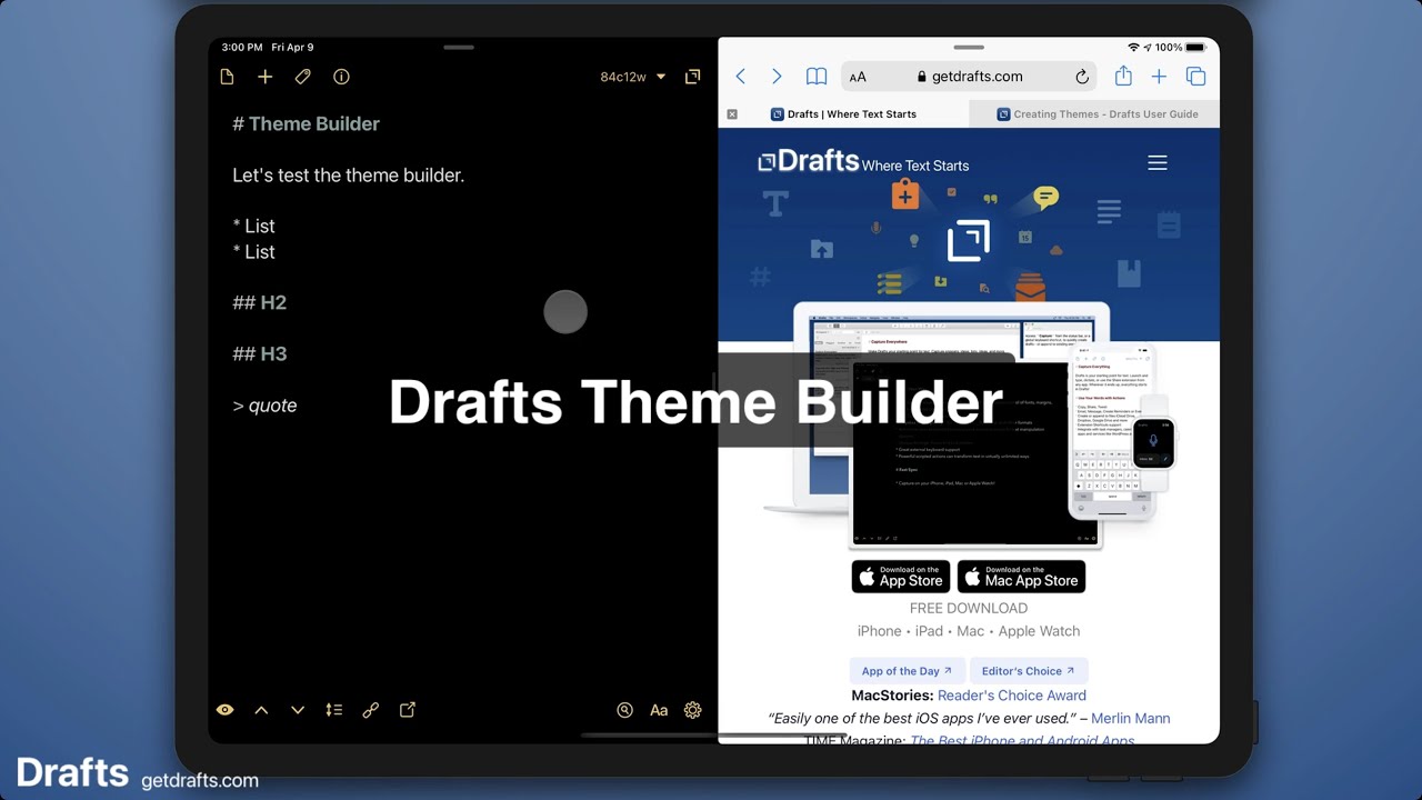

We’ve released a new online Theme Builder tool for manipulating themes. It’s best suited to making minor tweaks to existing themes. The video below is a quick walkthrough of how to load a theme from the Directory and make tweaks to it.
The theme builder is not a complete solution, by any means, but it’s a lot easier than directly editing the raw JSON format in a text editor.
Reading over the documentation on Creating Themes is still a good idea to get a feel for what the different elements in the theme do.

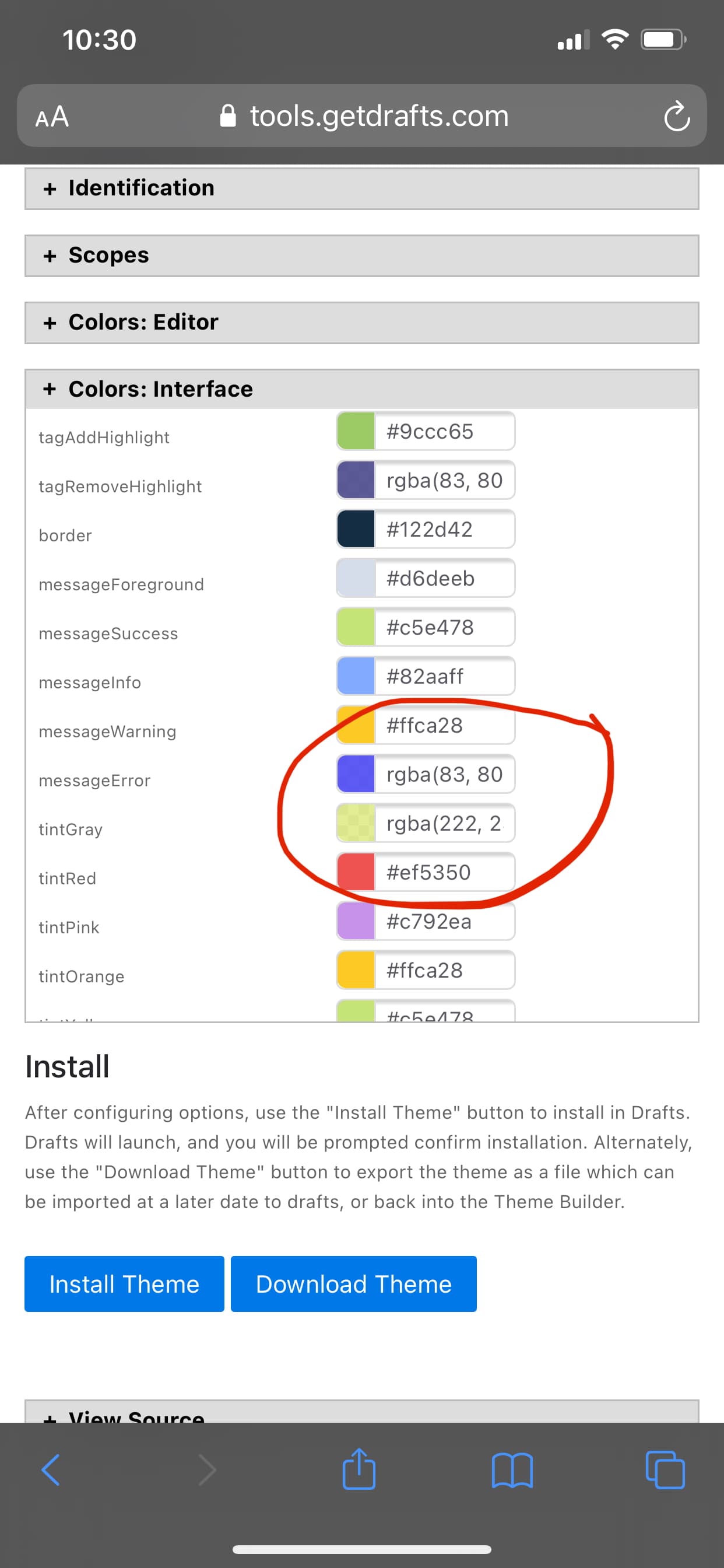

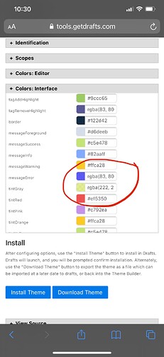

I am using Theme Builder tool to edit Night Owl theme that is in the Directory. I just made a simple color change to the tint item and then tap Install Theme and Replace it in Drafts. All these were done on iPhone iOS 14.7.1. This new theme worked fine until I returned to iPhone Home screen and then launched back into Drafts. Drafts reverted back to its default dark theme. It’s as though the Night Owl theme have failed to launch. If I changed the workspace to Night Owl, it worked again until I leave Drafts.
I thought that Theme Builder has a bug but upon trying to edit other themes in the Directory, they worked fine. So, it seems to be a bug with the Night Owl theme but what could it be?

I think I’ve figured it out. The Night Owl theme has a mixture of Hex numbers and RGB numbers. The RGB number is the caused. Once I’ve changed all of them to Hex, I can Install the Theme and it sticks.
Interesting. Yes, that is not supported. Are there log errors on the theme when imported? I would expect there to be a warning flag with errors when you view the imported theme.
How do I check log errors? There weren’t any error prompts at all.
Took a look at this…it’s actually a bug in the Theme Builder. The original Night Owl theme has hex values, the color picker control in the web version is altering the ones with alpha channel values. Will fix.

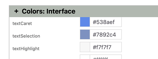

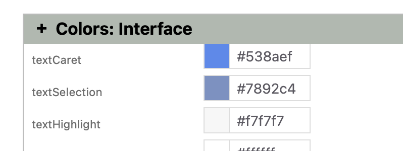

Can we theme the highlight bar when selecting text for copy & paste? It’s very hard to see in dark theme (on a mac)
Yes. The textCaret
, textSelection
, and textHighlight
colors are the ones you want to play with…

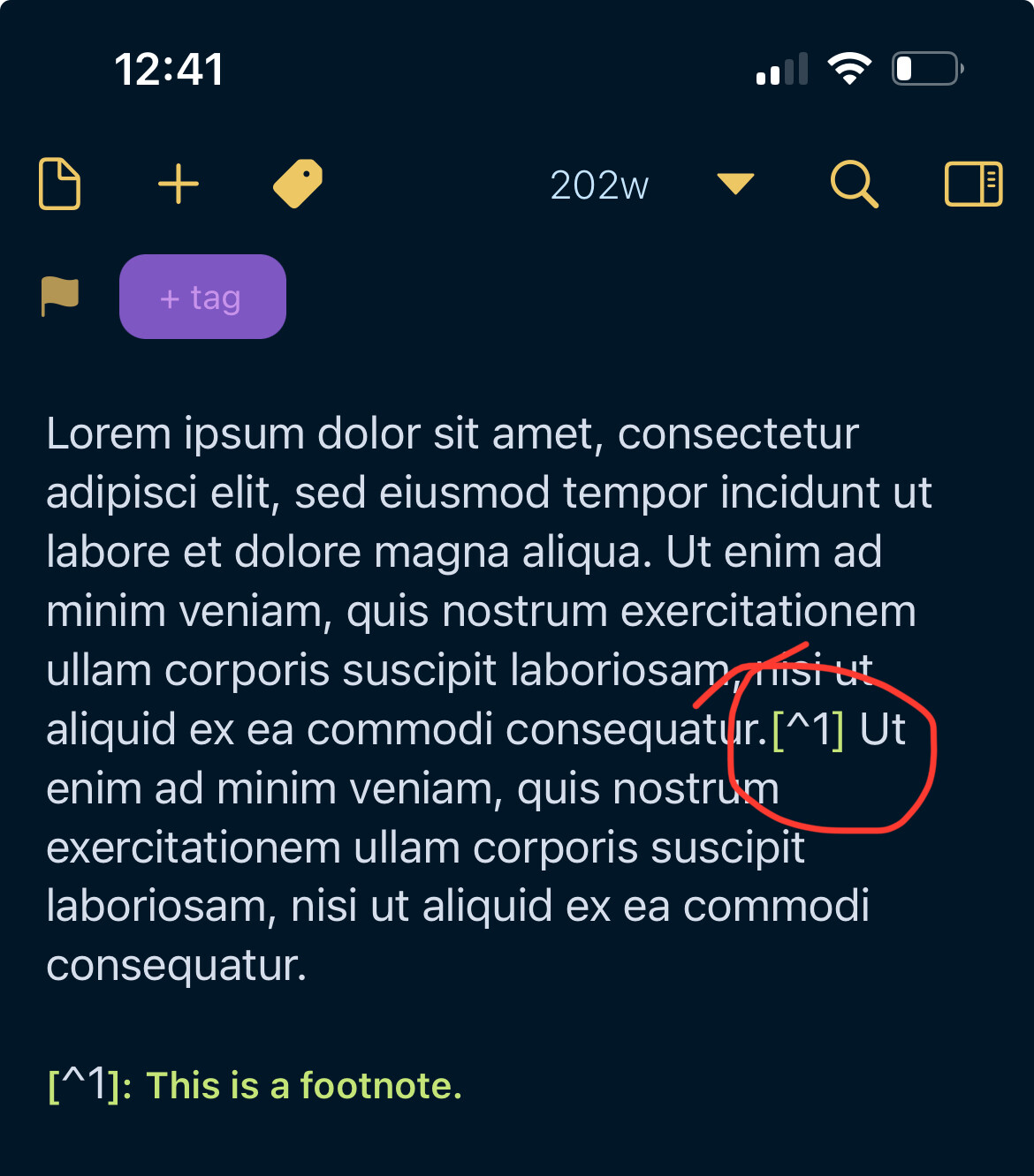

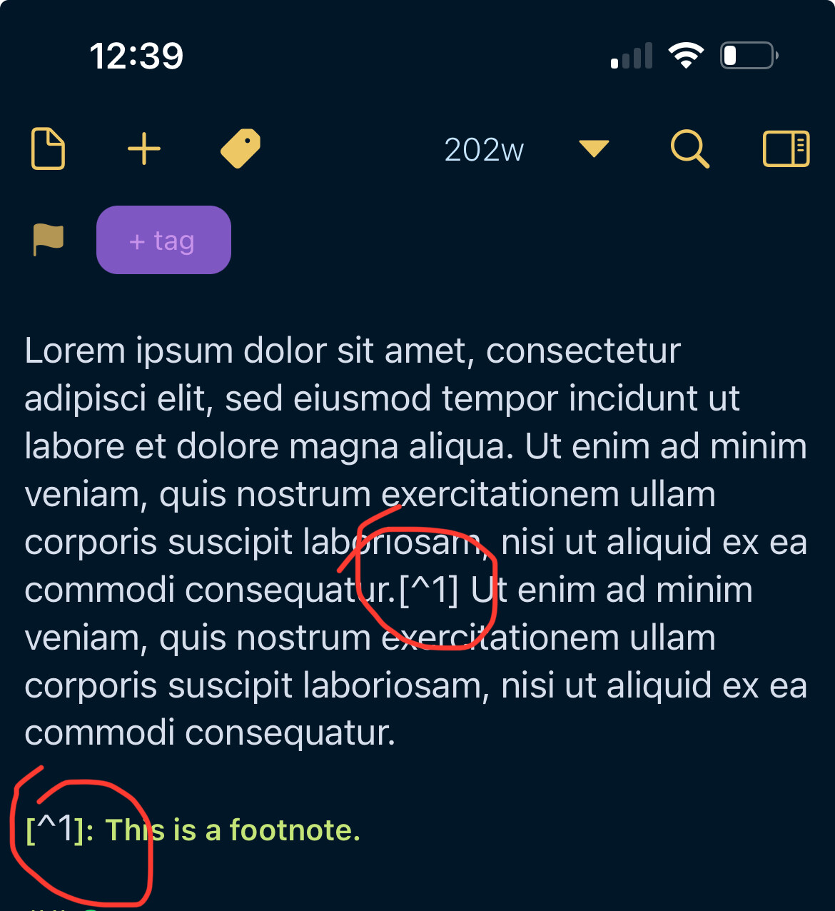

Regarding theme for footnote such as [^1], what would be the syntax for the square bracket, the ^ and the text please?
Edit: after much trial and error, the parameter to change are markup.link and text.link.
But, apparently, it only works for Multi Markdown, not iA Markdown.
In iA Markdown
Vs In Multi Markdown
Looks like I need to do some Syntax editing. Gulp.

Not sure which syntax you are using. The “Markdown” syntax doesn’t to anything with footnotes because they are not part of the original Markdown spec. Both MultiMarkdown and GitHub Markdown do syntax highlight them. Not as a separately theme-able entity, however. I think they are just treated as markup
I am using iA Markdown as I wanted the strike through and highlight. And so I learned about syntax and have included the footnote and footnote description. I wanted them to have separate theme instead of just using markup
and so I need to learn some Regex. I am quite happy with my setup now. Cheers.
