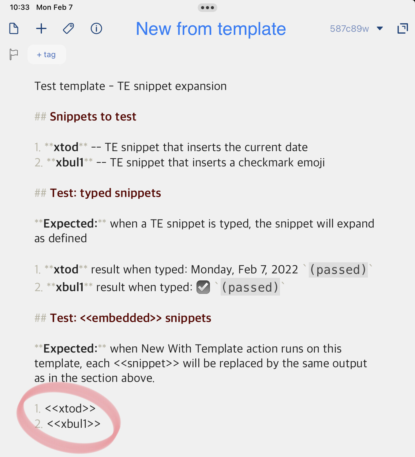

I only had snippets in that one template, so I created a test with that snippet, and a different one:
  • xtod inserts the current date
  • xbul1 inserts the character :ballot_box_with_check:
Template contents and screenshots are below for reference.
Test template contents
Test template - TE snippet expansion
## Snippets to test
1. **xtod** -- TE snippet that inserts the current date
2. **xbul1** -- TE snippet that inserts a checkmark emoji
## Test: typed snippets
**Expected:** when a TE snippet is typed, the snippet will expand as defined
1. **xtod** result when typed: Monday, Feb 7, 2022 `(passed)`
2. **xbul1** result when typed: ☑️ `(passed)`
## Test: <<embedded>> snippets
**Expected:** when New With Template action runs on this template, each <<snippet>> will be replaced by the same output as in the section above.
1. <<xtod>>
2. <<xbul1>>

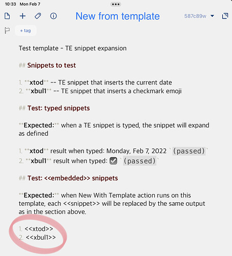

Output screenshot
Thanks for the details.
Did some digging in the code, and, yes, this is not supported. Scripted expansion of templates does not support TextExpander expansions for technical reasons related to the limitations of TextExpander integration.
Apologies for my initial misleading reply.
