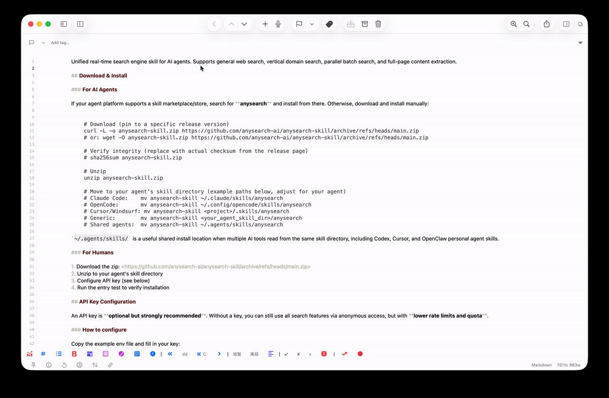

I am having an issue where text is disappearing when I type… very hard to concetrate like this…
Was happening on v52 and now v53.
Confirming “Moder Editor” is not selected.
Here is a video of the issue.
Running MacBook Pro 5 + and the less than desirable Mac OSX 26.4 (25E246)

@agiletortoise I believe I found the issue: It is happening when “Paragraph Numbers” is enabled. Confirming the issue with BOTH custom theme and standard Markdown theme.

two clues for now:
  1. paragraph numbers being enabled
  2. This draft contains a sufficient number of characters.
My experience continues and is identical to all that above mentioned.
Significant text plus line numbers enabled.
And clears to be readable on the next line.

There are two different issues I’ve seen:
  1. Text appears garbled / distorted when typing and seems to run into other lines as shown in the videos above
  2. Entire areas of text disappears when switching apps. Sometimes it will reappear when switching back to Drafts but I need to click into the text area to get it to work.
