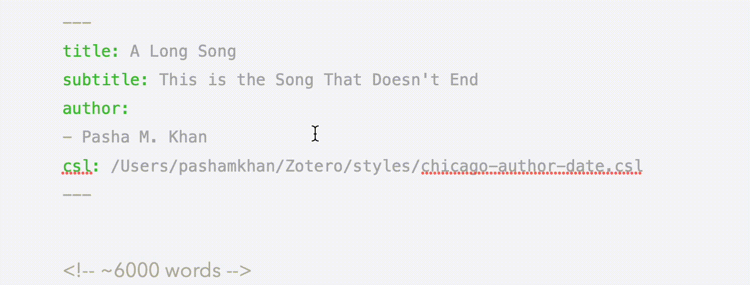

I’m trying to write a syntax for Pandoc Markdown files. My articles in Pandoc Markdown always contain YAML blocks fenced by a pair of triple hyphens ---. Sublime Text syntax-highlights YAML keys and list hyphens nicely within the metadata block.
In the Drafts syntax file though, I haven’t been able to figure out a regex to match YAML keys and list hyphens only within metadata blocks. What I’m looking for is a regex like:
((\w+)(: )(.*))|((\w+)(:)(\s\- )(.*))
But what this regex does is to match any instance of key: value or key: \n- value anywhere in the document. I want it only to match instances within the YAML header. Is this even possible?

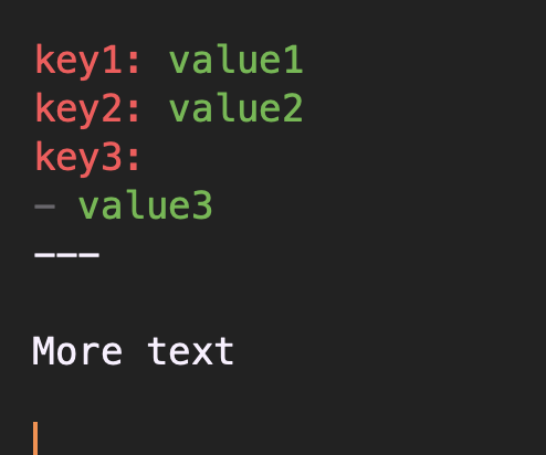

A bit tricky, but possible. I would create a rule that matches the key: value, but also looks ahead to only only match if there is a --- out ahead of it.
These example example patterns:
    "match": "(?s)(\\w+: )([^\\n]+)(?=.*^---)",
    "exclusive": false,
    "comment": "key: value pairs in front matter",
    "captures": {
      "1": {
        "scope": "color.red"
      "2": {
        "scope": "color.green"
    "match": "(?s)(\\w+:\\n)(- )([^\\n]+)(?=.*^---)",
    "exclusive": false,
    "captures": {
      "1": {
      "2": {
        "scope": "markup"
      "3": {
Create results like:
