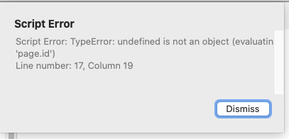

But I´m having some trouble, I put in the wrong info in the input fields and now I´m trying to correct it but every time I run the action I get this now (see image)
I have tried delet-ing the action and installing it back, but I get the same thing.
Can you give me any tips?

The action provided by @moggy1972 was not working because:
  1. Notion API requires to add notion version to request header now, not sure when they started doing that;
  2. The author left test code in the script, which overwrites the page index proveded by the user.
Thanks Vincey - I’ll sort that out. I think the notion version thing has been a requirement for new integrations from the start of June, and will be required for all integrations from 1 July.
