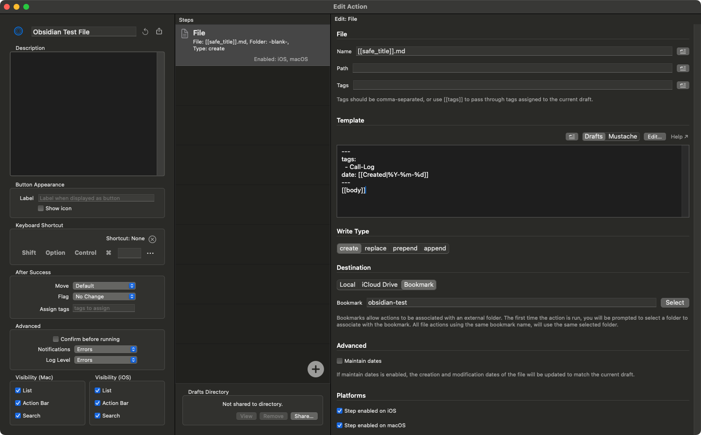

Setting up an action like this:

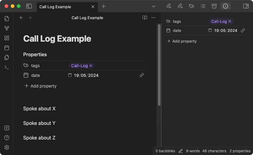

Gives me a note in Obsidian like this:
If you (or anyone else), did want to transfer Drafts tags to Obsidian tags, adding a script step like this ahead of the file creation:
let strTags = "";
if(draft.tags.length > 0) strTags = "\n" + draft.tags.map(x => "  - " + x).join("\n");
draft.setTemplateTag("YAMLTags", strTags);
Means you can then use this line in your content template to put the Drafts tags in as Obsidian tags.
tags:[[YAMLTags]]
