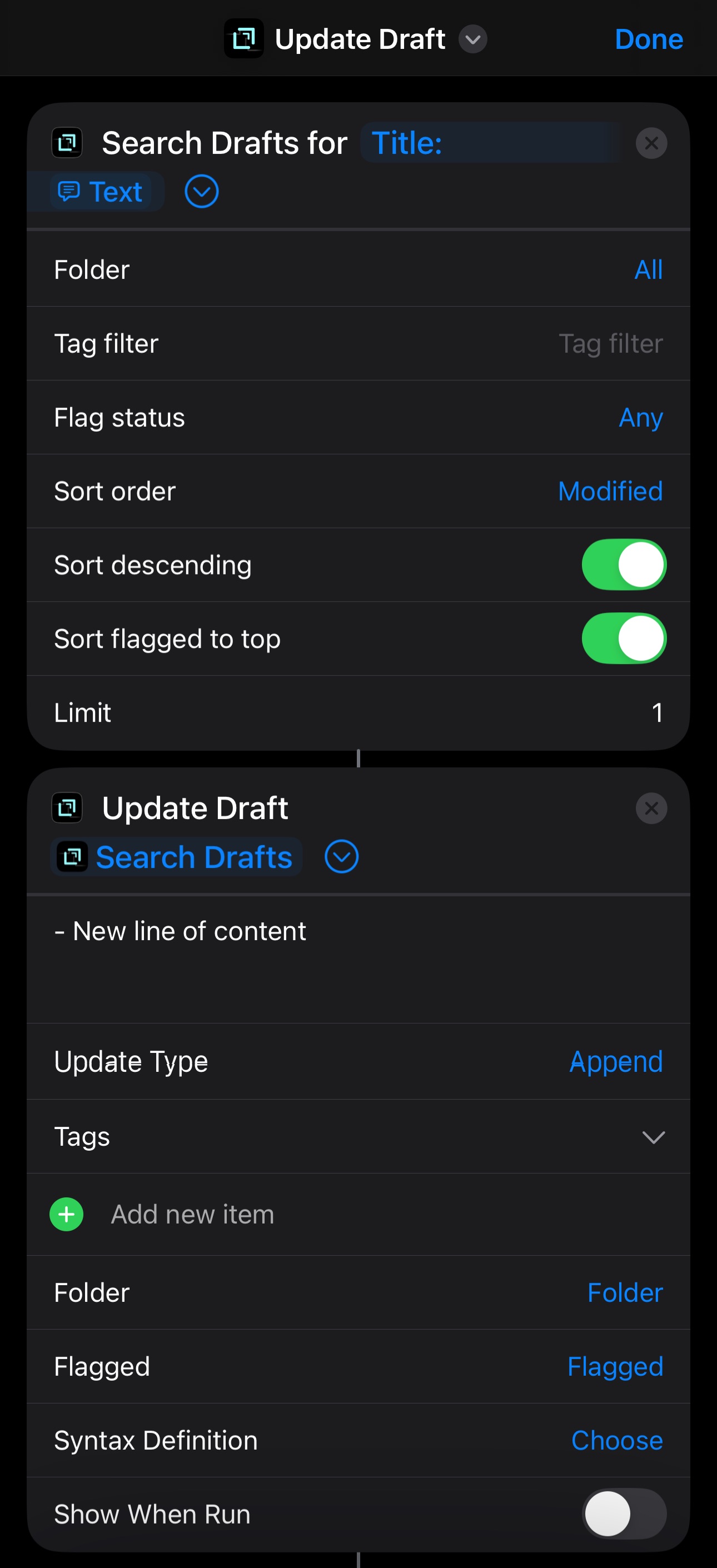

Just to note you can tell a search action in Shortcuts to only match against draft titles using the standard Drafts query options.
So you could have something like the excerpt shown below, but feeding your chosen text in prefixed with title: for the search input, limited to 1 result, and then the draft result out of that would be passed to your update action as you describe in your original post.
Brilliant, worked perfectly. Interestingly, the “title:” syntax doesn’t seem to affect “Update Drafts” that still returns all drafts with the text anywhere in the draft, but adding the “Search Drafts” step is easy enough and does the trick. Thanks!
