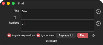

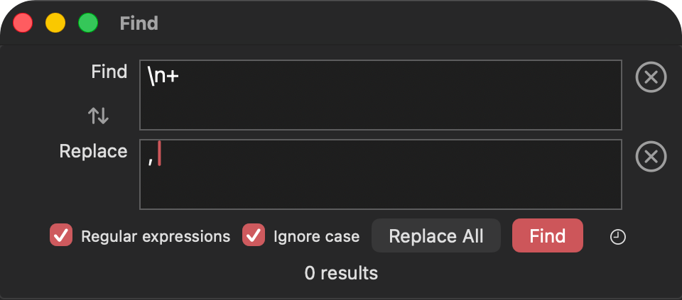

Drafts has advanced find and replace features, so if this is just something you need to do now and then, they should suffice. Using “Regular Expressions” enabled, you could do something like this:
If you want an action to run that cleans up a draft like this because it is something you do regularly and want to automate, it would be a script that uses Javascript to make the replacements, something like:
