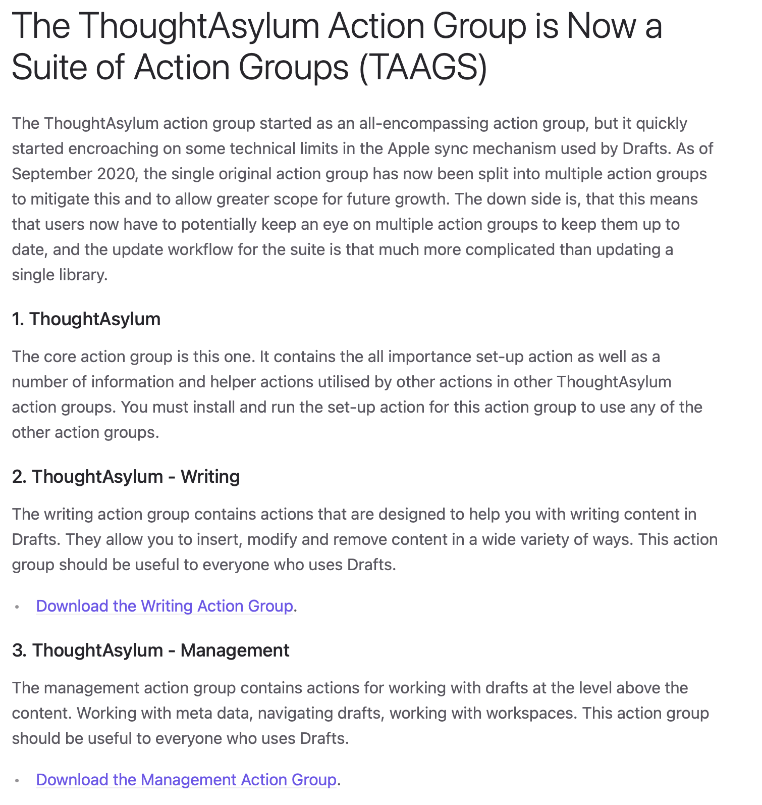

I’m trying to install the ThoughtAsylum Drafts Library and I understand that I need to install the core action group which provides a JavaScript library for the other related action groups. The problem is that I can’t find the link to download this core action group. I’ve attached a screenshot of the ThoughtAsylum page in the Drafts action directory for reference.
I must be missing something basic.
Any suggestions?
Charlie
That is the page in the directory for the core group itself. If you scroll to the bottom of that page, there is an “Install” button.
The links are out to the other related groups.
Wel,l I knew it was something basic. Thanks

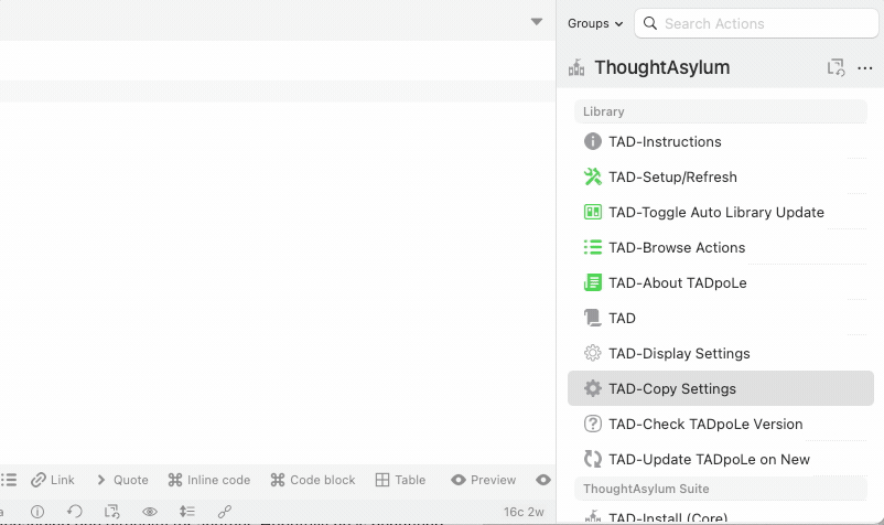

Having installed that core action group, you also need to run the TAD-Setup/Refresh action from within that group. The action downloads the necessary JavaScript libraries for the other actions.
From the ThoughtAsylum website:
First of all, before you use any of the ThoughtAsylum action groups, you must run the TAD-Setup/Refresh action in this action group. This action will download some JavaScript libraries, one of which the vast majority of actions in the set of ThoughtAsylum action groups are built on.
Hope this helps.

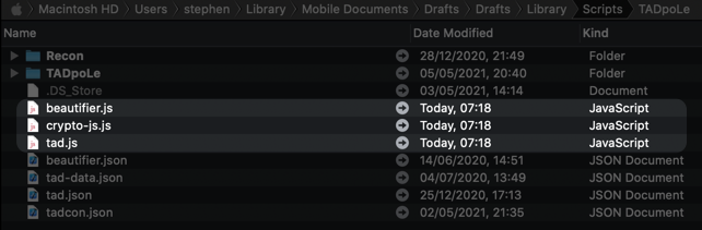

It would be worth looking in your iCloud Drive at the Drafts/Library/Scripts folder just to see if any of the library files are in there.
I’ve not had anyone else report an issue with this as yet, and the process hasn’t had any changes applied to it for several releases. Maybe there is a local issue? Maybe you have an edge case of some sort?
So, what to do? Here’s what I can suggest at this point.
  1. Check you have a Library/Scripts/ folder. I’m pretty sure that it is standard, but there is always the chance that for some reason it did not get created. If it is not there, create it, and then run the TAD-Setup/Refresh action and see if the JS files get populated into the folder and if you can run the actions.
  2. If you have another device to try this on, then I would suggest that as an option. The library files get stored in iCloud, so you should be able to trigger on one device and see the results on all devices. Then same re-test as above.
  3. The heavy-handed manual approach. Download the files directly and put them into the folder structure. For convenience, I’ve bundled the latest collection of the library files from the tadpole.thoughtasylum.com website into a single ZIP to download.
Do let me know what you find, do and the result. The process should not really take any extra troubleshooting, so if there is anything I need to consider and adjust to cover the set-up, I’d like to do so. I dare say that I’ve shaved a few corners for the sake of speed in the auto-updating, but I probably have some wiggle room if I need to add directory existence checks/creation for example.
It wasn’t there but when I created it in iCloud and ran the TAD-Setup/Refresh action it created the files and now my actions are working! I’m new to Drafts so it’s possible that I did something wrong along the way. Thanks for the troubleshooting!
