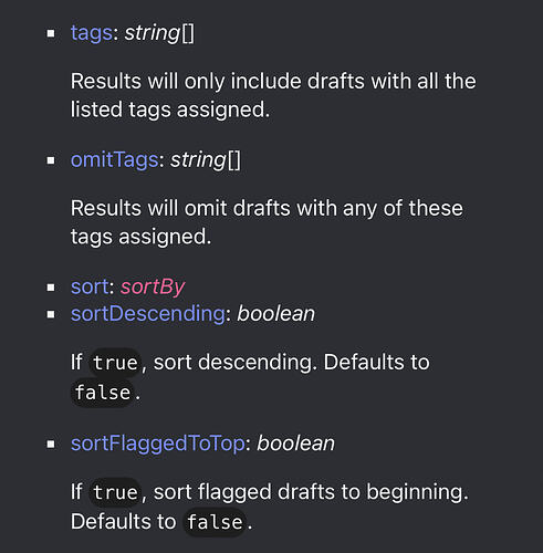

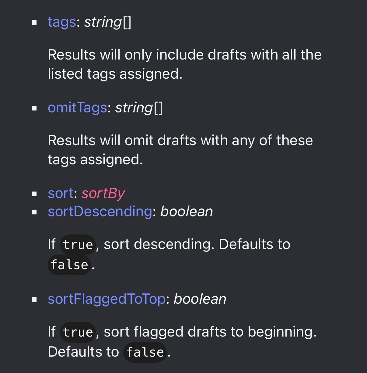

sylumer is right, but the documentation does not make it clear how many of the parameters are mandatory. I think “filter” is mandatory and the ones from “omitTags” on are optional, but I’m not sure whether or not the “tags” parameter is required.

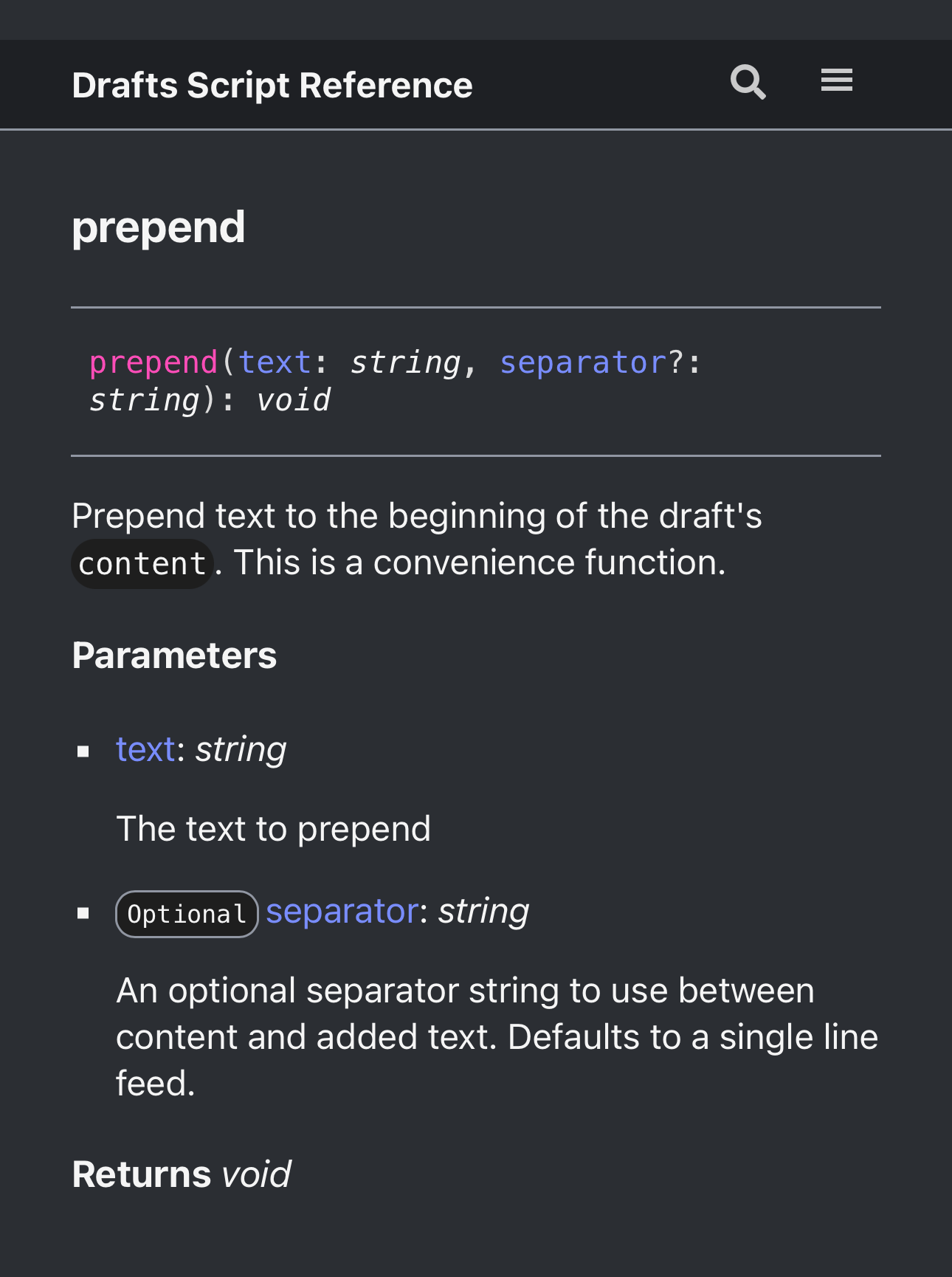

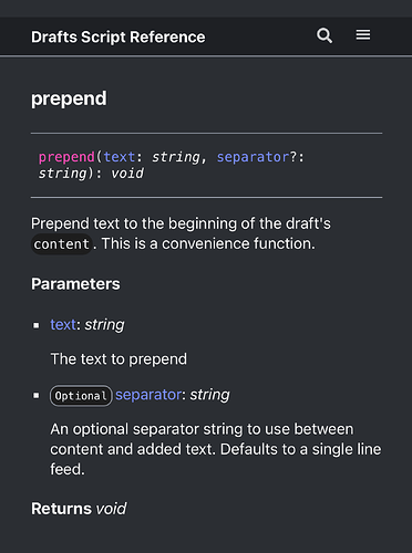

In the docs, a question mark in the parameter definition marks the parameter as optional and TypeDoc then flags it as optional like this.
None of the parameters for query are marked as optional. I have therefore always specified all of the parameters when using it.
Could the documentation be wrong? Yes, and given this started working, I assume there is some defaulting going on. If they are explicit, great. If they are implicit, then it is debatable and the parameters should not be considered optional.
The documentation may be incorrect for the query function, but I think the documentation is pretty clear for anything that is being marked as optional.
According to the documentation, sortDescending and sortFlaggedToTop defaults to false. It would seem that tags and omitTags defaults to [] and by providing a default value it is implicit that the parameters are optional.
