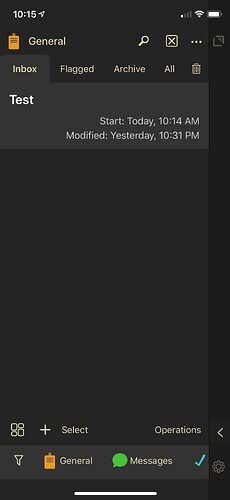

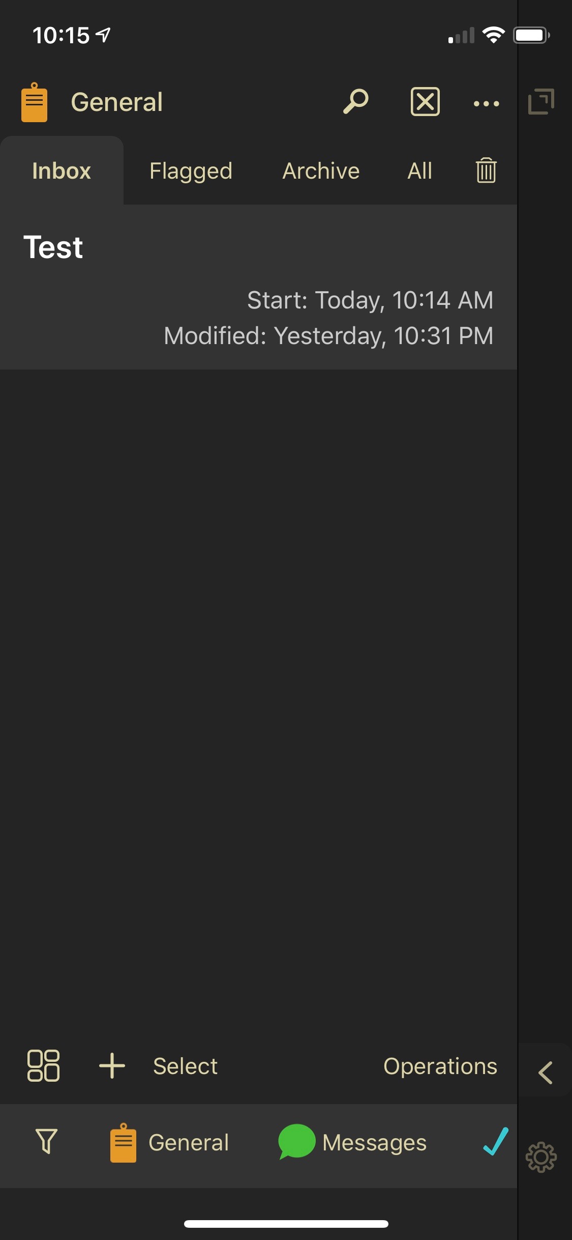

I have a draft called “Test”:

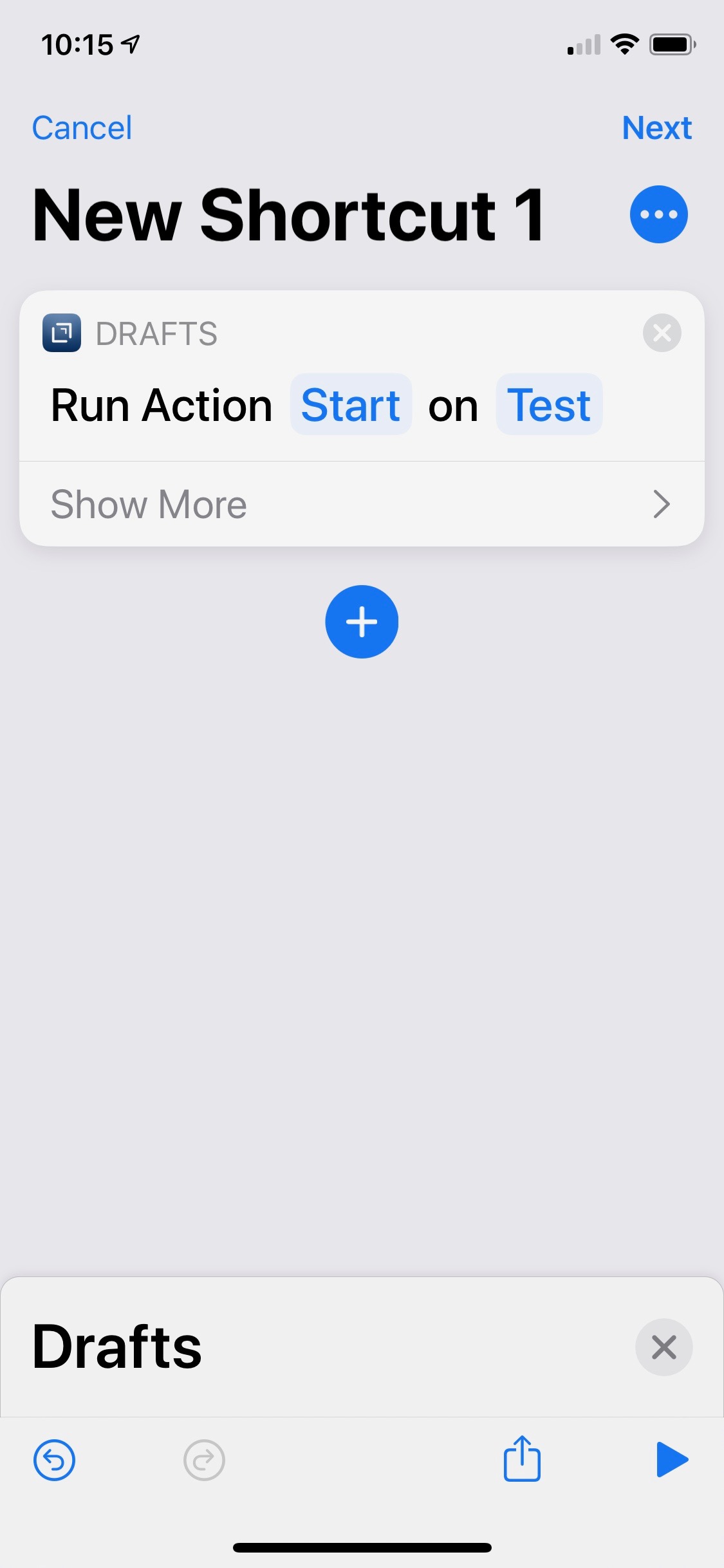

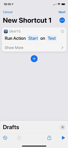

I have a shortcut that runs an action “Start” (which just inserts some formatted date text) on that draft:

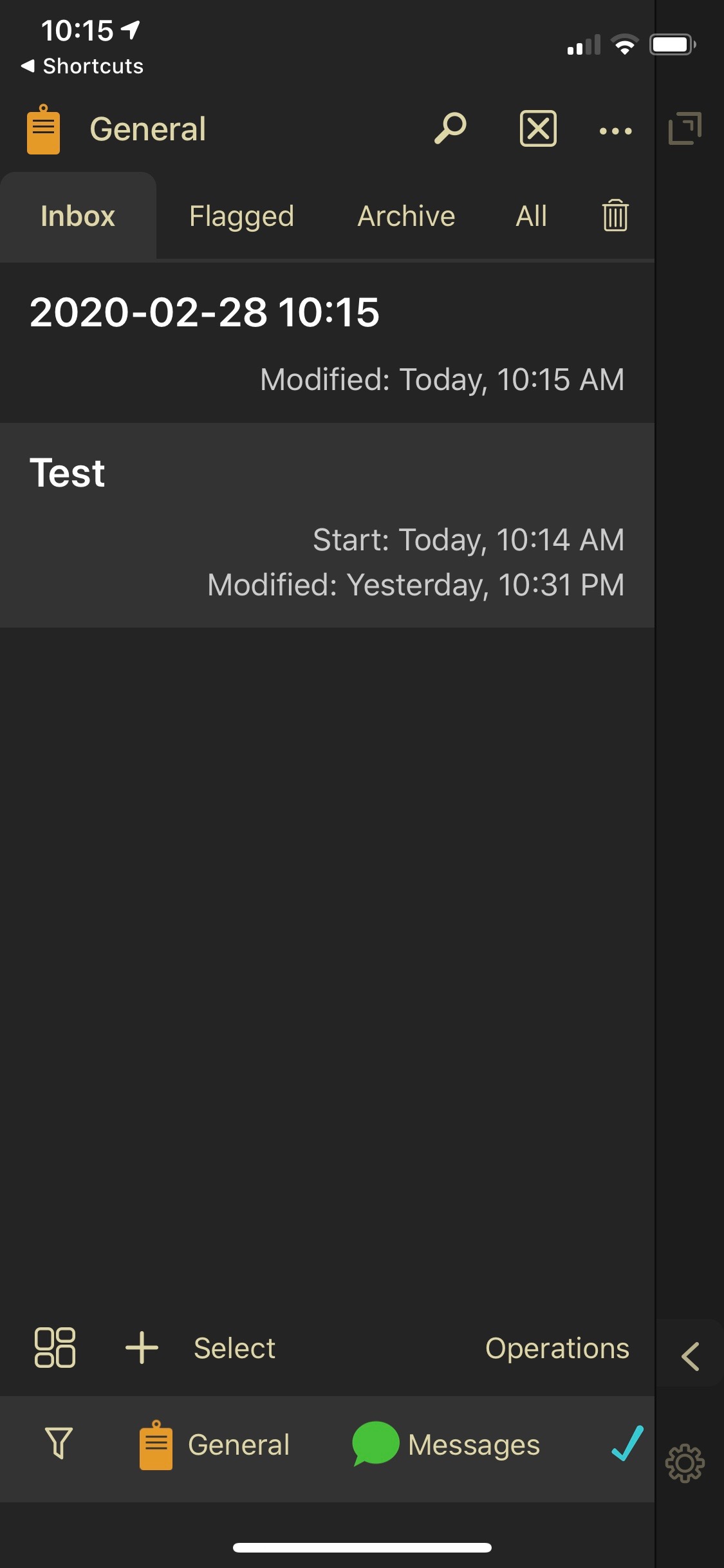

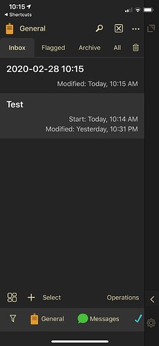

But I end up with a new draft with the text in it:
