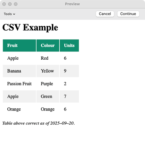

When I run the preview, I then get the following preview that includes the styling.
When you run your own, check under tools for the Copy HTML option. You can use this to grab your HTML and see if it looks how you would expect it to.
For this example, it looks like this.

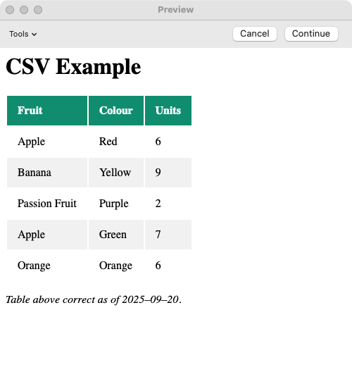

My eventual solution was
function previewMarkdown(title, mkdContent) {
	let mkd = GitHubMarkdown.create();
	mkd.format = "html";
	let htmlContent = mkd.render(mkdContent);
	draft.setTemplateTag("THETITLE", title);
	draft.setTemplateTag("THECONTENT", htmlContent);
	let allHTML = draft.processTemplate("[[template|Preview-HTML-FL.txt]]");
	HTMLPreview.create().show(allHTML);
where Drafts/Library/Templates/Preview-HTML-FL.txt is similar to the default Preview HTML template but with my preferred style modifications and these two template calls:
