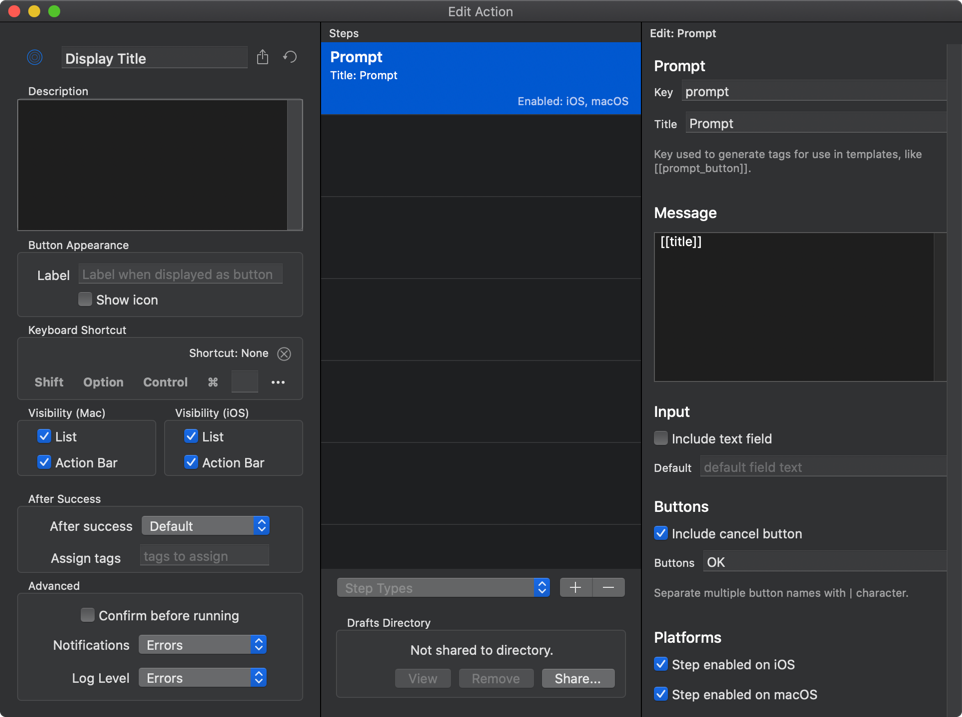

Let’s start with a simple action to display the title of a draft. I’ve specifically made it an example action that is not purely script-based so that we are forced to call the separate action rather than just bundling it into one set of code. More efficient to code as one I suspect, but this is the more generic case.

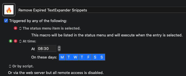

Personally, I find it ridiculously easy within Keyboard Maestro to manage scheduled macros, so if you happen to be a Keyboard Maestro user, I’d look at that. For example, here’s one that clears out my expired temporary TextExpander snippets each morning.

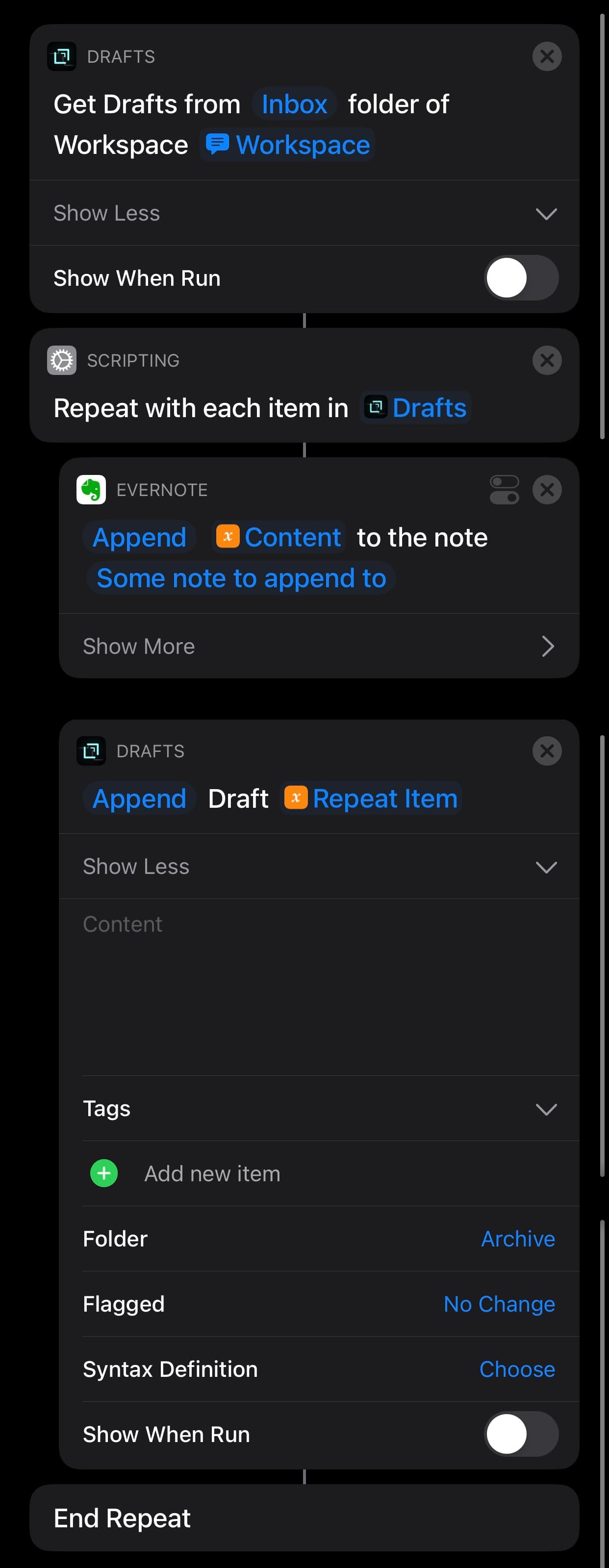

Therefore, I need to actually automate and execute the Action on iOS. I’m assuming Shortcuts is my only option here… does anyone by chance have an example Shortcut flow which retrieves Drafts from a Workspace, and iterates through each draft, applying an action to each one? Thanks.
EDIT: Actually, I think I got it, it’s pretty simple. But I still welcome any other example Shortcuts to take a look at!
It should just be a get drafts from workspace action, followed by a repeat with each item on each of the drafts to get the draft ‘objects’. Within the repeat, use an append to Evernote action utilising the content of the draft being processed by the loop (use the repeat item variable, set as a draft, and specifically to the content). In the same loop, I would also consider moving the draft to say the archive so that it would not get processed multiple times in succession should you not manually intervene.
Something like this perhaps.
Your device would need to be unlocked to do this. Therefore, I would consider just having a reminder pop-up with a link to run an action within Drafts to do the processing and sending to Evernote. It should run more quickly that way as it would not be switching between apps, and so be less disruptive to you.
