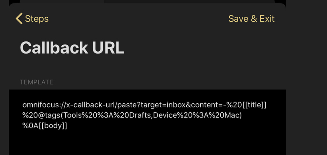

Let’s see if this helps then.
I’ve started with a simple draft where as derived from your URL above, the draft title is taken to be the name of the task and the remaining content (the draft body) the notes for the task.
The next step I’ve taken is to use the Taskpaper (flavoured) transfer of data into OmniFocus. This utilises the paste URL scheme parameter as per the OmniFocus URL scheme reference, and the OmniFocus Taskpaper reference guide.
The x-callback URL I’ve put together looks like this:
omnifocus://x-callback-url/paste?target=inbox&content=-%20[[title]]%20@tags(Tools%20%3A%20Drafts,Device%20%3A%20Mac)%0A[[body]]
This example includes several things of note:
The resulting x-callback action then looks like this.
When run, this then produces the following in my OmniFocus inbox.
Hopefully that should give you a reasonable walkthrough of what you would need to do to revise your own custom action to set your own tags.

If you can URL encode it, it should be fine (ref).
Look back at my earlier example.
Note the URL encoding %20%3a%20 is " : ", which is the separator for nested tags, and is incorporating spaces too.
Also remember that if you have a problem, you can try things out and analyse them. Try adding a test task with a root level tag that has no spaces or emoji. Then add the variances in individually to check compatability, or where you have an issue.
General note that Drafts template engine can also do that encoding for you if you wrap the parameter value to encode in {{ }}…or, using the new Define Template Tag action step to create a parameter for the URL, which can make things a little easier to read.
For @sylumer’s example, if you create a two step action, the first a "Define Template Tag with the tag name “content”, and the template:
- [[title]] @tags(Tools : Drafts,Device : Mac)
[[body]]
This create a new template you can use in the callback URL step after it, like:
omnifocus://x-callback-url/paste?target=inbox&content=[[content]]
