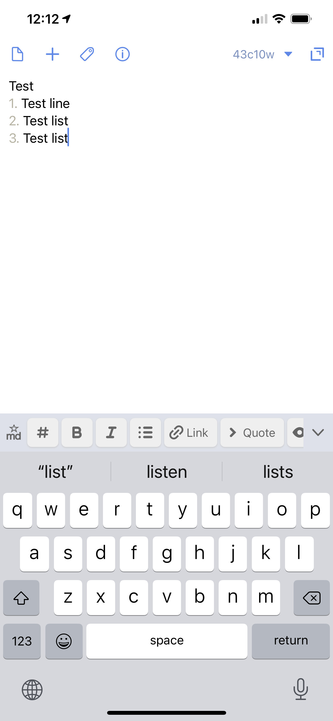

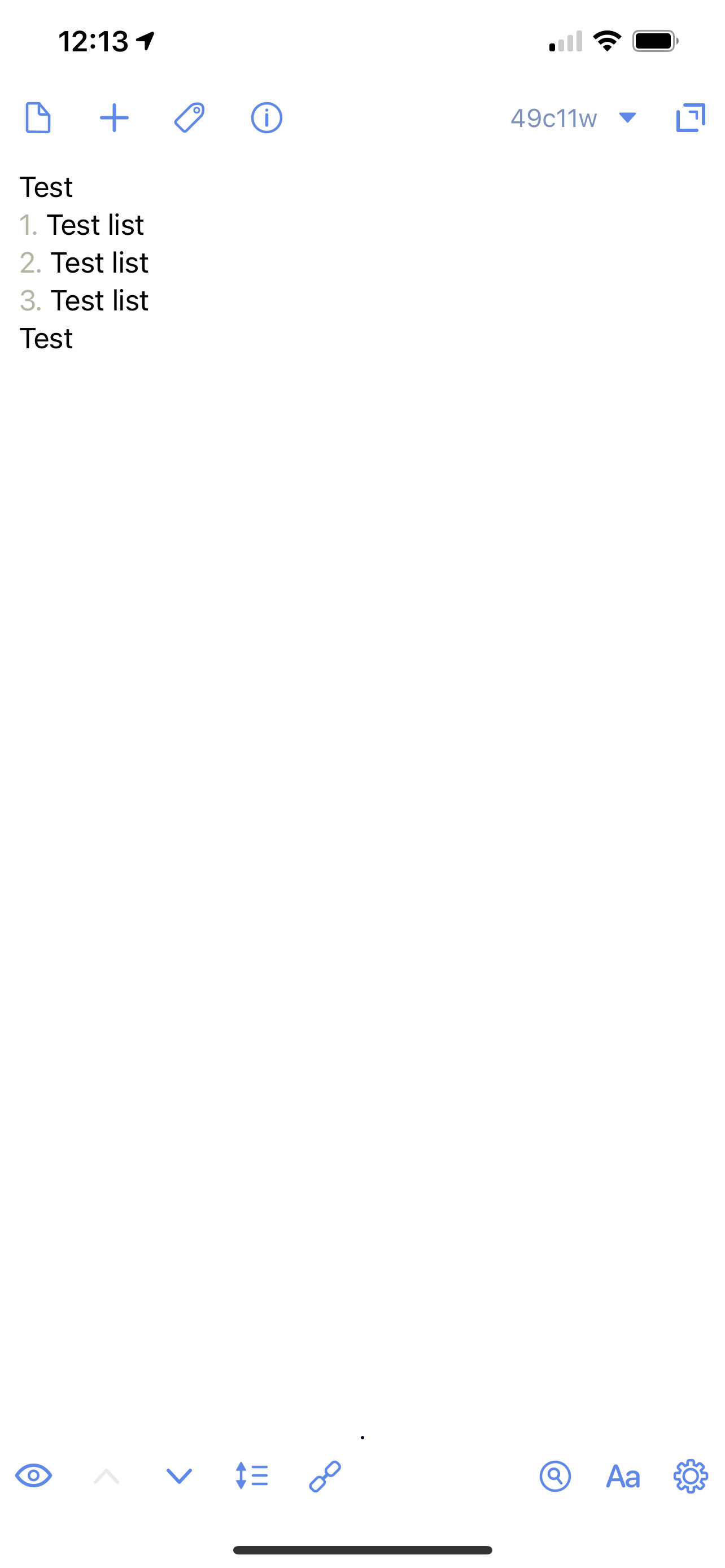

Here are 2 screenshots from my iPhone showing what I’m entering
This is what it ‘should’ look like and used to render as…
This is what the first image with the stamp 1213 looks like:
This is what the second image with the stamp 1212 looks like:

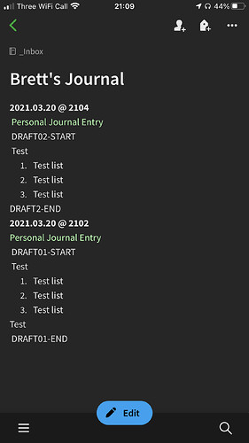

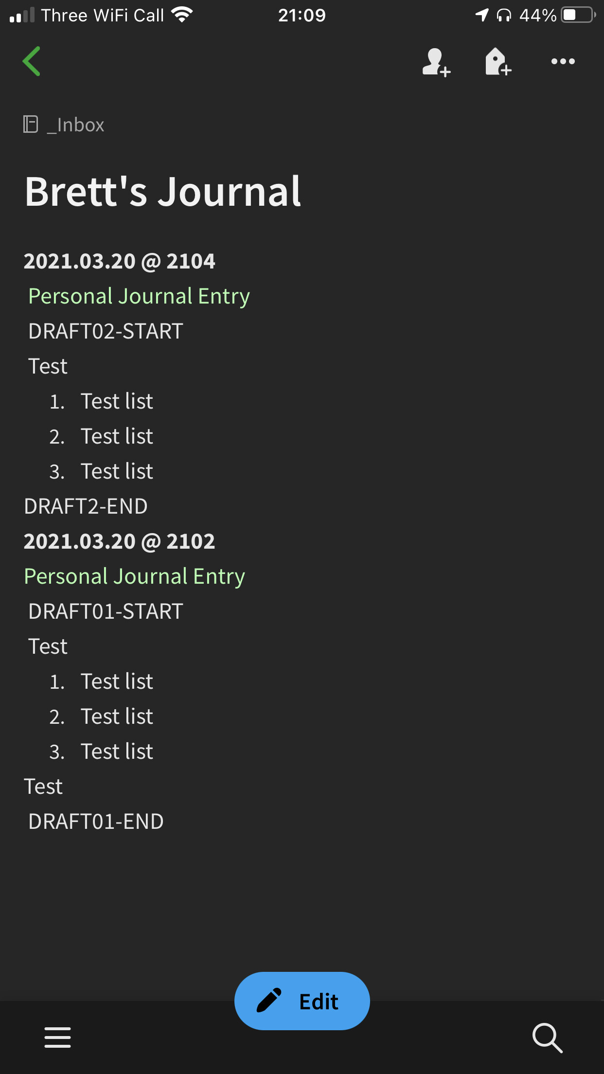

The result I got from Evernote was this:
Which looks exactly like the result you are after and used to get.
