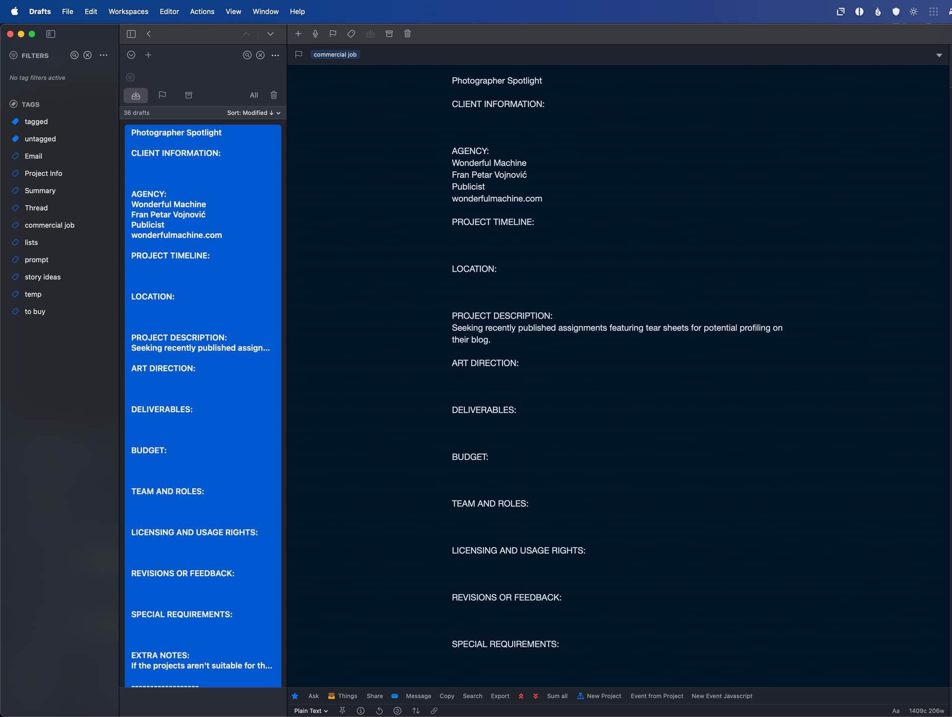

Yeah, sorry for not providing more details initially. It was a late night of frustration.
Here’s a screenshot of the final Draft with a fake email. “Photographer Spotlight” is the title GPT suggested and is formatted correctly as a single line. However, when you view the list of drafts on the left, that one draft occupies the entire screen because most of the draft is interpreted as a headline in Drafts.

In your AppleScript, you are using return, which only inserts a carriage return (\r) character. You want linefeed, which inserts a new line (\n) unix-style line feed.
Try:
tell application "Drafts"
    set fullContent to jsonResult & linefeed & linefeed & "------------------" & linefeed & threadContent
    make new draft with properties {content:fullContent, flagged:false, tags:{"commercial job"}}
end tell
If you care to read one, here’s a more detailed discussion of this difference
Ahhhh, Thanks a lot, with some adjusted code that fixes my problem!
