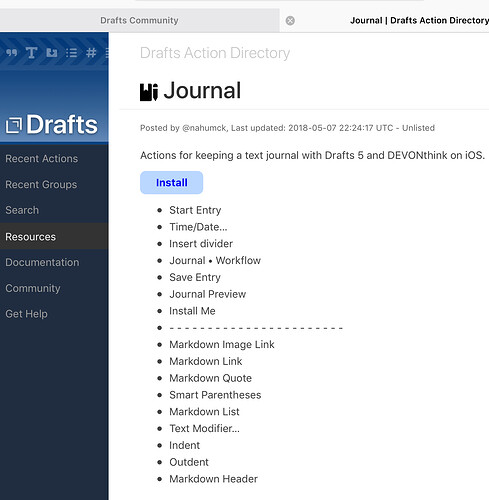

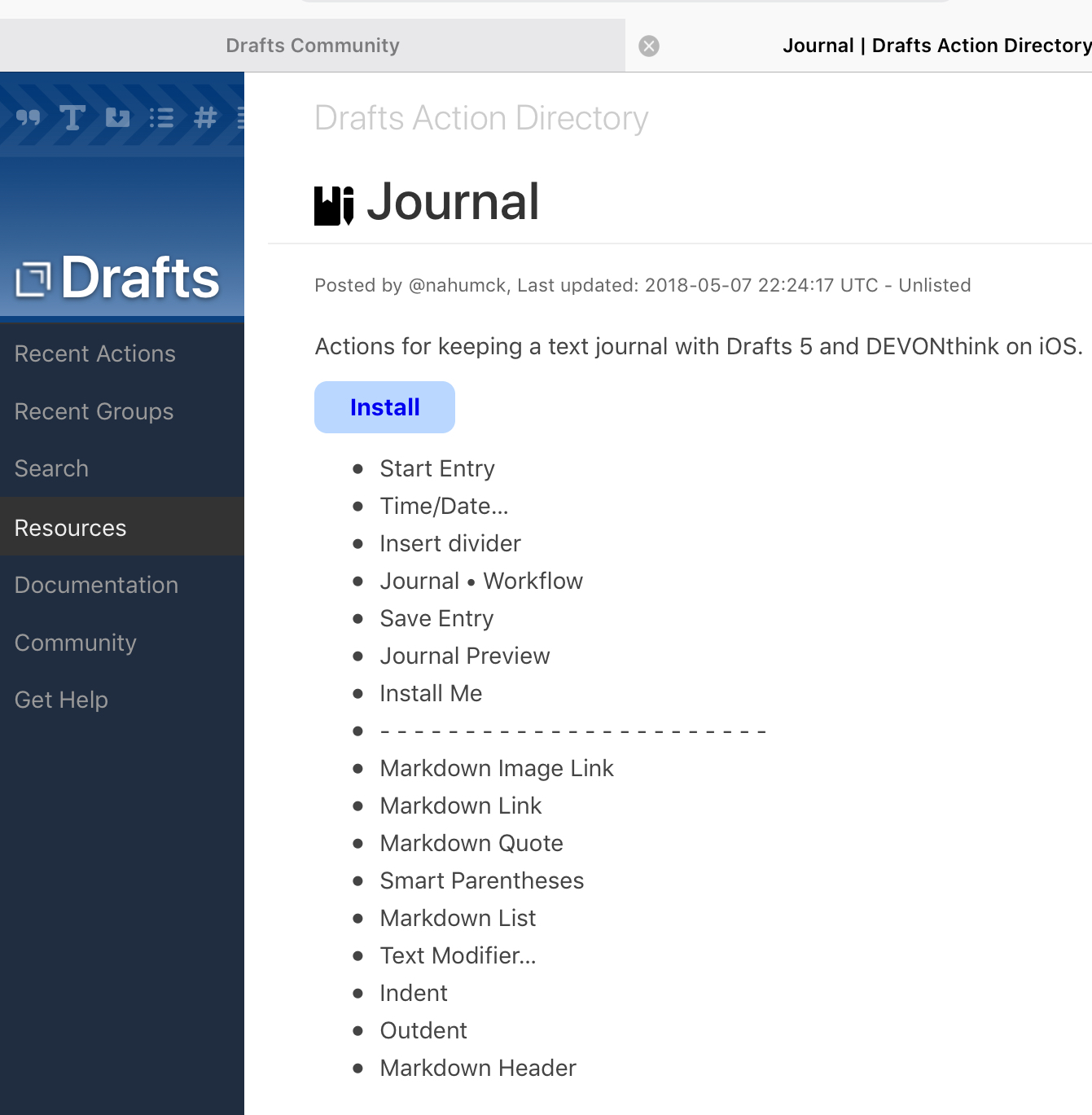

Here is where I’m finding the Journal Workflow action.
I installed this Action Group..
From that screen shot I can see that the action is unlisted and without the URL there’s not really anyway to obviously find it unaided. However I can also see that it is one of Tim’s, so he should be able to help you with it.
Over to you @nahumck :smile:
