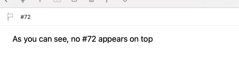

Another issue: when I write a new Draft, if I go to tags, they don’t appear automatically. Any idea why that isn’t happening?
I’m new to Drafts actions, so forgive me for the very newbie question. :slight_smile:
And here’s an example when I write a new draft note. Nothing appears.

Based on your subsequent post, what exactly are you expecting to happen?
Are you expecting a new draft to automatically populate the tags area as you type in a hash tag? If so, that isn’t how tags work - they are tags, not hash tags, hence the action to run to add tags to the draft based on hash tags in its contents.
If it is when you select to add a tag, I think it should start by displaying the most recently used tags, and then as you type it should filter from the entire set of tags or create a new one where there is no match.
You don’t need to type the hashtag in there (as the hashtag is not included in the tags you added to your note so typing just „71“ should be sufficent to make related tags pop up
