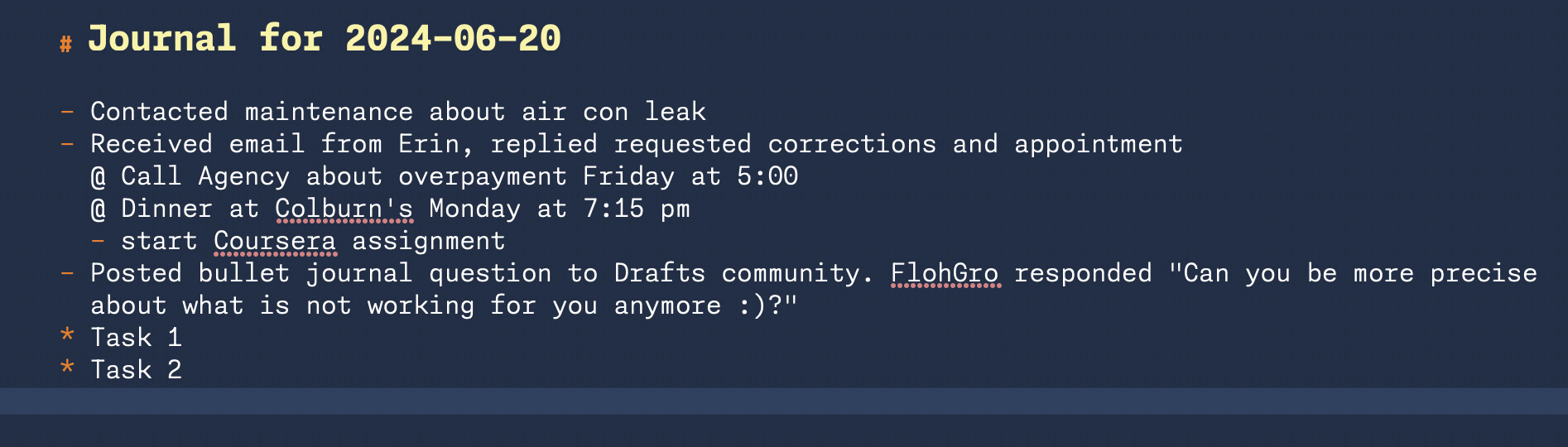

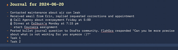

Below is the actual journal text: the bullets are hyphens “-“ in original text
  • Contacted maintenance about air con leak
  • Received email from Erin, replied requested corrections and appointment
    @ Call Agency about overpayment Friday at 5:00
    @ Dinner at Colburn’s Monday at 7:15 pm
    • start Coursera assignment
  • Posted bullet journal question to Drafts community. FlohGro responded “Can you be more precise about what is not working for you anymore :)?”
    • exercise
    • complete application
