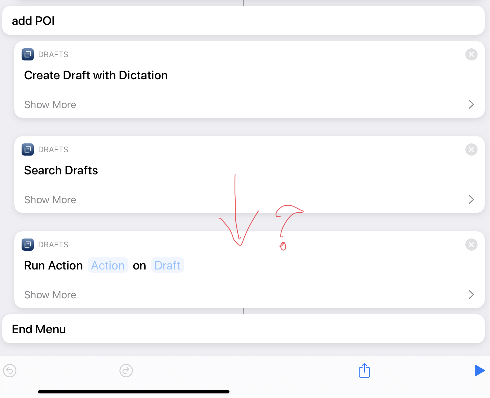

one of the thing i cant sell wrap my head around is how to create a dictation draft and then run a draft action on it? i can create a draft using the create draft with dictation action but how does one apply an action on that draft just created when the dictation finishes?

After creating the Draft use a Search Drafts step in Shortcuts to get the most recent draft. That should be your dictated one. Then pass that draft object to your Run Action on Draft step.
Another approach is to use a Run Action with Text to trigger a Draft action that ignores input. That Drafts action could do the dictation and the subsequent actions steps you want. i.e. just ask Drafts to do everything in one go.

This is where I got stuck now. I can as you suggested launch the dictation, search for the note but cant seem to run an action on that note:
Do I need an additional connector?

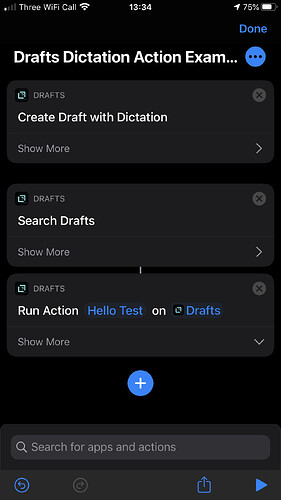

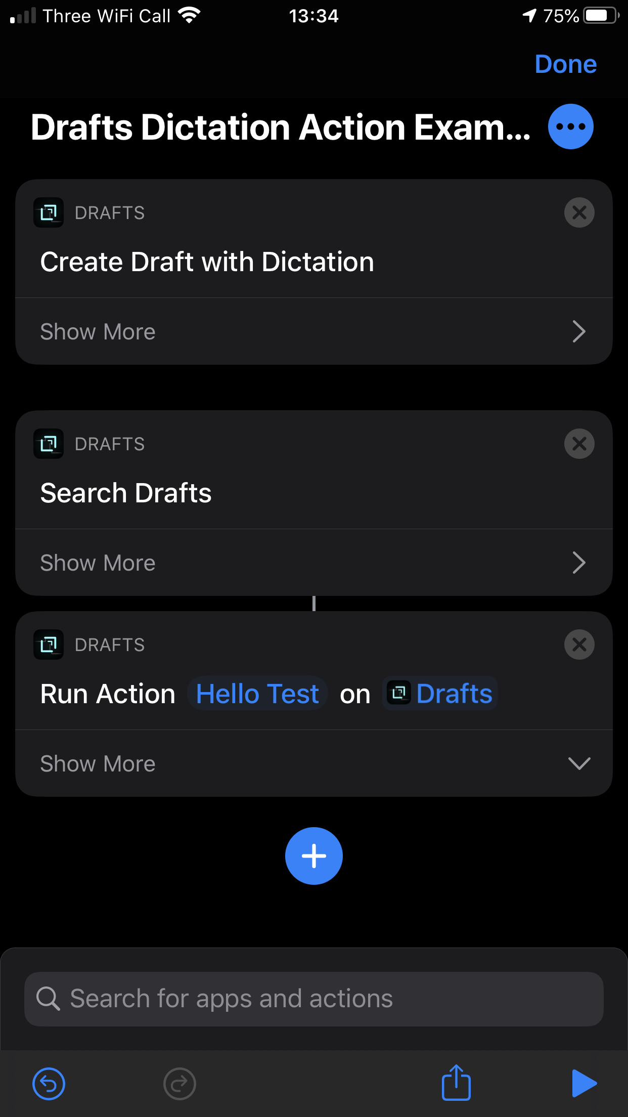

Press and hold on the parameter. Select the magic variable option. Select the output from the search.
For example this one would run an action called Hello Test.
