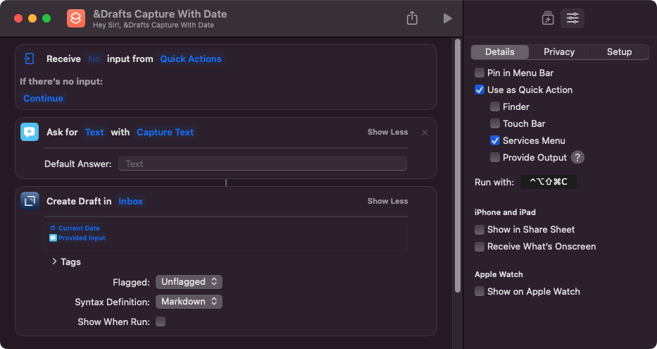

As noted above, you could build your own capture that saves to Drafts with a prefix of the date/time in whatever format you desire.
If you needed to build it out to let you select a draft to append to or tag things specifically, you could.
If you desperately need the functionality that the existing capture window offers and as such need to get the date/time into it in an automated fashion, the it is possible.

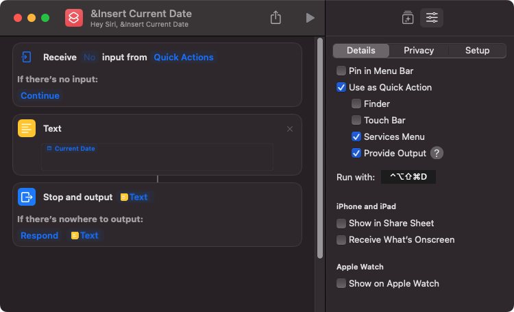

Failing the availability of other automation tools capable of utilising snippet/typed triggers, the next option would be to switch the trigger. For example, you could switch to a key combination.
Here’s an example of how you could achieve this in Shortcuts once again.

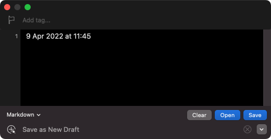

Press the key combination and the text appears like this, but again you can tailor it from the default output format.
