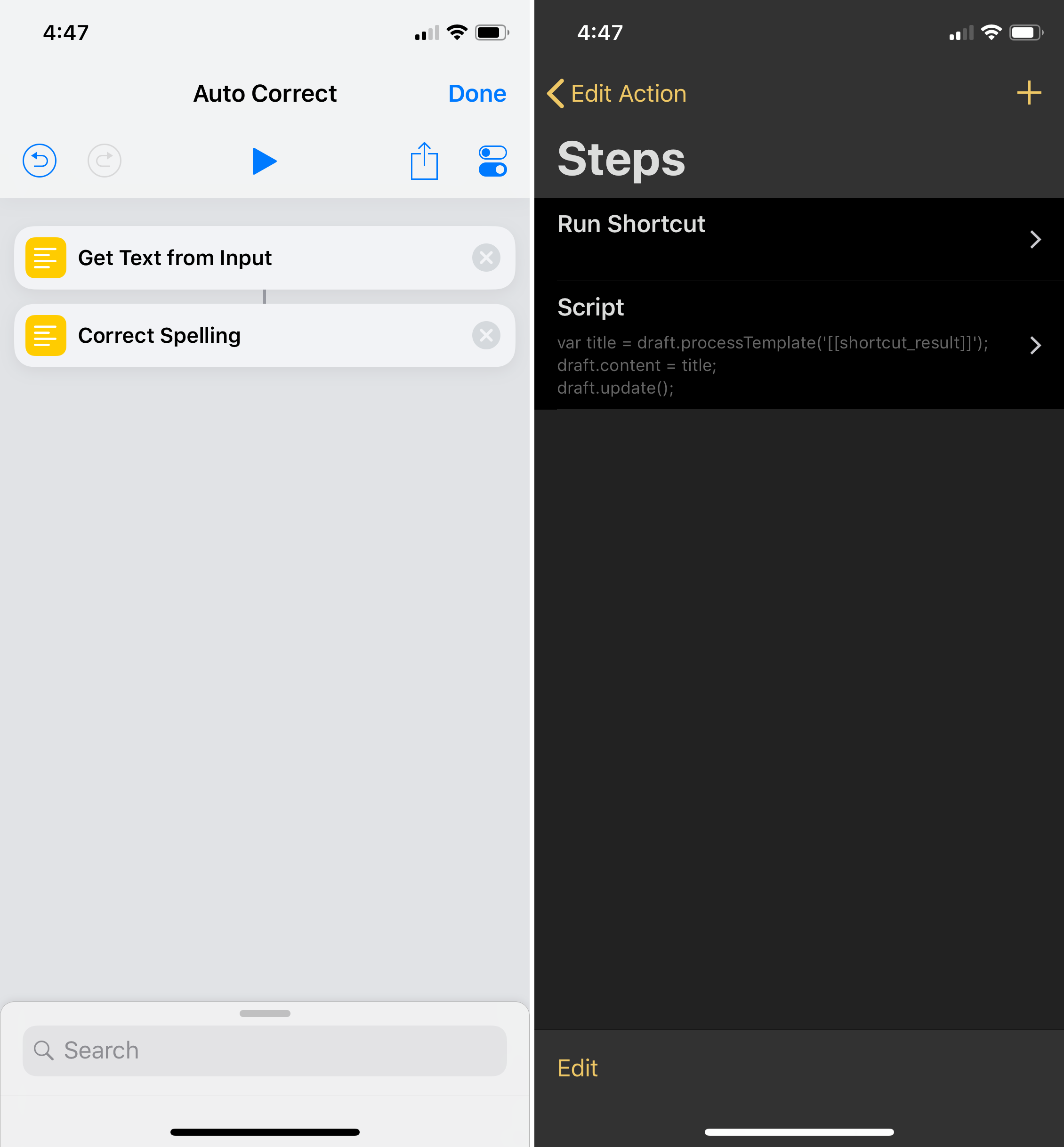

I have a workflow/shortcut I want to send text too, have the workflow do it’s thing and then output is text.
Is there a way to return to drafts after the workflow runs and use that outputted text? Currently I have the workflow save the text on the clipboard and the drafts action grab the clipboard but it feels like there should be a better way I’m missing.

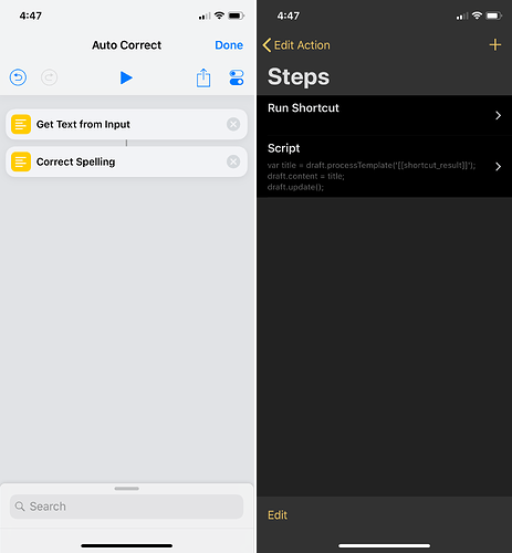

Thank you rose. I used [[shortcut_result]] and that works perfectly. It’s just a simple shortcut that calls its auto corrrect block and then replaces the original content of the draft with the result
