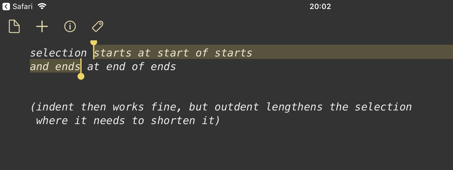

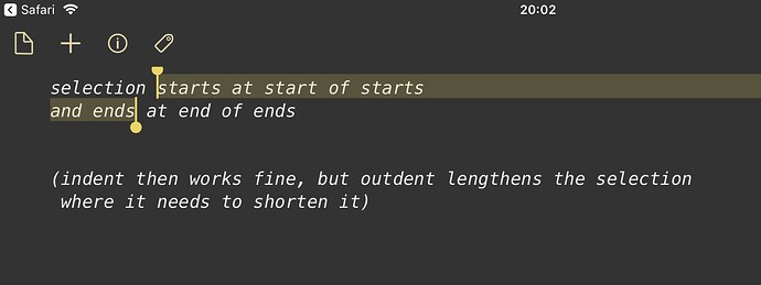

I think it was believed by @agiletortoise that this had been fixed in the current Outdent action:
but as far as I can see the 2018-05-30 19:14:18 UTC version still seems to lengthen the selection where it needs to shorten it – visible, if, for example we indent and then outdent with a selection like that below.
I find that I can fix it here by correcting a (+) to a (-) in the penultimate line. (Perhaps left over from a copy-paste from the source of the indent action ?).
ends with:
// update selection
let newStart = selStart - startAdjust;
let newLen = selLen + (indent.length * outdentCt)
editor.setSelectedRange(newStart, newLen);
but can be fixed, I think, by changing that plus in the penultimate line to a minus.
i.e. it should be:
// update selection
let newLen = selLen - (indent.length * outdentCt)
(it needs to be a minus because we are removing indents, and shifting the selection leftward)
