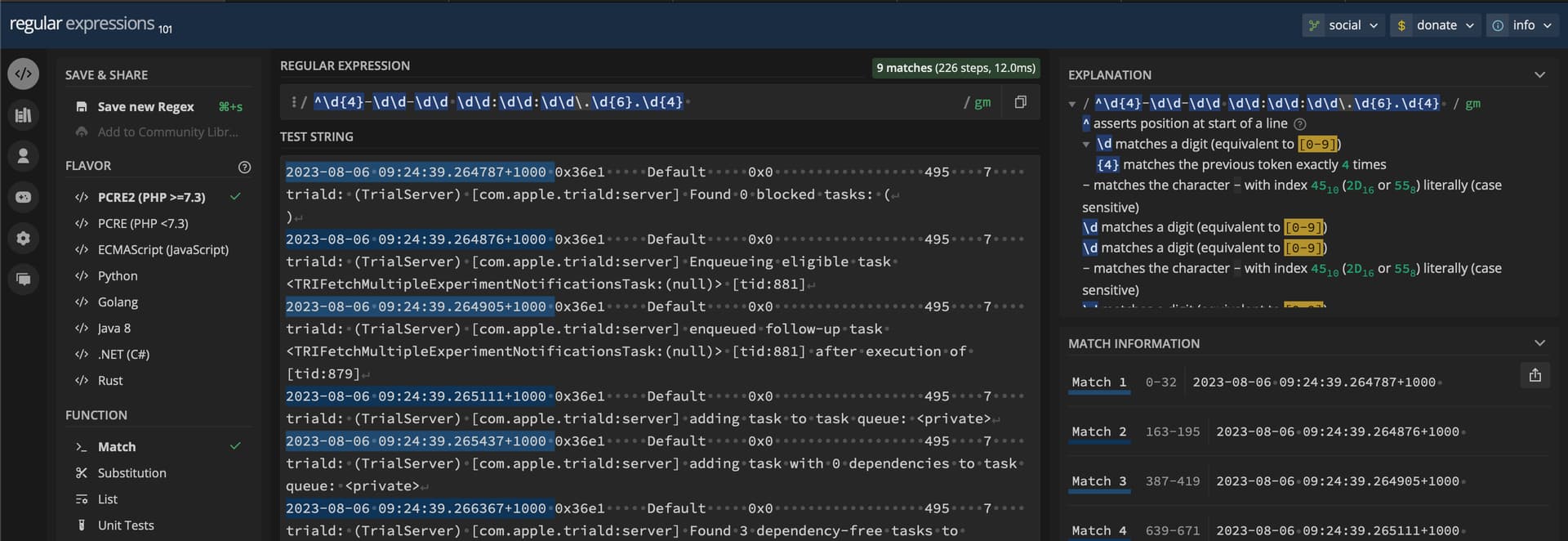

Looking at your notes on GitHub, “Stealthy Developer Mode” is a hack of app betas. I’m pretty sure that puts you in the camp of firmly unsupported use.
Okay, so I think you are pretty safe from “rat ninja” (BTW plurals for Japanese words like ninja would generally not have an “s”) - the only one I’ve come across is from TMNT and I’m pretty sure he’s not on this forum :wink:
The details you are describing are part of the action - you would be able to note this by exporting and URL decoding your own actions in Drafts. Many objects in computing get a UUID to ensure uniqueness.
My advice is…
  • Use the App Store version of Drafts - don’t use exploits.
  • Use the action that has been shared with you - I’m pretty sure it does what you asked for.
  • Confirm the regex works using a regex tool and your sample data - regex101 is a good one.
