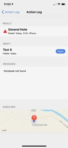

Re Draft’s error sending to Evernote:

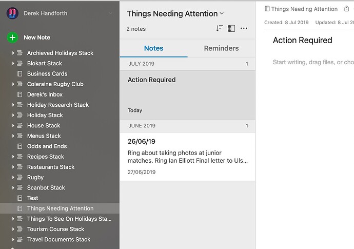

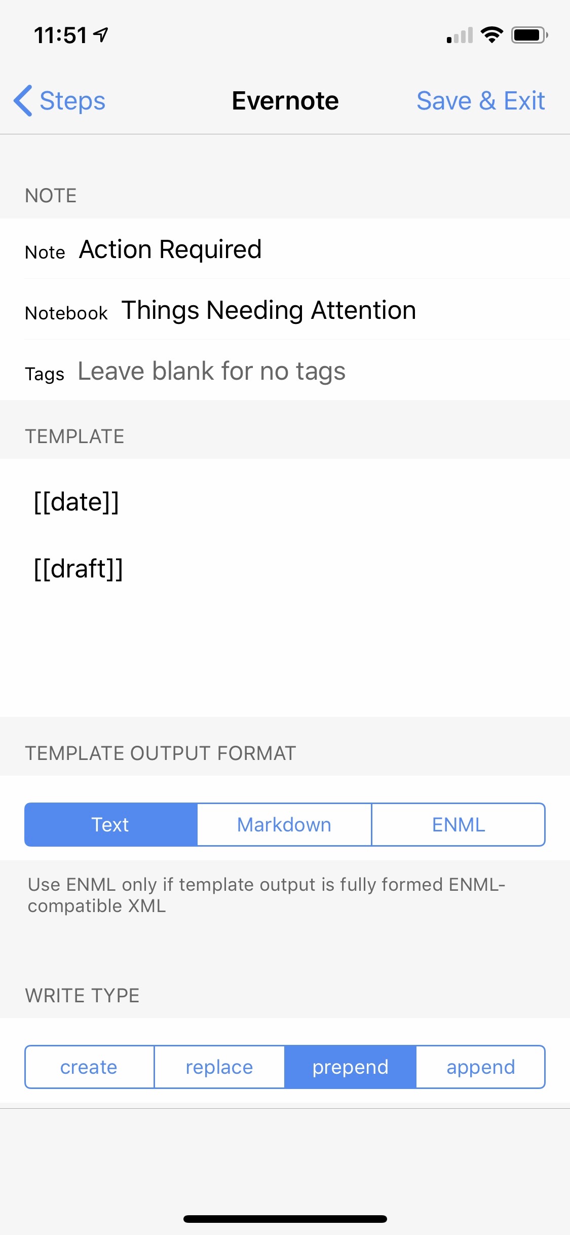

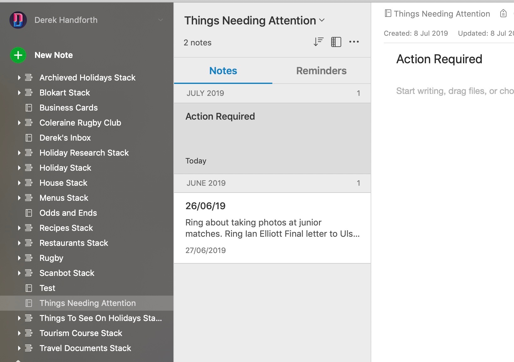

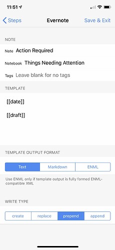

I have set up a new notebook called Things Needing Attention. In the Draft’s action I have selected Action Required as the note and Things Needing Attention as the notebook Text and Prepend, but still get the same error message.

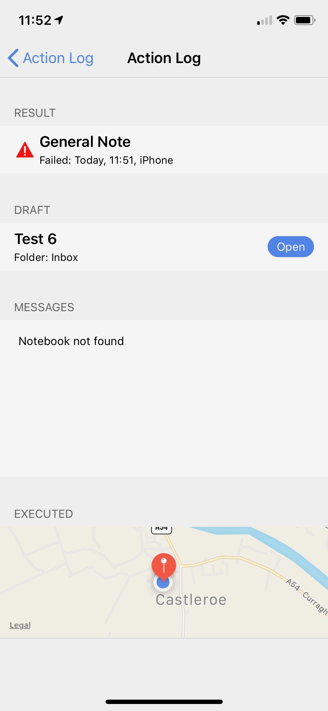

I attached three screen shots. As you can see the notebook is set as Things Needing Attention When you look at the error the Notebook shows Inbox, which doesn’t exist and Notebook Not Found.
Many thanks
Derek

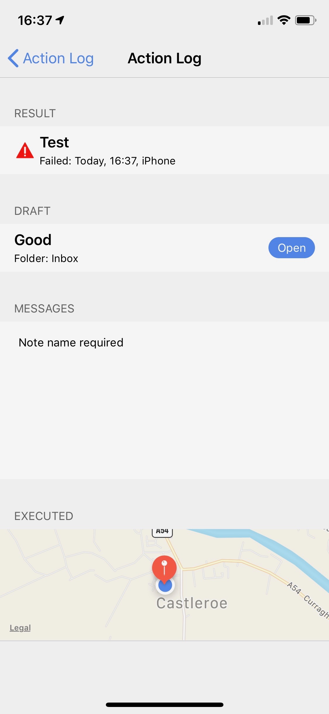

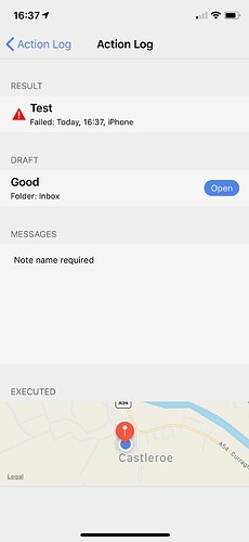

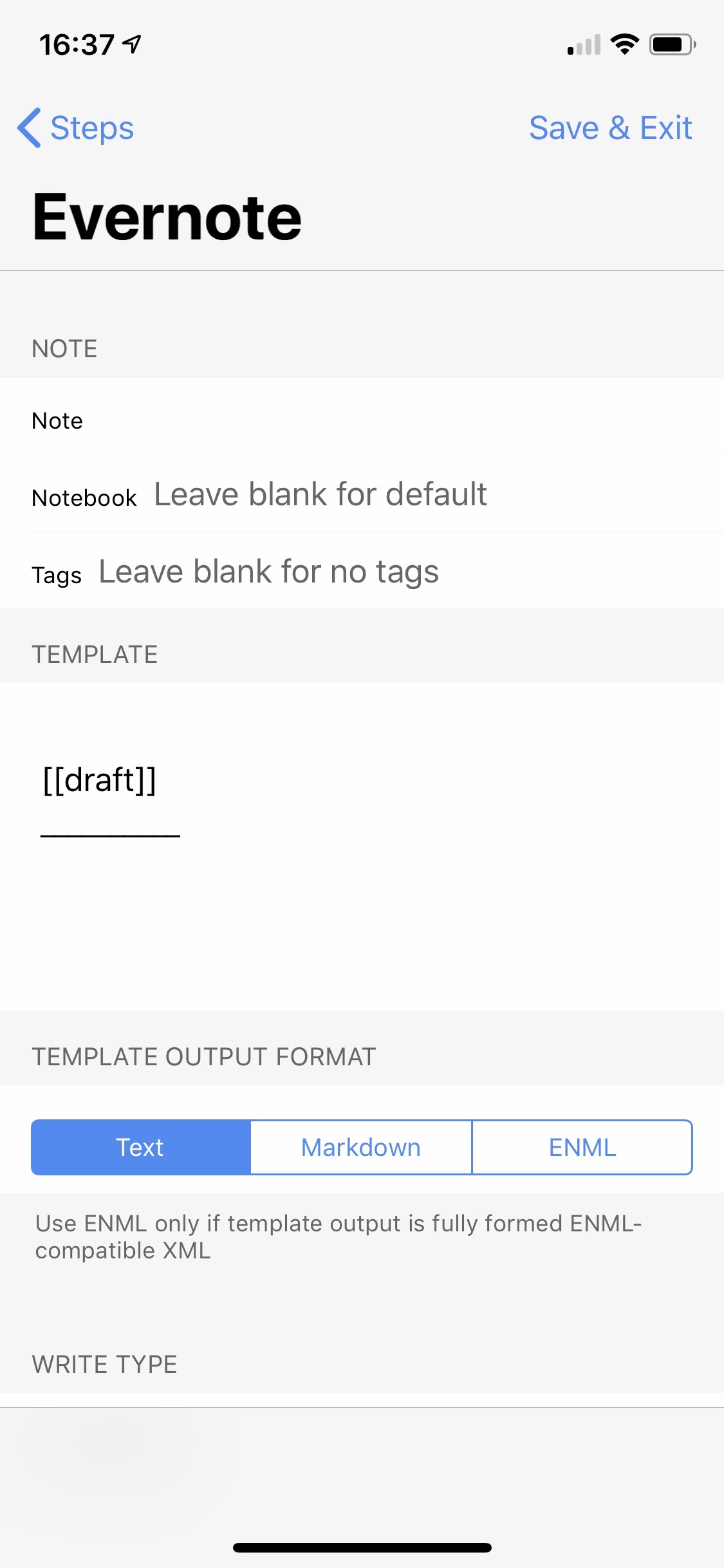

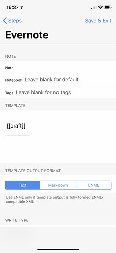

Latest try. Named action Test. Left Note and Notebook blank. Text and create.
Error result. Running. iPhone 10xs 12.3.1. Evernote 7.11. Drafts Pro Latest version.
My suggestion was…
Your action was…
So going back to my suggestion, what happens if you just leave the notebook blank?
Note that the note name is mandatory and when you left it blank you received exactly the expected error for doing so.
Sorted. All my fault. When I checked the notebook name I finally discovered that ios had automatically added a space at the end.
