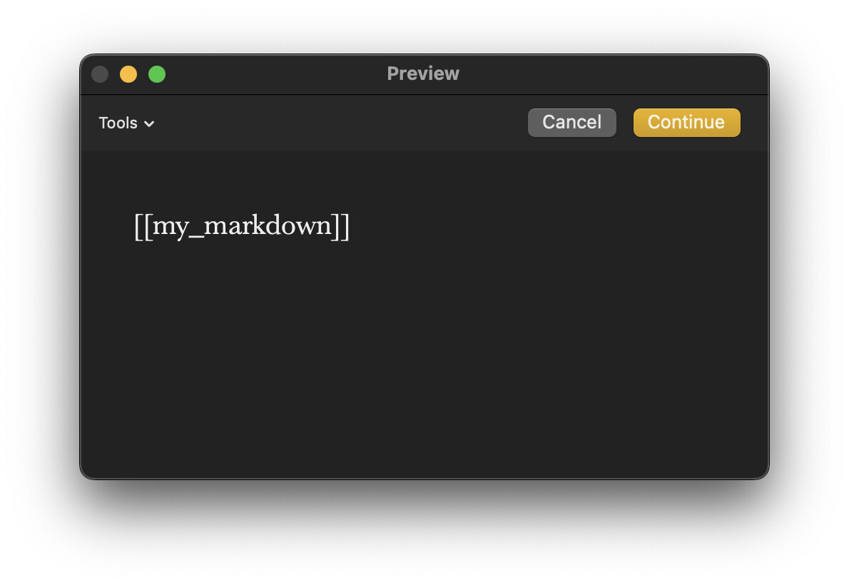

Unfortunately, I’m seeing an intermittent issue when I attempt to set the markdown within the code. Here’s a simple example:
const md = "## Title";
draft.setTemplateTag("my_markdown", md);
// Prep Markdown to HTML conversion using the MMD engine
let mmdContent = MultiMarkdown.create();
mmdContent.format = "html";
// Show the preview of the rendered content based on the content specified by tags in the action
let hpMain = HTMLPreview.create();
hpMain.show(mmdContent.render(draft.processTemplate("[[mdcontent]]")));

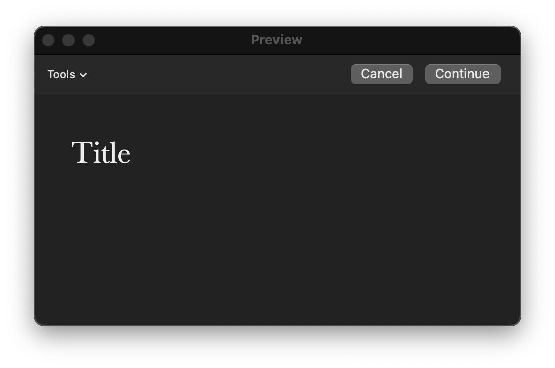

Sometimes the above yields:
But other times:
I haven’t been able to find a pattern. Could there be a timing issue? Or am I missing something fundamental?

Thanks again, @sylumer! Yes, that works consistently for me. It seems it’s really a matter of order, not so much a timing issue. Agree?
Agree; thanks, @agiletortoise!
In fact it seems that I don’t need to render the markdown in the code since %%[markdown]%% within a Define Template Tag action step seems to work as expected (assuming I order the action steps properly as @sylumer demonstrated above.)
