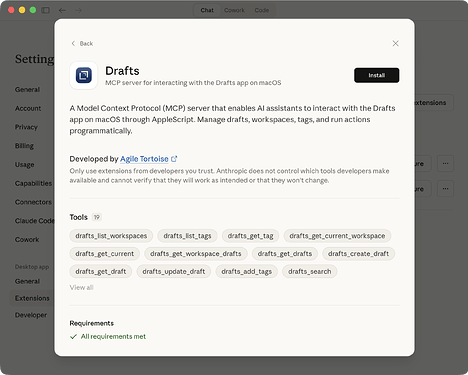

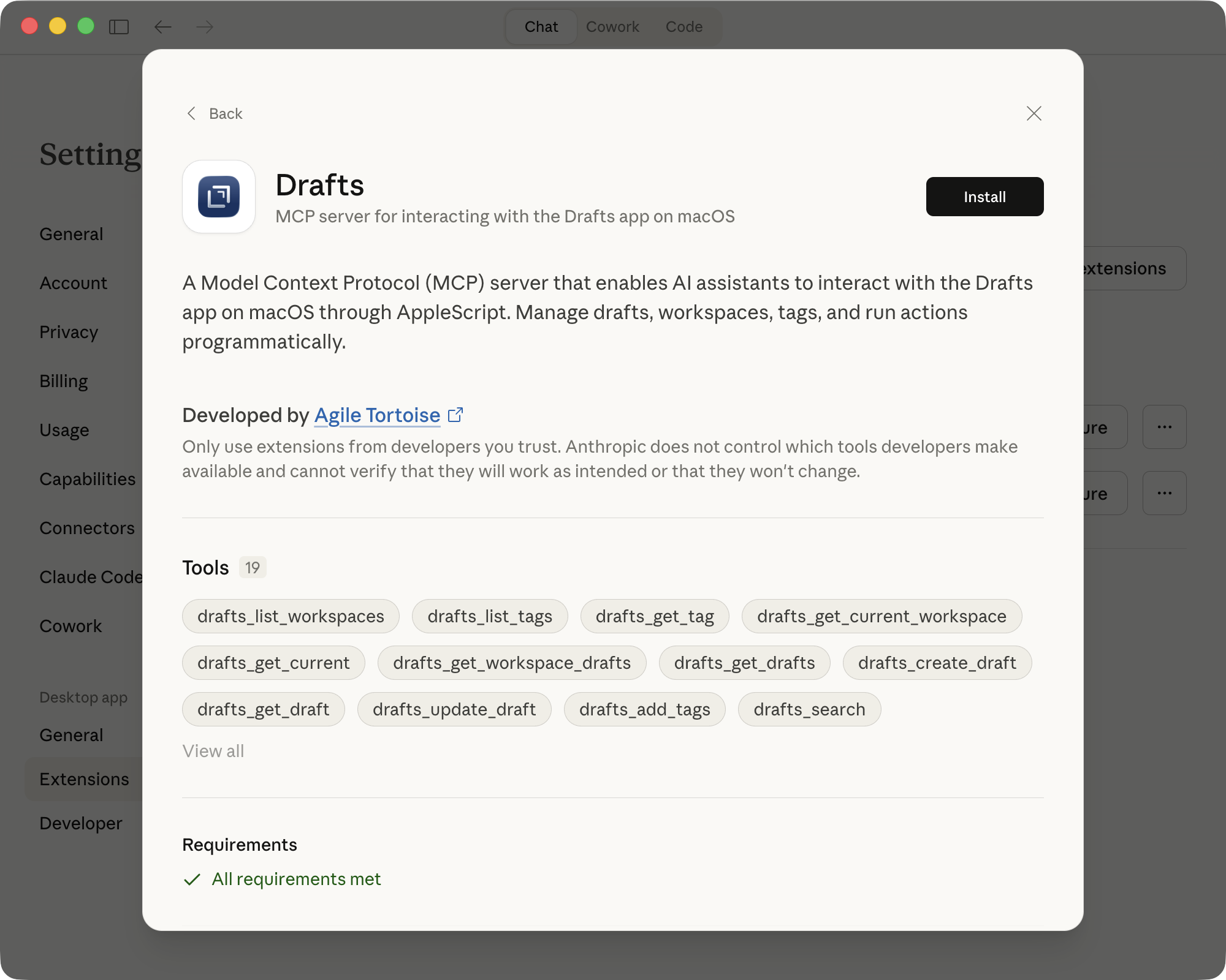

Quick Install for Claude Desktop
The Drafts MCP is available in the Claude extensions directory. In the Claude Desktop app on your Mac, go to Settings > Extensions and “Browse Extensions”, then search for “drafts”, and install the connector.

The Drafts MCP server is now available in the Claude Extension Directory for easier installation and updates. To install:
  • Open Claude Desktop on your Mac.
  • Go to Settings > Extensions
  • “Browse Extensions” and search for “Drafts”
  • Install the “Drafts” MCP.
