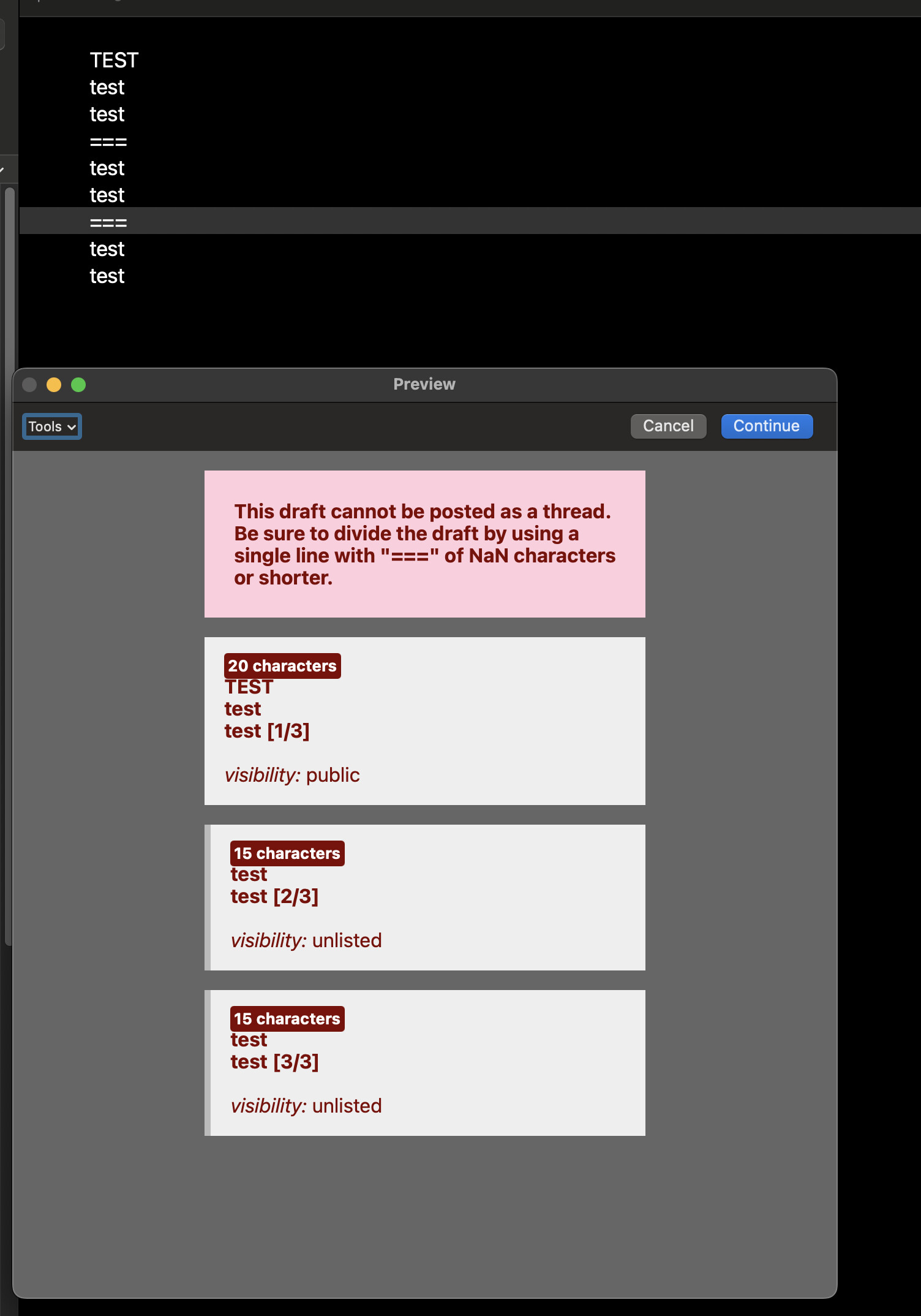

I’m trying to post a draft as a thread and I’m getting an error.
I’ve got a single line with “===” and it looks like it is splitting the post correctly, but it still complains that it can’t be posted. Any ideas?

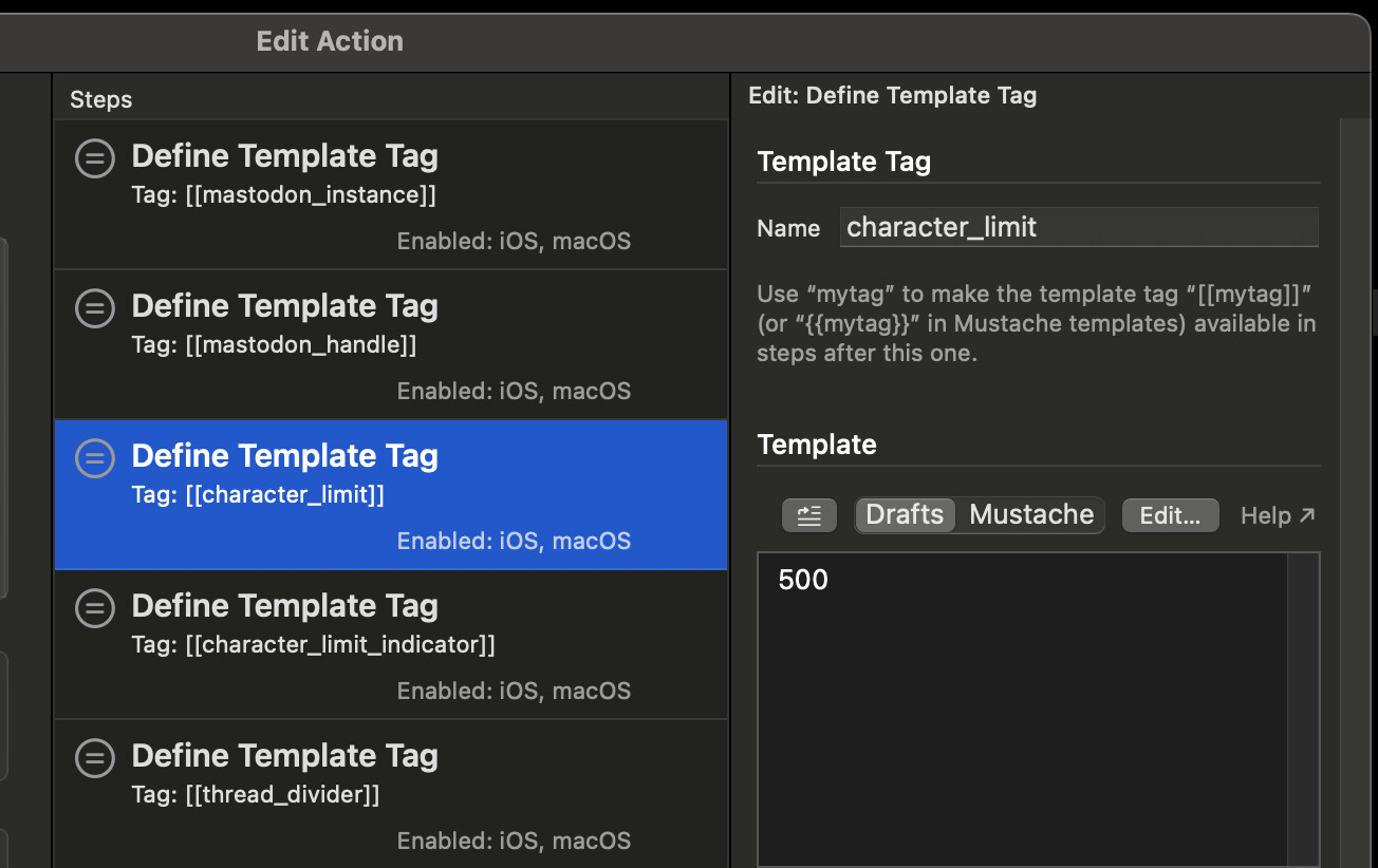

I’ve got all the variables set up correctly, including the max number of characters
Was just about to suggest that because that “NaN” is ‘Not a Number’, and the code looks like it references DraftodonSettings.characterLimit for this.
On chance you have a rogue space or anything in that template tag is there? Something that would stop the text being cast to a number.
Nope, no spaces in the characterLimit. I suspected that when I saw the NAN which is why I double checked that.
