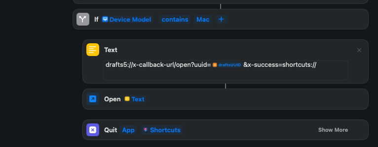

basically, want to give drafts it callback on the success of a shortcut without relying on stop and output. E.g.
drafts5://x-callback-url/open?uuid=draftsUUID&x-success=shortcuts://
What is the end result you are trying to accomplish? I don’t think that is likely to be what you want.
In that example you are telling Shortcuts to open a URL that is an x-callback…which will open Drafts, which will process the /open URL, then open the x-success callback URL - which, in turn, opens the Shortcuts app. Shortcuts will go ahead and proceed with its next step after opening the drafts URL, thus quitting itself. Depending on timing, it may just get opened back up by the callback URL. I don’t think that’s what you want.
Are you trying to just end a shortcut by opening a draft in Drafts and quitting Shortcuts? In that case, just use Drafts’ “Open” shortcut action, then quit shortcuts. No need for a URL at all.
so basically i have a shortcut that hits the todoist API for bulk task creation just because the flow there was more intuitive. even if I open drafts at the end before quitting shortcuts, the action still appears to wait for shorcuts to respond that the shortcut was a success. If I have a stop and output, the action succeeds. But the issue is that stops and leaves the shorcuts window open on MacOS which is super annoying.
