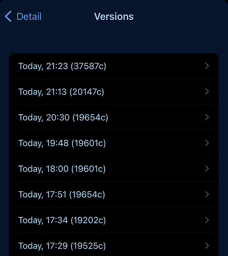

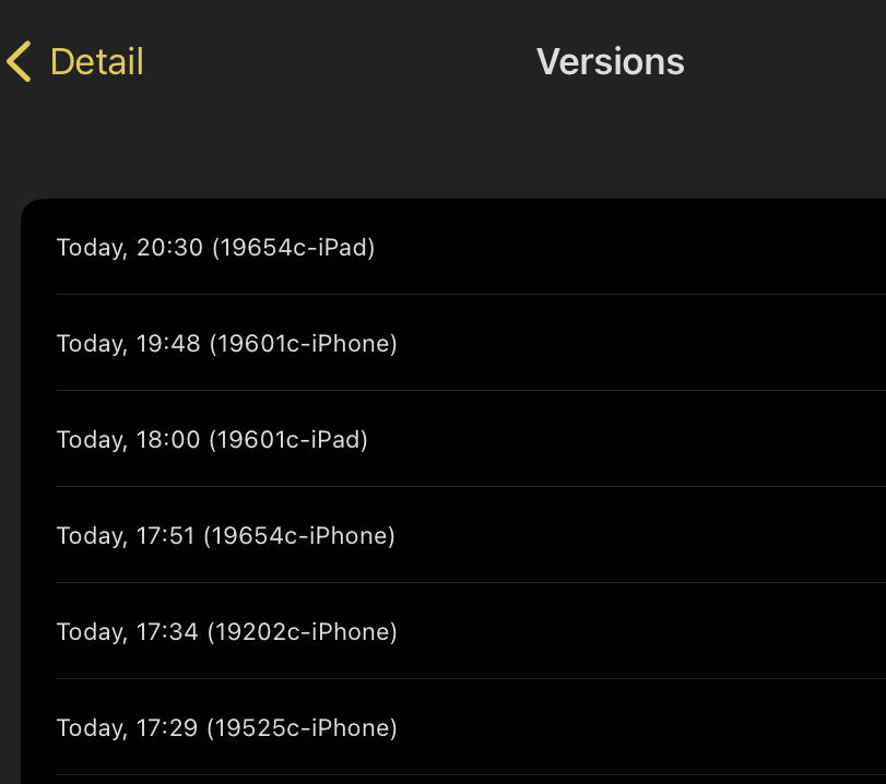

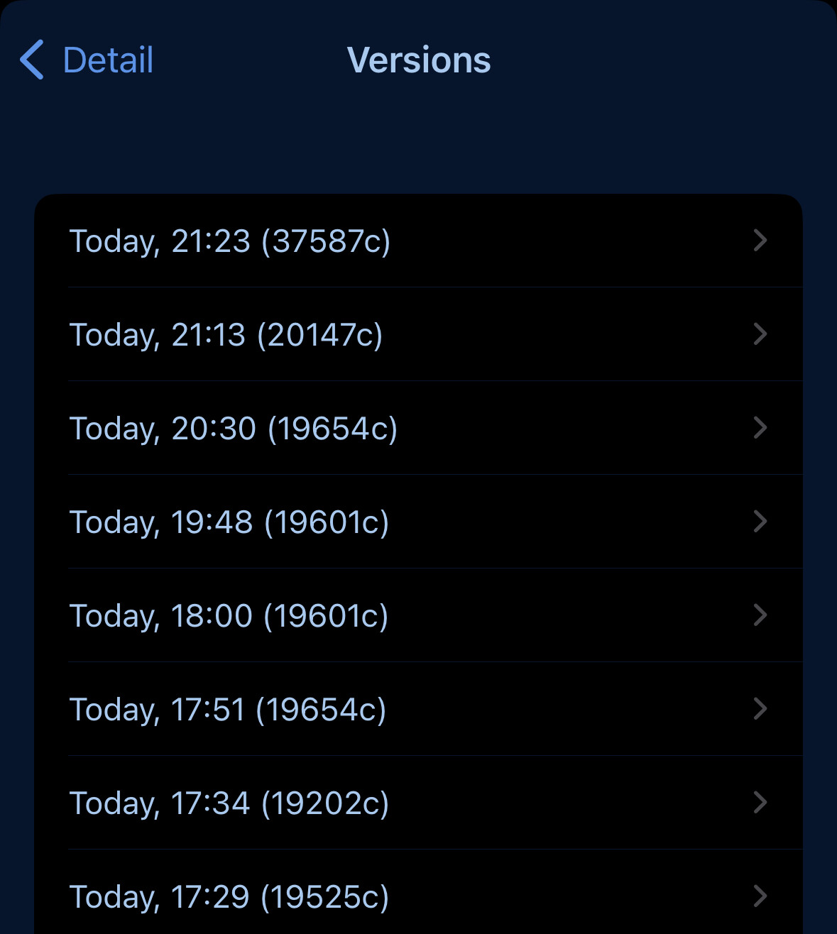

Could diffs be added to Versions, so I can see where content was lost, like it seems to have been twice today
(I don’t want to do any more log dumps and analysis – I know sync is as good as it can be on iCloud)
I haven’t done any deletes today (17:34 drop to 19202c), and I’ve pulled more than 300c of content out of versions that wasn’t in the latest, so the 19654c wasn’t just a late true-up
Diffs (with copy of deletions) would help make the occasional hiccups pretty easy to recover from
