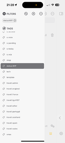

I have one tag I cannot delete or rename. When I try I get the message - “No drafts assigned the tag “status:WIP” were found. No changes were made.”
I have no drafts in the bin and would appreciate advice on removing this tag.

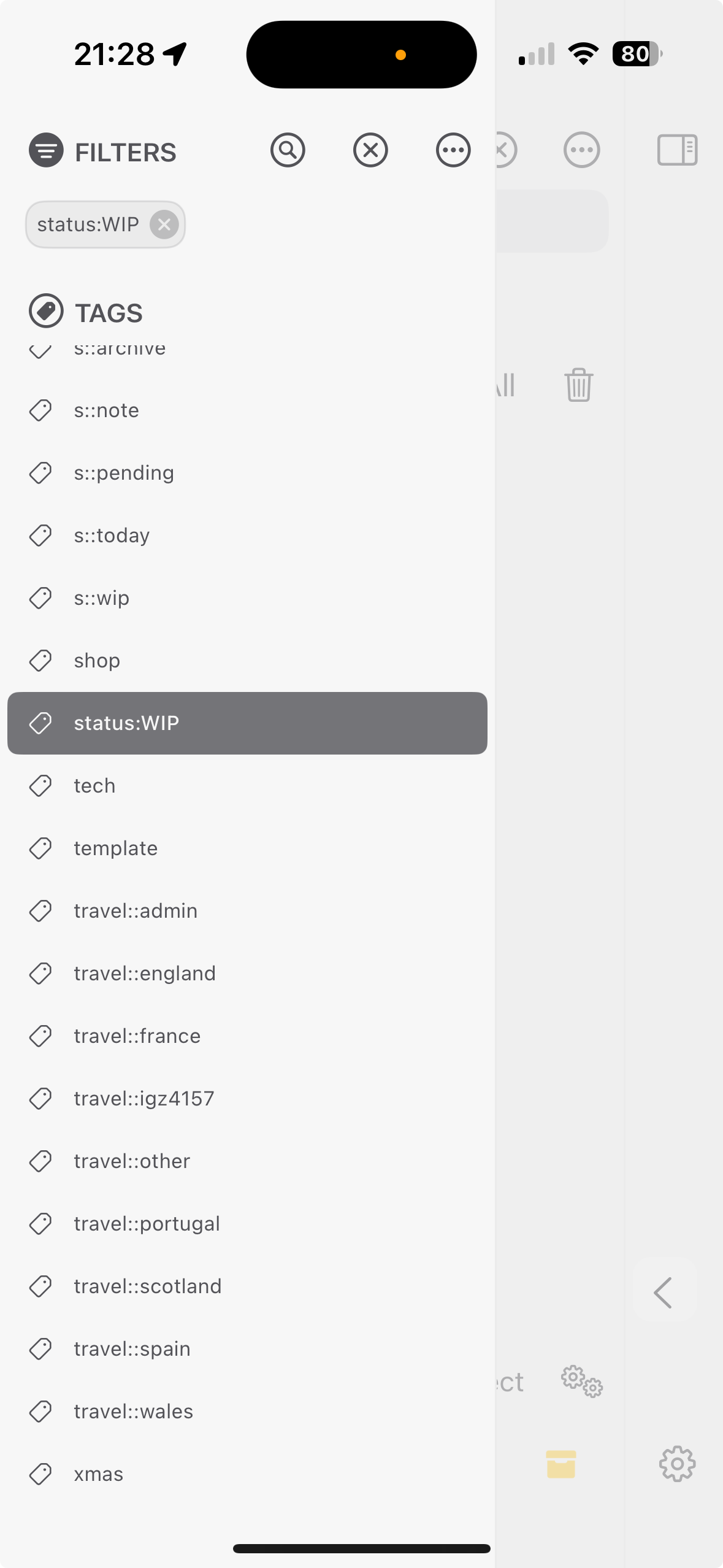

The screen shot shows the tag as status:WIP

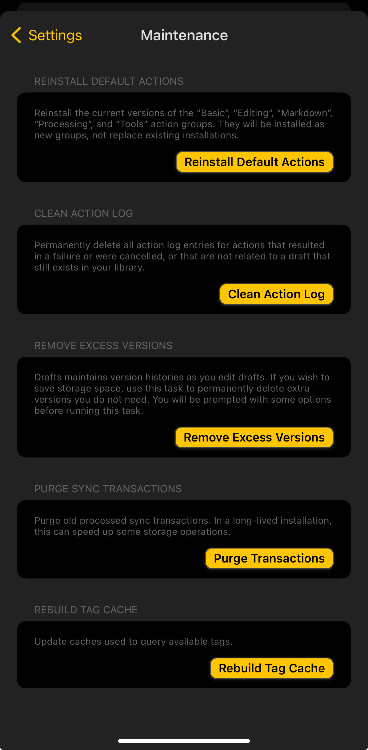

Try running the “Rebuild Tag Cache” maintenance operation in Settings > Maintenance. It should fix you up.
Rebuild Tag Cache worked, thank you.
No option “Rebuild Tag Cache” in Drafts Settings > Maintenance
