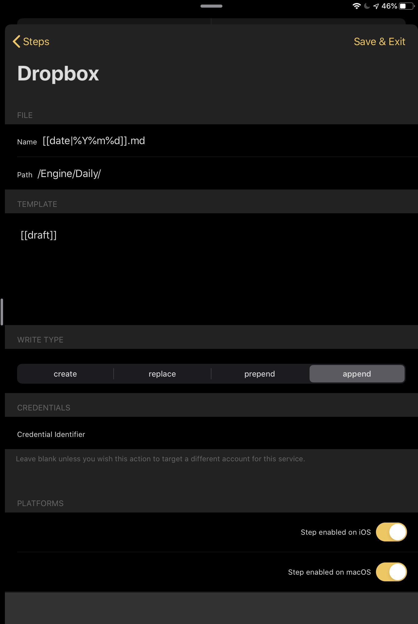

I would like an action that takes the draft, creates a new text file, in Dropbox or iCloud Drive, that is titled with today’s day, but if that file already exists, I want the draft contents to append to the existing file.

These do what you are asking for, except grouping by month, not day. To adjust these to write to journals that rollover by day, you would need to edit the template tag in the file name field of the action’s step. Instead of Journal-[[date|%Y-%m]].txt, you might want Journal-[[date|%Y-%m-%d]].txt. For details on modifying date format tags, take a look at the date section of the Using Templates article.

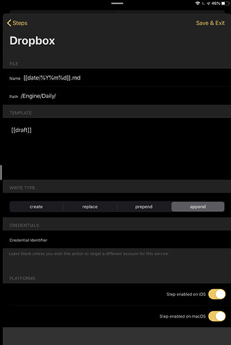

That’s what I did. Or tried to do. I posted the Dropbox action above your reply…because I can’t think of anything that is wrong with it but there might be some kind of technicality that I don’t know about.
That looks right…what happens when you run it?
It gives me an error notification and I feel bad.
Well, the first time I run it, it creates the file and everything seems to work well.
The second time i run it, to append something to the file that it created, it throws the error.
What version of Drafts? There was a Dropbox bug due to changes in their API that could cause that problem, but it is fixed in the current version of Drafts.
If you are up-to-date, what is the error detail in the action log?
I just realized that I’m off the beta and I guess the beta version was old. The App Store version seems to be working. Sorry. :skull_and_crossbones:
